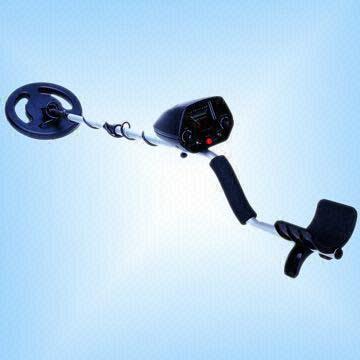

    Any one got a schematic for the Gold Century GC-1023. It has been sold worldwide as:
    Gold Century Metal Detector GC1023
    MD-1023
    Famous Trails Discovery Metal Detector
    Fortune Finder 1023 Metal Detector
    Treasure Cove Metal Detector TC-1023
    Gold Snoop (Australia)
    Gold Snoop Pro (Australia)
    Lafayette GC-1023 (Italy)
    Black Knight Pro (Germany)
    Magpie II (GC-1023) (Germany)
    Made in China.

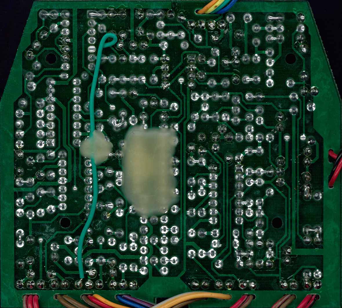

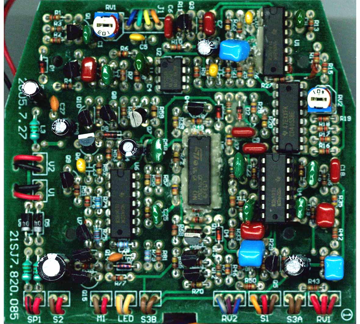

    GC-1023 pcb
    I have pictures of both sides of the pcb. Component side is numbered 21SJ7.820.085 & dated 2005.7.27
    Carl, as a new member, when am I able to attach the pictures as my posting rules are "You may not post attachments" & what is the size limit.
    Rufus
      pcb pictures
      2 pics:

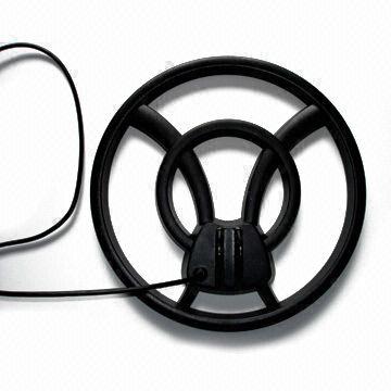

          NO SCHEMATIC YET !!!! BUT SINCE IT IS MADE IN CHINA , IT IS COPIED FROM SOMEONE ELSE !!!! WE KNOW ITS 5.0 to 6.5 KHZ. IT WILL DETECT A QUARTER AT 8 INCHES IN ALL METAL MODE. IC CHIP U-1 , U-2 AND U-6 ARE NOT VISIBLE . THESE MAY HELP ,IF YOU CAN SHOW US A BETTER PICTURE. U-3,U-4,U-5 ARE CLEAR. I ALSO POSTED THE 12 INCH COIL YOU CAN GET FOR IT TOO. WE JUST NEED A BETTER PHOTO . THEN WE MIGHT BE ABLE TO MODIFY THE CIRCUIT. TIME TO GET OUT YOUR OSCILLOSCOPE TOO . A GOOD OSCILLOSCOPE CAN ALWAYS ANSWER MANY QUESTIONS !!!IT MIGHT BE A COPY OF A FISHER??? I KNOW FOR A FACT THAT THE CHINESE ARE MANUFACTURING A COPY OF WHITES CLASSIC 3 AND ALSO 6000 PRO AND SHIPPING THEM AROUND THE WORLD. "REBUILDING OLD TECHNOLOGY FOR A BUCK" AND RE-SELLING FOR $$$$$$$$. HOPE THIS HELPED A LITTLE ...................EUGENE

            Parts Listing for GC-1023/MD-1023:
            IC:
            U1 = TL064CN
            U2 = LM393N
            U3 = CD4053BE
            U4 = TL064CN
            U5 = LM393N
            U6 = TL064CN

              Yes, they are the right components as listed above. I am trying to locate a similar circuit on this design but with no luck. Could be similar to bounty hunter tracker iv, but cannot locate circuit. One other thing that has crossed my mind is i think the Tx oscillator is built in the concentric coil. I may be wrong. Does anyone know the tx/rx colored wires in jumper J1 on the circuit board above (blue, green, yellow, orange)? Wanting to know the pin configurations that connect to the coil. Any help Please.....

                  The only drawback is the coil, it is a 8 inch concentric with the transmit coil being only 4 inch in diameter, thats why it has good selectivity and depth. If people are interested we can work out a better coil. I am designing a few coils at the moment exspecially for small gold.

                        i´ve the one with the standard coil. Pics of pcb are made. I will post one here the others i send to a file hoster so that everybody can download them in good quality. All components in smd- good made seems it was a little chinese with small fingers.
                        Inside the box are other pcb too. Some at the knobs and one on the coil connector seems they are made for easier wiring and saving space all is very flat mounted. I will post them later.
                        If anyone starts next days to redesign pcb- its not necessary to made it in smd too i think it were user friendlier and easier to rebuild it with standard size components.
                        The parts that are glued in hot glue are not so easy to analize but most tracks are visible- if not i can use a strong light from the back (laser or led) to make them clearer visible.

                            If someone has a faulty/damaged 8 inch coil for this unit please post a picture of the inside and your inductance measurements so we can compare and also improve coil design.
                            My measured inductance is TX 1.98mh and RX 8.88mh, could be wrong, checked with cheap meter. Will check again soon.
                            I believe the coil is concentric in design having TX inner, bucking coil outer and RX outer, sourced this info from some other site.
