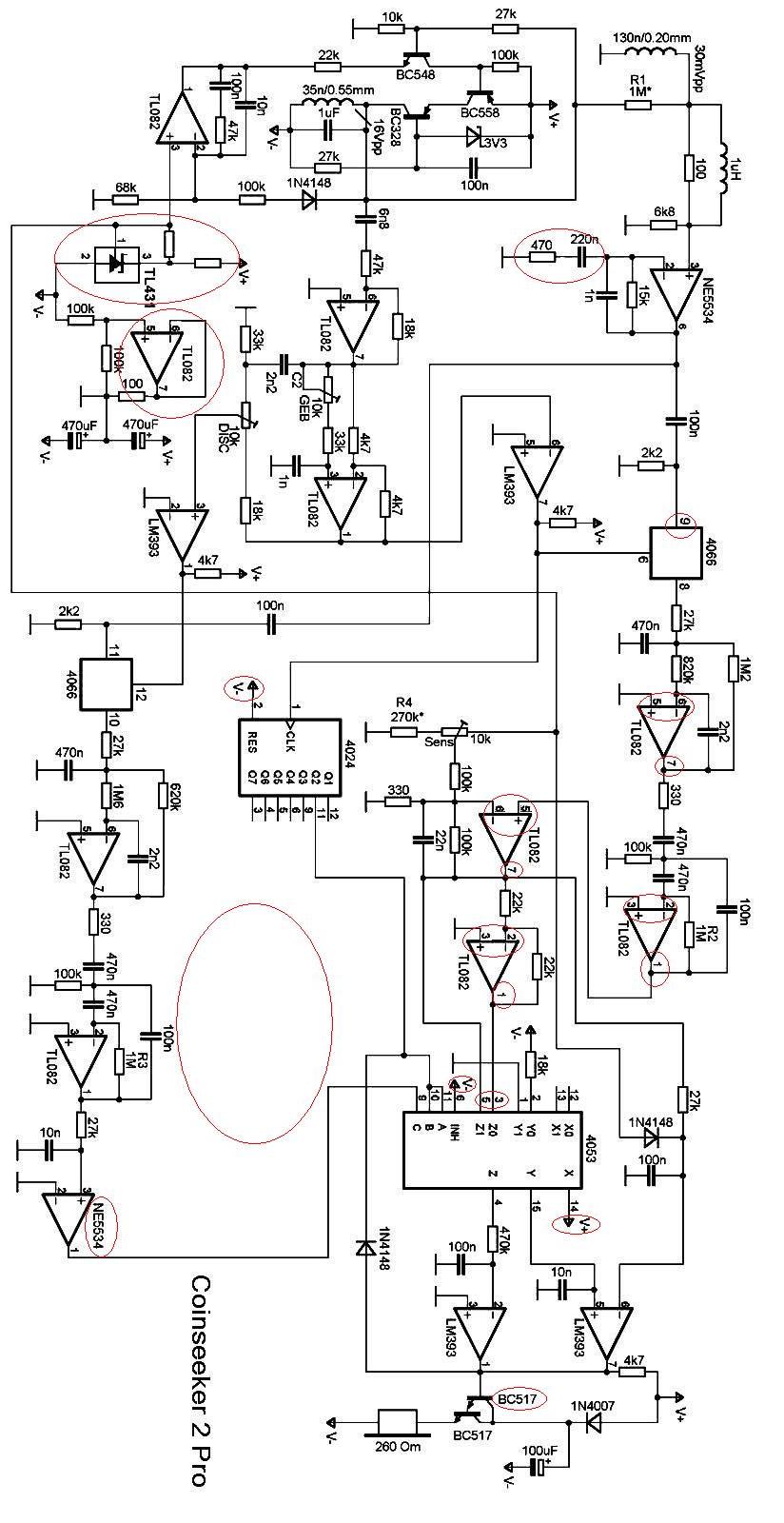

          A lot is similar with this schematic !!!!!
          Tell me I am dreaming , so now I will buy a GC-1023 as soon as I find one around here very cheap .
          Look at the IC chips used , many similarities on this schematic too . The GC'S TL 431 [U7] "2.5 v voltage reference" caught my attention . A solid design , but when using a cheap Chinese search coil it does not draw any attention !!! Understand what I mean now ?
          Best Regards............Eugene

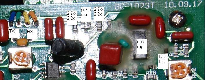

              Hi, very interesting Bernte, smd version, did not know existed. Compared both smd and feedthrough overlays, very similar if not same.
              Amtech, very similar but has a lot of differences. The LM393 chip seams to be more than one used in that circuit you present. Md/Gc1023 uses only one. The circuit you have also does not have Pre-amp transistor Q3.

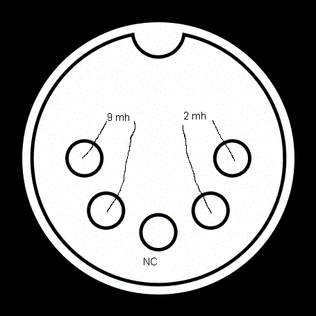

              The MD1023 Color codes for connection to coil connector inside detector on either board are as follows:
              TX- Blue/Green
              Rx- Yellow/Orange
              Lunamay, have you tried looking for any dry joints, maybe a idea is to re-solder as many component pins, taking more care not to over-heat any IC pins, diodes and transistors. If all is still no good disconnect coil and try to measure resistance and inductance at coil connector from the coil lead itself. You might have a faulty coil lead connector. You should have roughly these parameters:
              TX-2.0mh, Resistance-7ohms
              RX-9.0mh, Resistance-32ohms.
              Hope that helps.
              As for mods, see below picture, will be same for smd and feed through version from what i see from Bernte's SMD version.
              Please understand if you decide to mod your unit, you are doing it your own risk. I recommend doing one change at a time and see if there is a difference in sensitivity to even smaller targets like a small round ball of lead/solder. Dont re-adjust Rv1 until you see a difference in sensitivity or you get a unstable operation. Use metal film resistors if possible.
              Hint: Remove Rv1 and measure Rv1's resistance at each 3 points and note them down on paper so you can re-adjust back if need to so if you want to reverse mod if it does not work out good for you.
              I actually replaced Rv1 with a external ten-turn pot, made it easier to adjust, was not so critical for my detector. Remember every detector might be operating different in performance, so might have different results.
              This is only for preamp and op-amp mod. If you need to: re-adjust Rv1(All metal mode only), use care, adjust very slightly either left or right with a small ferrite core 5cm in front of coil for nil response or a bit of threshold sound breaking through, but still have greater sensitivity than before the mod. This will make sure Ground balance and when lowering coil to outside ground soils is at optimum and still remains with a quite threshold in use. Remember the detector is a motion type in all metal mode, so you will need to wave the ferrite left to right in front of coil. Pinpoint mode when in use is non-motion for your info.
              Regards Sido

                Thank-You 6.666 k for posting your information . My schematic is not an exact match , it is for reference . The Chinese cloned many different M.D.'S so the above schematic is just a starting point , maybe someone else can positively identify [like a detective] what manufacturer and model was cloned in the GC-1023 ? !! We have to start somewhere , if we do nothing then nothing will get done . It looks like a very professional circuit board not cheaply done like some of the Chinese Seben-7's !! So far I found a GC-1023 for $40. u.s. dollars , not bad if it is still available ?
                          [ATTACH]15809[/ATTACH]
                          Regards Sido

                              yesterday ich checked my GC 1023 20cm coil
                              it seems to be different to the one above which has 2mH and 9mH
                              my coil specs are:
                              1,93mH 7R
                              2,65mH 15R
                              the coil inductance difference seems to be like the older tesoros
                              i think the measurement is not 100% correct -the pins were hard to get
                              but a difference of 0,7mH seems to work maybe also less? 0,5 or 0,6
                              i will try it with diy coil dd shape coil with 28cm diameter
                              report follows
                                Hi Bernte, i did the measurement again. I am using a cheap handheld multimeter with Inductance measurement. Could be giving me wrong reading, i hope so as the values you have a very close to Bounty hunter coils.
                                What Inductance measurement equipment are you using?
                                I live in Melbourne, Australia and the only problem i have using this detector at full sensitivity is at the beach on wet sand only. I have to turn the sensitivity down to half way to use it on wet sand.
                                As most people know here in Melbourne/Victoria we have one of the worse mineralised goldfield soils in the world that i have been using the detector with no falsing.
                                Below is the pins diagram i took measurements from.
