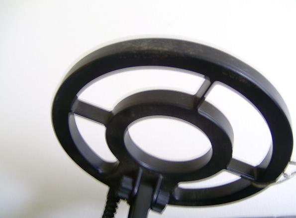

        Originally posted by sido View Post
        If only we can see a internal picture of the original coil of what it looks like inside the housing, we can then have a idea of the set up used. I know its concentricin design with the bucking coil on the outside winding and TX and RX winding on the inside.
        That is incorrect. It will be either TX on the outside, and RX + nulling coil on the inside (most likely configuration) or TX + nulling on the outside, and RX on the inside.
          Coil from Sido's posted photo is good coil.
          I had 3 of those.
          SMW is working splendid with it.
          It is Chinese copy of Fisher's coil, no doubts in that.
          Coil is pretty good quality made.
          TX is outside (larger one) and RX is inside. Feedback is part of TX coil and applied around smaller RX coil.

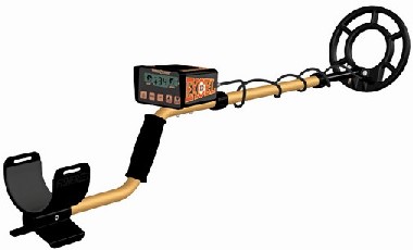

            hello
            yesterday ich checked my GC 1023 20cm coil
            it seems to be different to the one above which has 2mH and 9mH
            my coil specs are:
            1,93mH 7R
            2,65mH 15R
            the coil inductance difference seems to be like the older tesoros
            i think the measurement is not 100% correct -the pins were hard to get
            but a difference of 0,7mH seems to work maybe also less? 0,5 or 0,6
            i will try it with diy coil dd shape coil with 28cm diameter
            report follows
            Yes, there are 2 different coils that looks like that. One with exactly the same specs as Fisher's coil and another with specs you just noted.
            I think you don't have luck, because your coil is the worse one...
            I had 3 coils with specs like Fisher's and one with specs like your coil.
            Those 3 i had can be used with Fisher's and SMW so i used them with my diy SMW's ... while coil with specs like yours turned pretty useless to me...
            GC1023 is pretty unstable and useless for my account, but it is having indeed high quality enclosure and splendid shaft so as pretty nice coil.
            So i used all 3 GC's with my SMW pcb instead original one!
            If GC can be bought cheaply - than it is worth to be bought and "updated" with better machine... like mentioned SMW...
            I payed mine 120e each. Which is indeed bargain, considering splendid shaft (usually 50e least), very nice, robust and high quality detector enclosure (20-30e such ones) and indeed nice, usable and good quality made coil (similar quality and specs can cost over 100e).. so at the end GC is worth to be bought and modified.
            Funny... seems few Chinese manufacturers shared the same production line for such enclosures...
              Proof that it is actually Fisher's coil enclosure design copy:
              Also coil specs are pretty close to Fisher's coils specs, almost identical.
              That GC coil will perfectly match Fisher 1265,1266,1236, CZ6 and few others.
                Just checked...!?
                Damn Chinese! It is not the same "GC" i am talking about!
                This crap here:
                Is not the one i talked about!
                That's why probably coils do have different specs!
                I referred all my approvals to this one:
                  That's why we often do get confused, because they do name those detectors on the fly, each one can have dozen names! ()
                  I met GC1030 as MD3030, "Griffon", "Black Rider" , GC this, GC that.... Damn!
                  The other one also can be met as GC1023, MD3023, "Black Kinght", "Centurione" ...blah..blah..blah..
                  While the real truth is that all those crappy Chinese products are actually based on just 2-3 different schematics, some of those made to work so so and majority are indeed useless.
                  Only exception can be mentioned MD3030 (Griffon) at wich at least: shaft, coil and detector enclosure are made very good and can be used as "material" to make much better hand made.
                  Others... CRAP!
