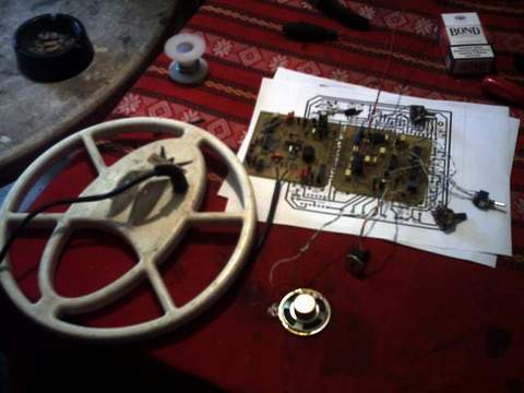

        Back to 1265...well, considering all we talked about here finally i can suspect only pcb or some broken component... transformer is ok, quratz is ok, coil is ok, schematic seem to be ok...pfffff!
        These days i will have to sit and recheck all over again from the very start.

            • Few other jobs finished so i am back on track again here. 1265 copy i made is still on the bench and waiting. By strange coincidence today i got original 1265 in descent shape. Only one thing miss - coil. Actually with this one came 8" White's (3900) coil!!! Ha,ha,ha! And it is working, but not that good as with original. Now i have almost perfect conditions to recheck all over again, to compare, measure...my 1265 copy simply MUST start to work good in next few days. PCB's were checked many times, there are no mistakes on those. Neither one mistake. So people who's interested in making copy of 1265 can freely use those pcb's...no mistakes at all.
              First will recheck and compare original transformer and the one i used...than use scope and measure some signals and later check wirements on front panel...
              If discover something wrong i will report here..

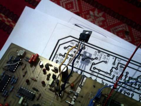

                      • Ok..one more tip;
                        instead VP0104N3 and simillars i used ordinary IRF9622! Wow! I get perfect 8.0 volts now with it and all the things came to proper places!
                        Than applied Mikes corrections - even better! My 1265 copy started to work exactly as original. I can't get only proper phase by now, not yet, simply cose i used inproper coil. I dont have proper coil so i used Quicksilver (CZ5&7) 28cm coil just for testing purposes. But comparing to past situation and now, i see huge differences and huge improvements. Audio is extra loud (due proper 8v) and Sensitivity, Disc and other presets are working now nice and linear!
                        Everything simply came on its places! Simply as that!
                        Ha! I never payed attention on those 27M9 inputs!
                        Huge schematic mistake! Mikes i own you!

                            • Problems! Problems! Problems!
                              Just few hours ago i took original 1265 coil (8") from my friend to try it with my handmade. Very bad behavior! In Disc mode i got bedlam of cracks and beeps! In Static mode it is calm and working but sensitivity is very low....iron pliers bairly at 10cm in air! And also in Static mode it can not see coloured metals at all! I tried everything! Switched coil pins, switched transformer pins, rechecked everything - no result! Frequency is 4.7xx kHz.
                              With previous CZ5 28cm coil i got so so behavior, but out of phase....with this one, original...worse behavior much!?
                              Maybe some ic busted in between? Maybe more mistakes on schematic?
                              I am giving up of this one! To much wasted time for nothing....
