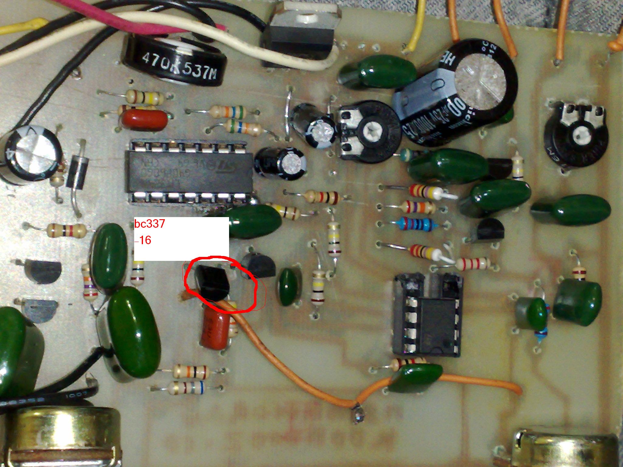

  • Well, my friend Sorry I am Arabic translation of Google
    Transistor see in the picture
    bc337 -16?
    or 337 Only
    I have to problem in coil
    awg Copper what is 0.30 Do you mean 0.3mm?
    Thanks for the answer
    • Hi,
      Yes, details can get lost in translation. Sorry. According to the link below, the transistor is a BC337. This is what I used.
      You can find the complete parts list here:
      Wire size is .3mm for building coils
      It does work if made correctly. I built 2 of them. You must read all the posts as there were errors in the earlier schematic.

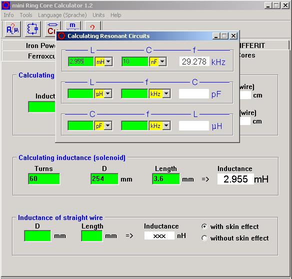

                          • Taros-coil and frequency.
