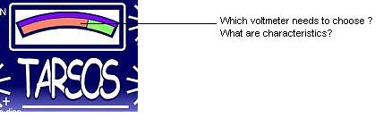

            Hello,
            Is it possible to post the pcb in "jpeg" or "gif" format ? because i don't have sprint layout ?
            Which kind of voltmeter have to use ?
            Thanks.
            Best regards.

                  Question
                  Hi Tarsos
                  Can you tell me wich model of voltmeter do you use ?
                  Greg

                          hii greg59 and all friends
                          emekli amca use voltmeter old radio-casette player vu meter .
                          and emekli amca yesterday did auto tune this video link http://video.google.com/videoplay?do...42071769749326
                          tanks.best regads
