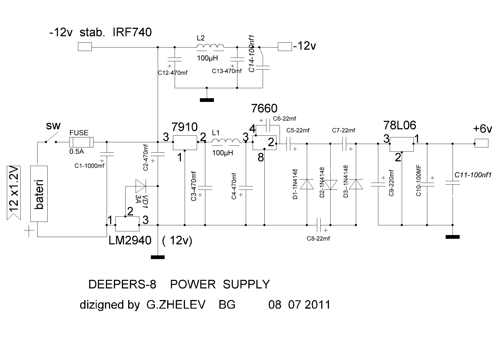

    Georgi can you give here more clear pic of power supply? I am wandering about C1/14? Is it 10uF? What is it's orientation on pcb? Kind a uncommon way to wire up 7660? Is it wired as voltage doubler? There is certain disparity between your PS hand draw schematic and pcb... or i just can not see clear pin numbers on 7660!?

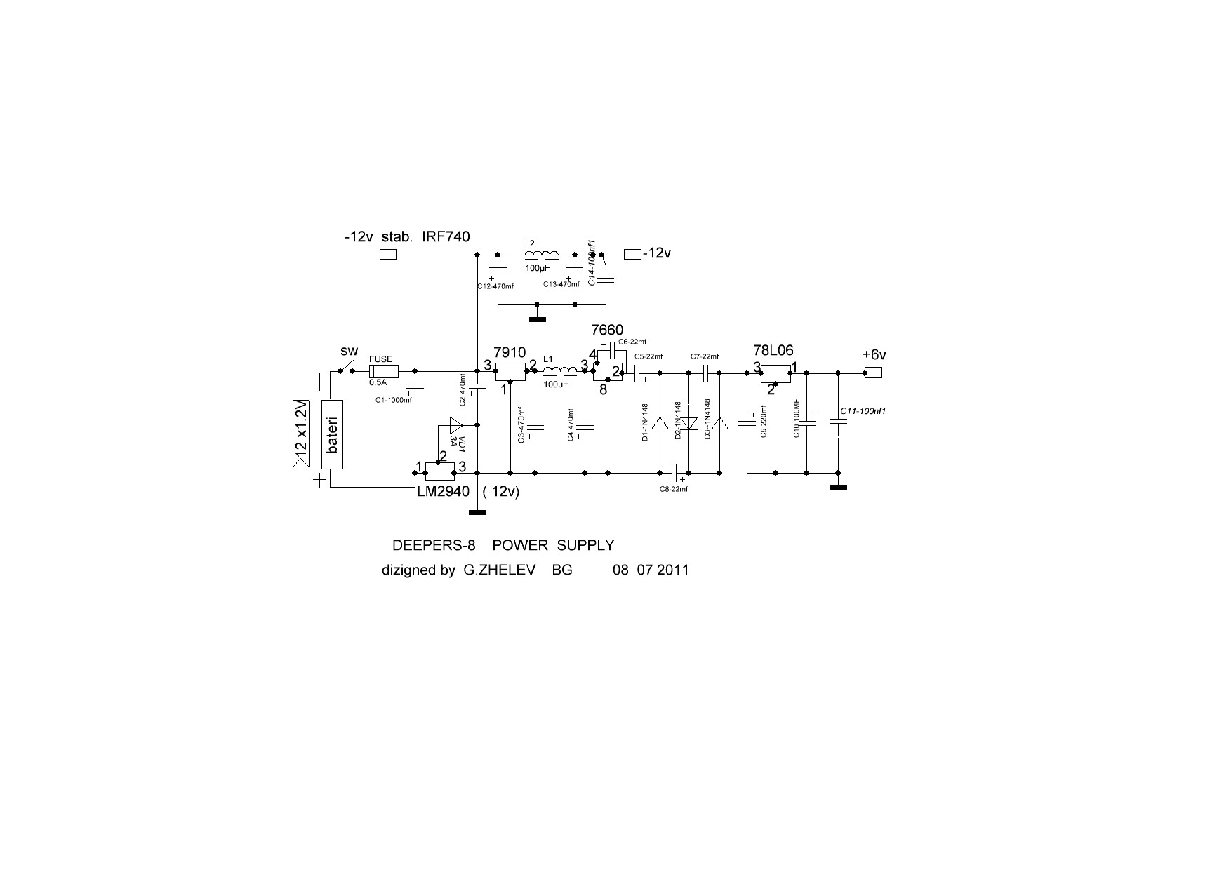

        Hi, Ivconic, sorry for the delay. I tried to draw a scheme to supply DEEPERS-8, this happens:
        • #79
          DEEPERS-8 P.S.
          50% Size:

              DEEPERS 8 P.SUPPLY
              DEEPERS 8 P.SUPPLY NOTE: LM2940 pin 2 connection pin3 LM2910!! Sorry for the mistake.
                Don't worry; mistake is my middle name!

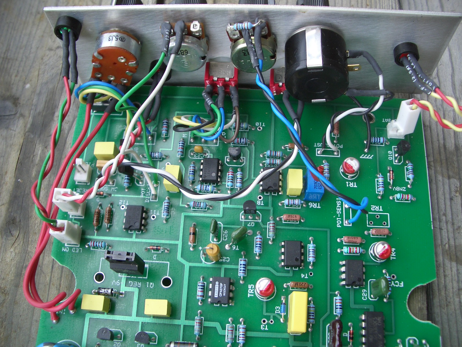

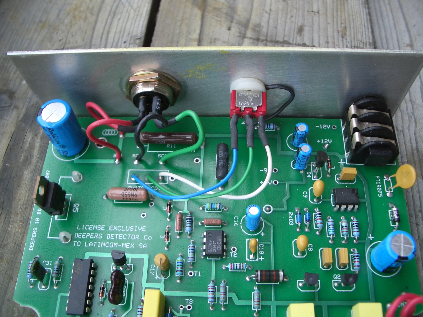

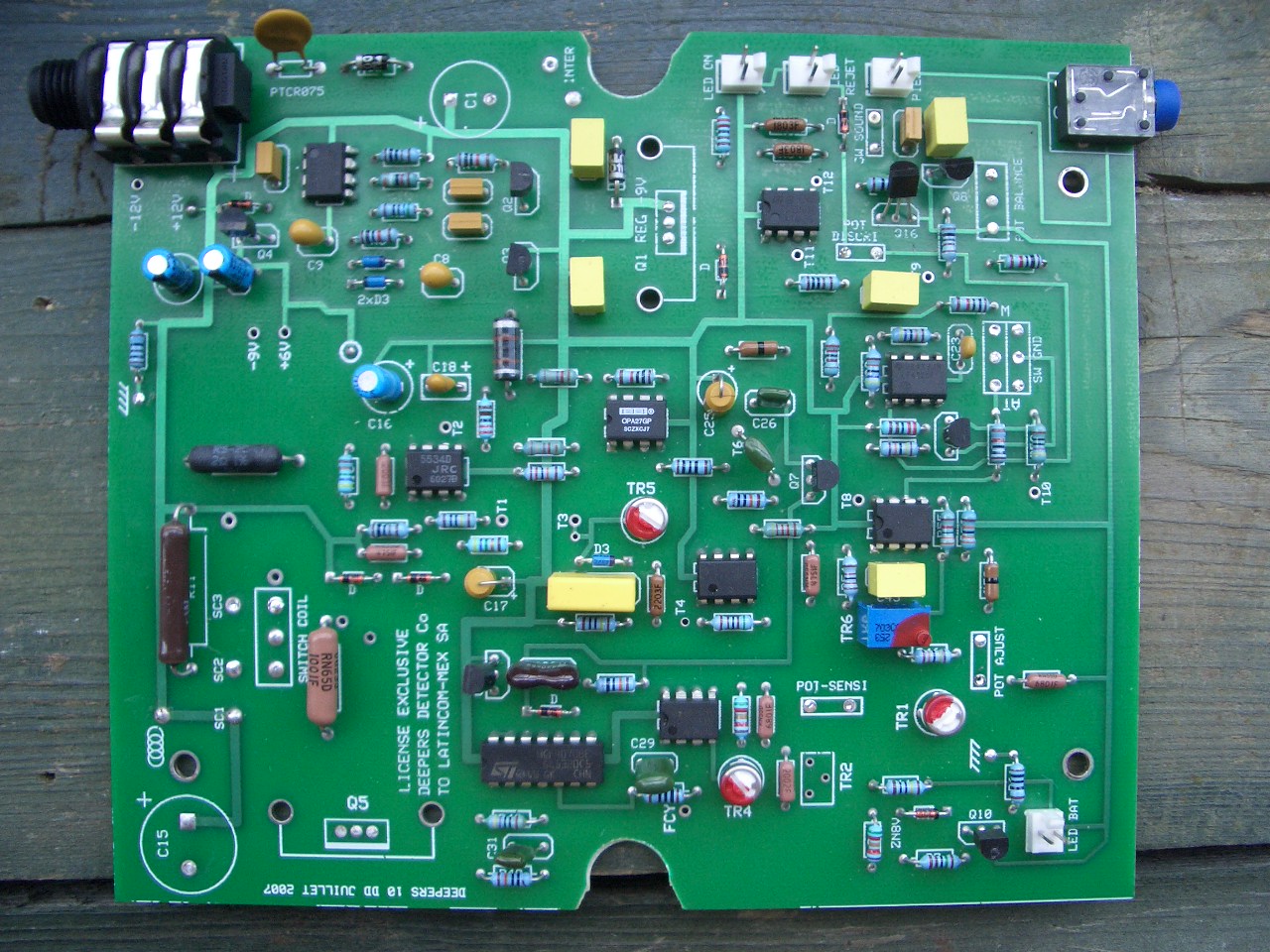

                  hi all,
                  can anybody share a photo of Deepers 8 inside? got Deepers 10DD in repair and would like to compare. The PCB of 10DD looks very similar to the schematic in the thread.

                      hi all,
                      give my regards to your wife
                      Hi kt315. Did you repair Deepers 10DD? What is the impression left on you - how it works Deepers 10DD?
                      • #86
                        I am interested in how discrimination. If you have a device, it is possible to compare the scheme with the PCB. I think that there are errors in the scheme. And so, all the paint and make a new, proven design. Thank you, Anatoly!

                          in a process... will tell you as speedy as I will fix it.
