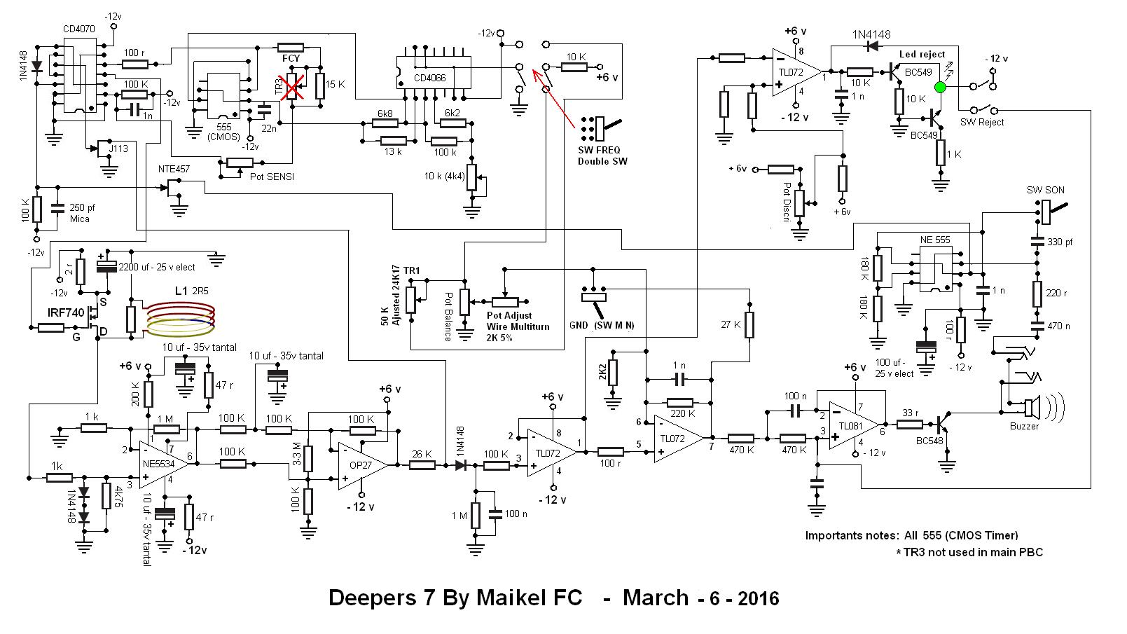

ID:	349244I have Deepers Schematics reversed by myself
    This is Deepers 7 Sch but not complette yet.

      • part list on DEEPERS 10DD
        • This list is incomplete, dont have Potentiometers, tr6 value too, dont exist.
          • tr6 does not exist.
            • KT315, Thank you very much!
              • MFC, The photographs show that tr6 has a face value of 25k
                • No, no , no
                  tr6 exist, and is in my schematics, this is regulation for automatic mode (TL081),
                  nevertheless The potentiometers, what their values?????????????
                  Pot Sensi, Discri, Balance, Adjust ??????????
                  • Hi, I regard you explain, it is possible, but sometimes some components have numbers that not correspond to their values and meaning some factory details. I need the exact information because we are speaking of share true information to the forum members.
                    • Unfortunately, there are indeed mismatches of values. I did not hold it in my hands, so I do not know the exact values of potentiometers. TR6 is the balancing TL081.
                      MFC you have a drawn Deepers 10DD scheme?
                      • Hi LDTVN
                        Yes I draw the both schematics , Deepers 7 and Deeers 10DD, but unafortunally they are not complete yet, I will comlete soon the Deep7 to post full here, but I dont have the potentiometers and other values for 10DD scheme.
                        • Hi, MFC
                          Can show your scheme Deepers 10DD?
