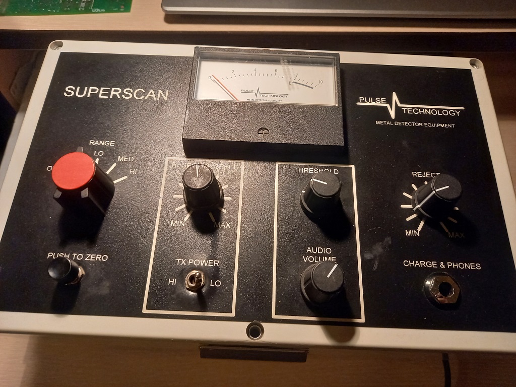

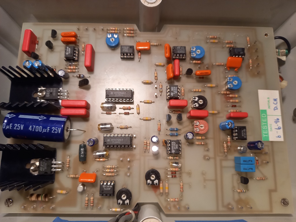

    • I have one of these rare Superscans with me right now. What I'm more interested in is not the board but the coil options.
      I have one square 1x1 cable for mono operation, now I know these had large 10x10 meter cable for TX and RX was a small coil. The parameters of these I can only guess.
      Perhaps the RX coil had 400-600uH 15-30 ohms with or without a damping resistor inside. TX coil could be /maybe/ 2-3 turns of 0.50mm - 0.75 wire with other shielding perhaps some damping resistor too.
      I'm rather busy but If I have time with need to test this but I think those Superscans with the TX/RX arrangement could work with a normal DD coil /Minelab for example/

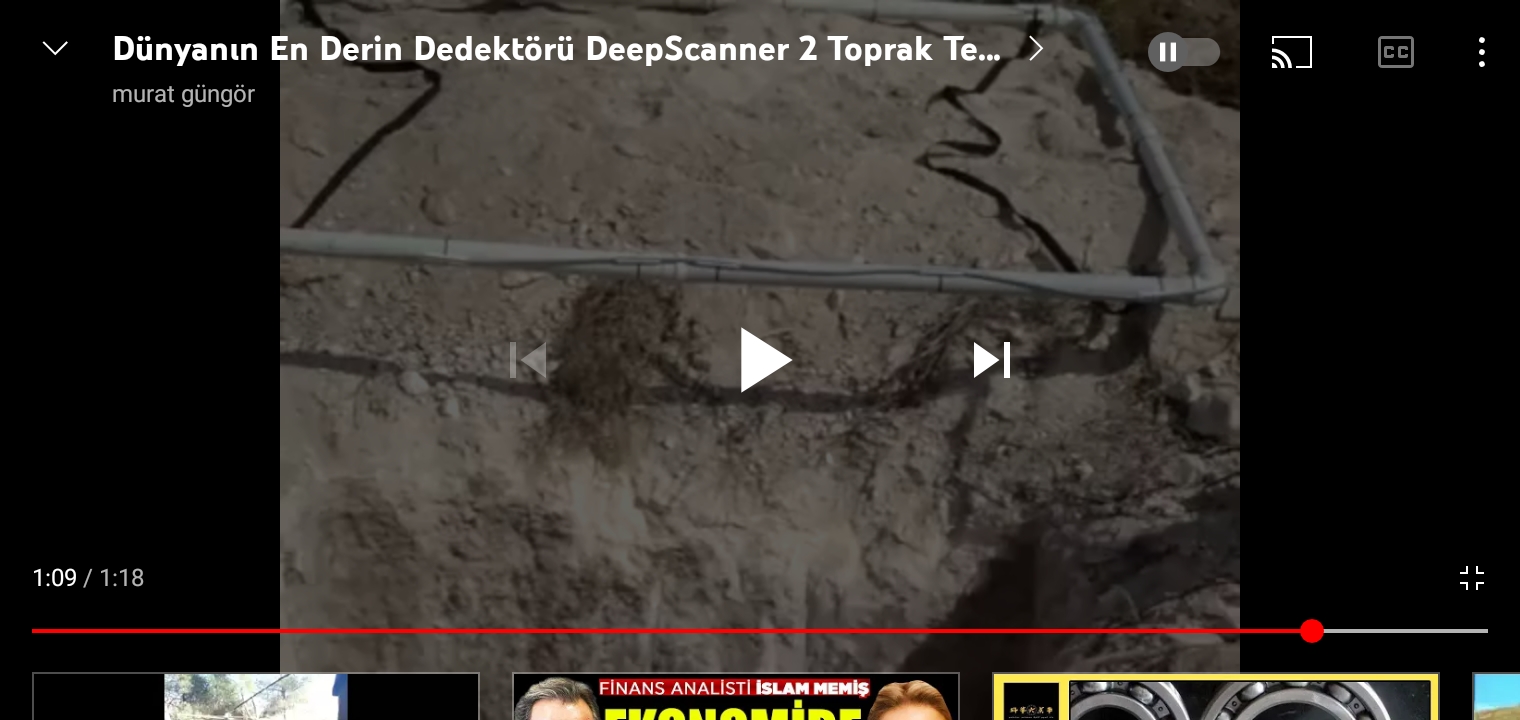

                            • https://youtu.be/C6ImQPH2zUMClick image for larger version
                              The video shows that the coil is unlikely to reach 2mm
