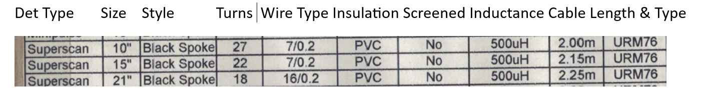

      • ​Hello ZOUjiarui & Co,
        Think you may find this information useful if you have based your PCB on the original SuperScan.
        Click image for larger version  Name:	SuperScan Search Coil Info.png Views:	0 Size:	249.6 KB ID:	452870
        SuperScan_Schematic.pdf
        SuperScan_PCB _Set_Up.pdf
        regards,
        Chris.
