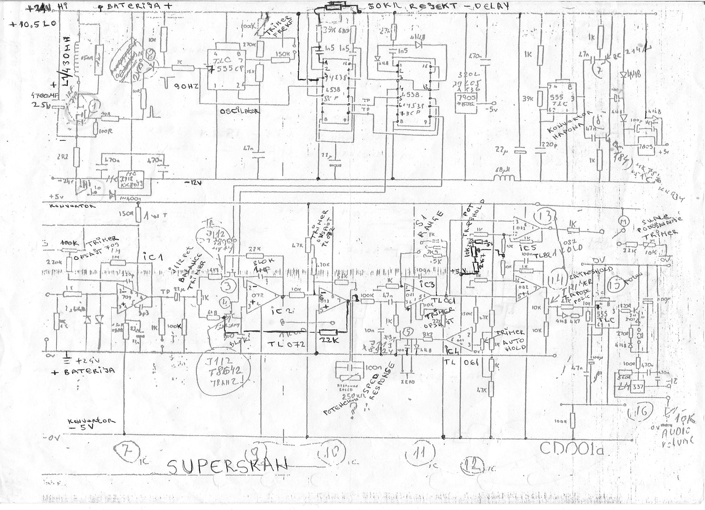

            Hi, anybody made this mashine?
            Because the shematic is not clear or anybody have clear shematic please?

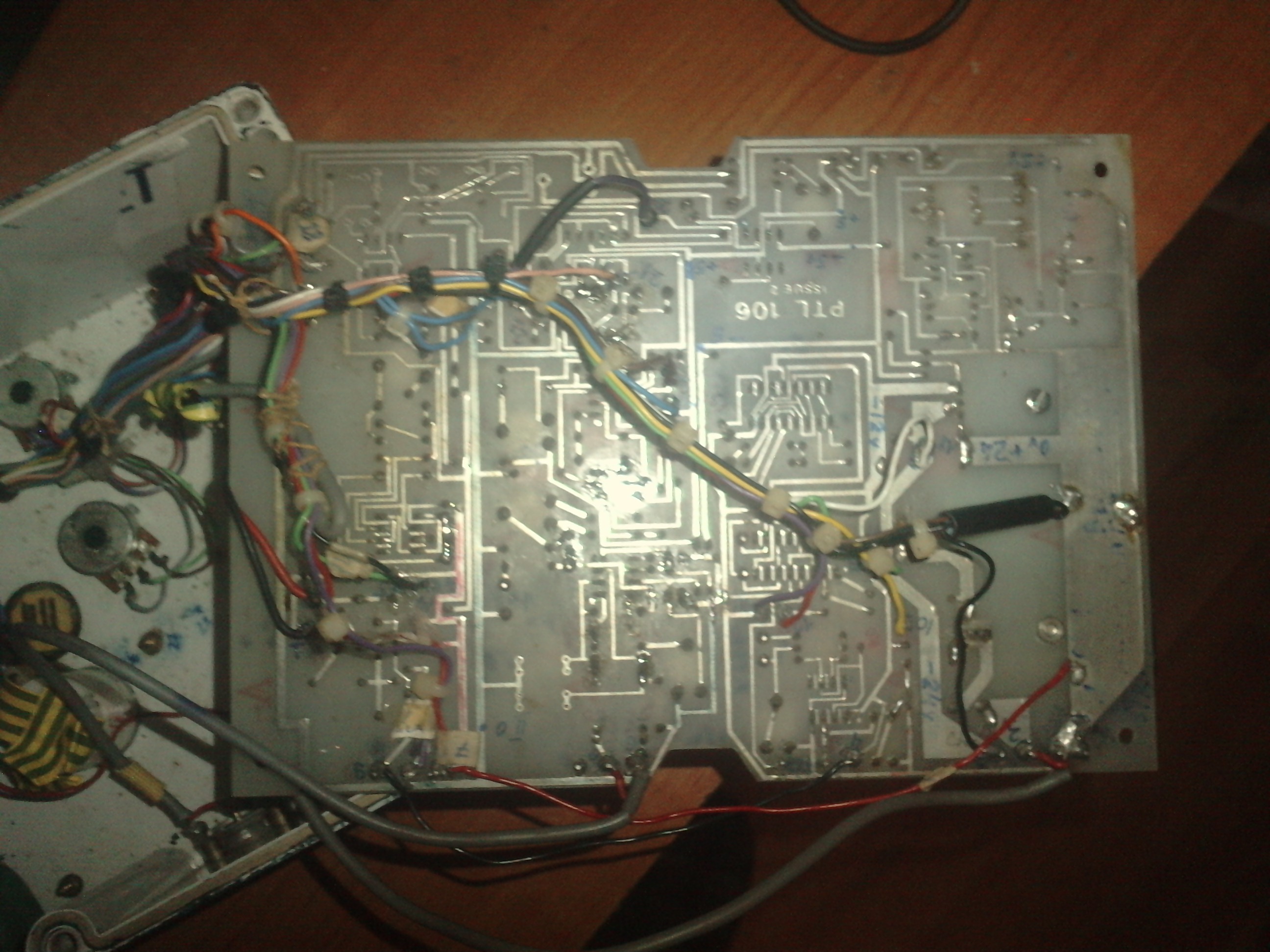

              And i have pcb picture the superscan
              • #67
                Hi, thanks my friens for your quick answer,ye maybe delta is more deep but maybe superscan is very fast detect i dont now, please post picture of superscan pcb.Thanks

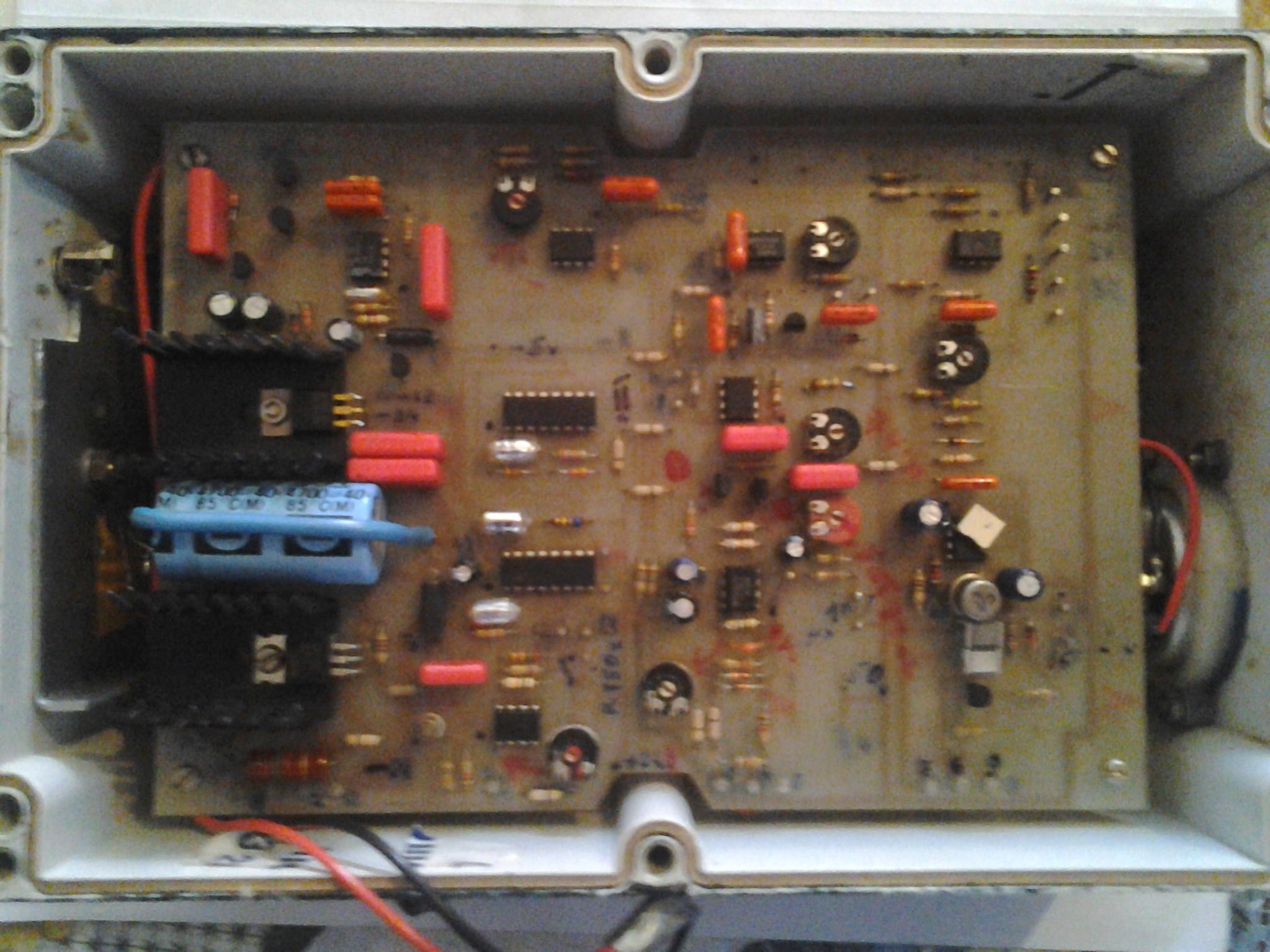

                  Also photos of the PCB Superscan.
                  thanks
                  • #69
                    superskan
                    superskan jpg
                    • #70
                      Hi, anybody have a shematic diagram? Thanks
                      • #71
                        schematic
                        correctly schematic !Superskan !!!!
                        • #72
                          thanks my friend

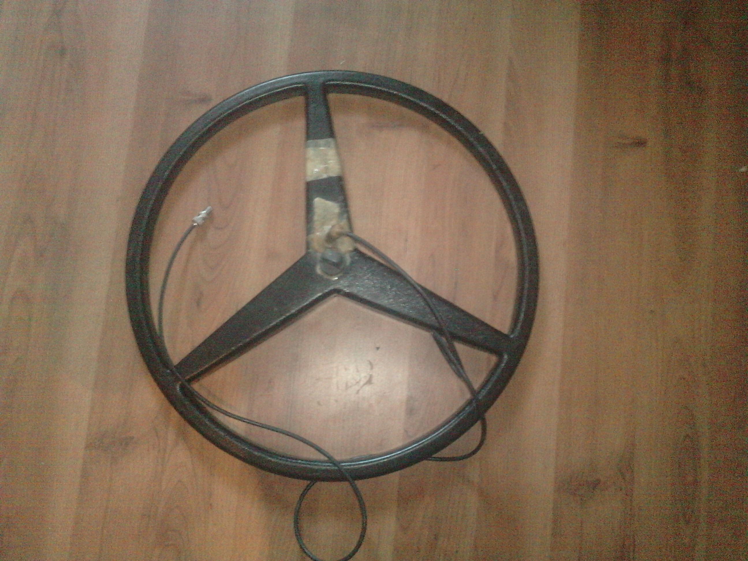

                              Diameter of the wire used in the coil 45cm Ø Can you tell how many tour ? !
                              • #75
                                Superscan for me is one of the deepest metal detectors if you know how to adjust trimmers inside it.For 45 cm coil use 0.8 mm wire and 19 turns.
