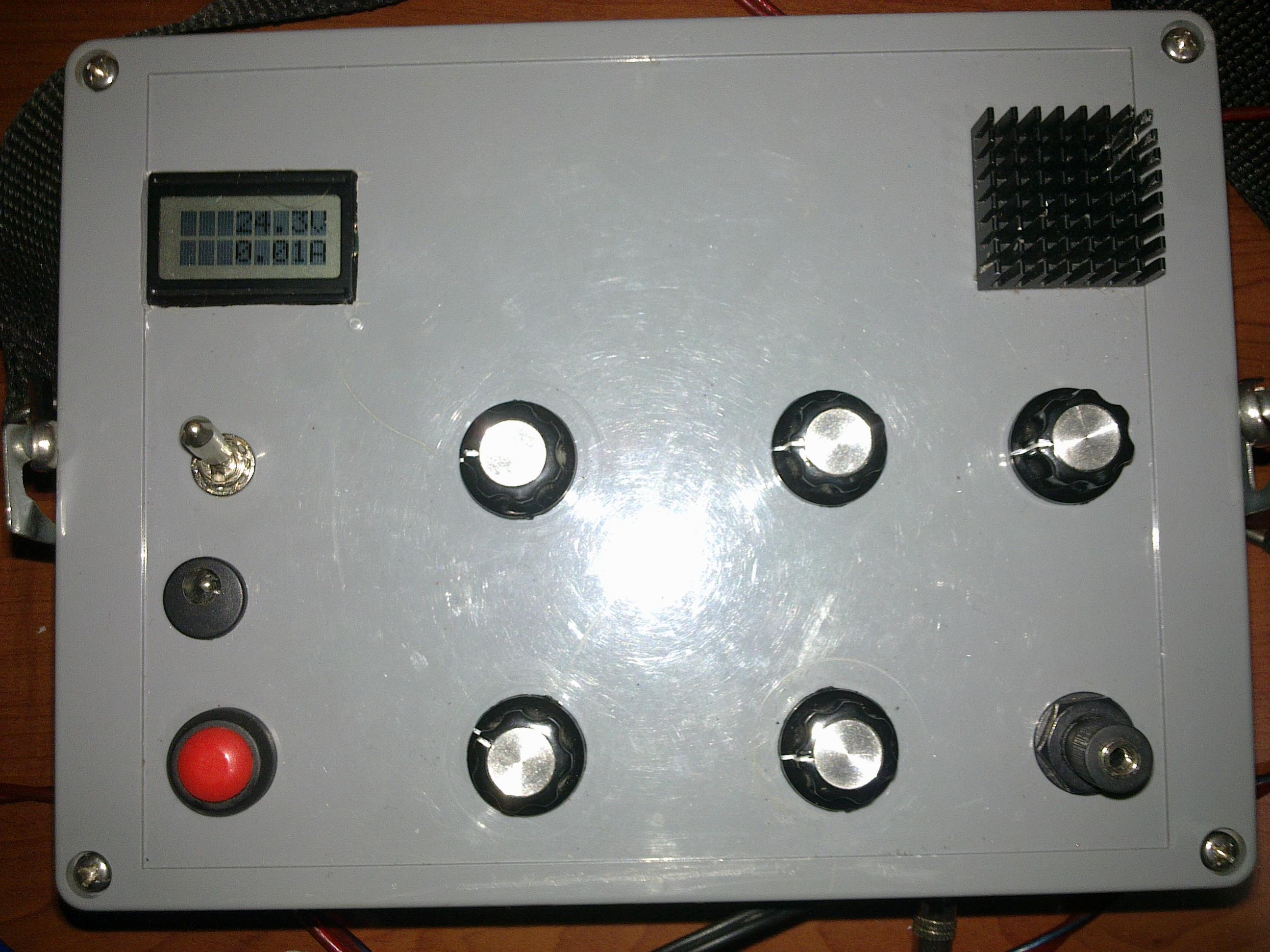

            SS5
            It is mine SS5 LCD
