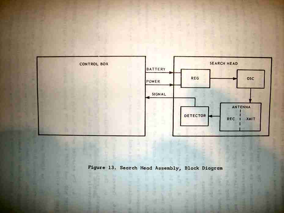

    Here you go:
    Continues...

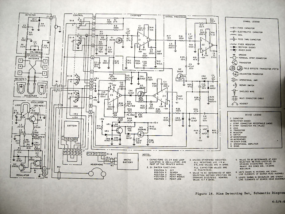

      Last part , hope you liked it :
        Hi Fred
        Thank you , it is interesting, assume designed for
        Plastic or non metallic mine.
        Can you upload high resolution circuit?
        Or send me it?
        Best regards.

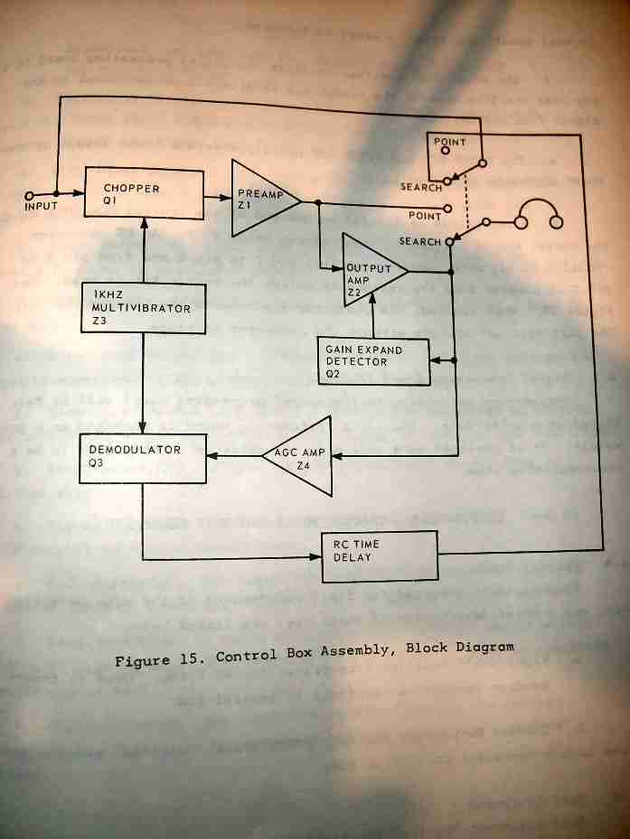

            sure it must work... it's a military equipment of uncle Sam....
            The problem is that's old, Vietnam era design... and it's a mine detector... so the question is "how well it performs on real search field"?
            And also... you can ask about performance on coin sized stuff... this thing is for low content metal mines but doesn't automatically means it's good e.g. for small stuff like coins, I dubt it is really.
            I never see one on the field... but reminds me much the old AN/PSS11... similar schematic symbols etc... of course, pss11 was pure vlf-IB ...this seems quite different and oriented to higher frequency.
            Would be interensting having some depth chart for it.
            The 1Khz stuff is just for chopper operations so means about nothing... operating frequency must be well higher.
            I guess, cause of that, it will suffer much of false signals... due to e.g. small voids in soil or changes in mineralization.
            Now... personally I don't think it was such a success... production of them was just fraction of an/pss11.
            AN/pss12 is shiebel pulse induction tx/rx md, the one currently used in middle east.
            I think the most interesting stuff in these is the new one... AN/PSS14...
            hybrid design... MD+GPR
            Kind regards,
            Max

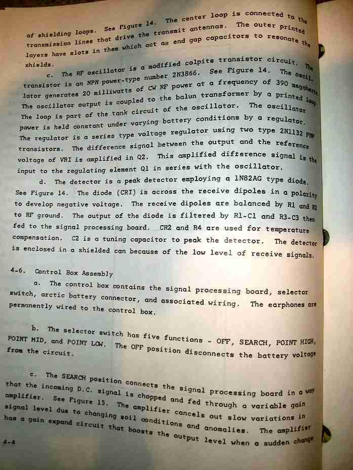

              I think frequency is above 200mhz.I will confirm later.
              Maybe this device was not well known because to detect non-metallic objects is not so common.
              I mean, except in casinos, i don´t want to search for plasctic coins
              Of course i also detects metallic objects, but there is probably better ways to do it.It could be used to detects small cavities.For example Carl´s challenge: it could find the void aroud the coins
                Frequency is 390Mhz, it´s on page 4-4

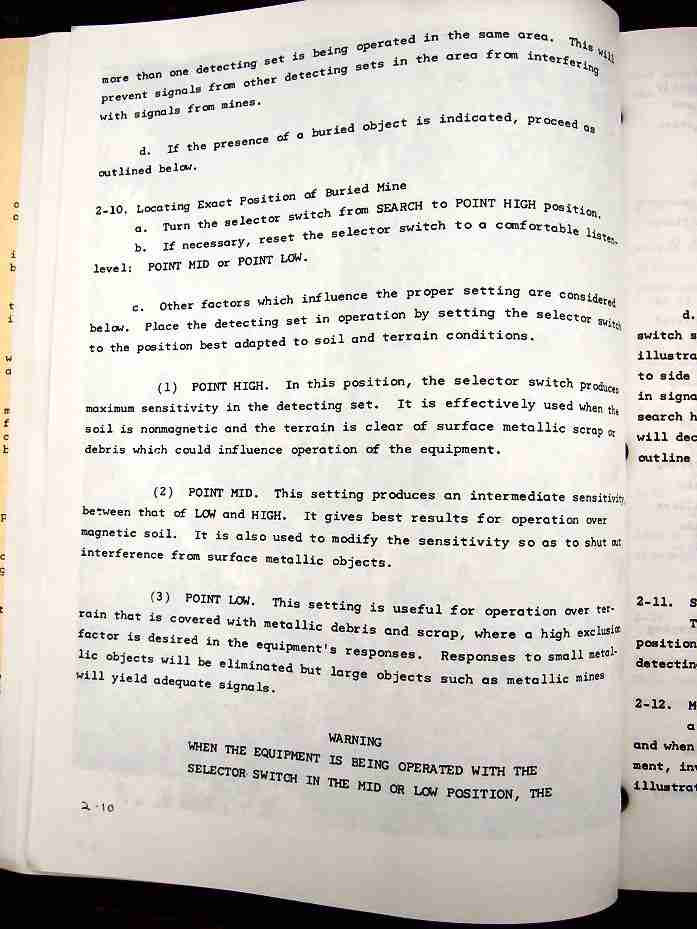

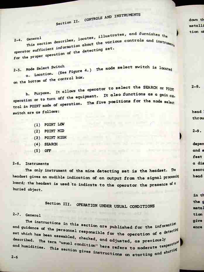

                Here more about how t use it, and a better schmatic for Aft :
                    Hi Fred
                    Circuit resolution better now .thank you

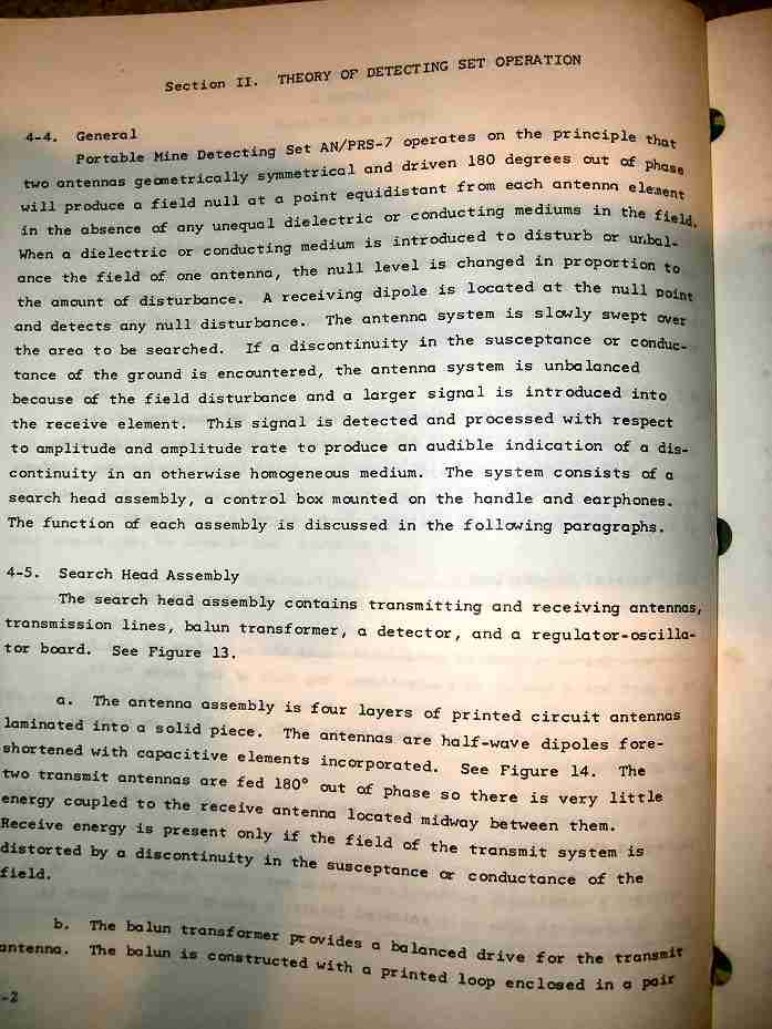

                      Its real claim to fame was detecting voids. The principal was changes in the dielectric inside the shallow coil range which wasn't much. I tend to think this was due to the high frequency of operation.
                      It was developed to counter the wooden box mines so popular in the former Com-Bloc countries.

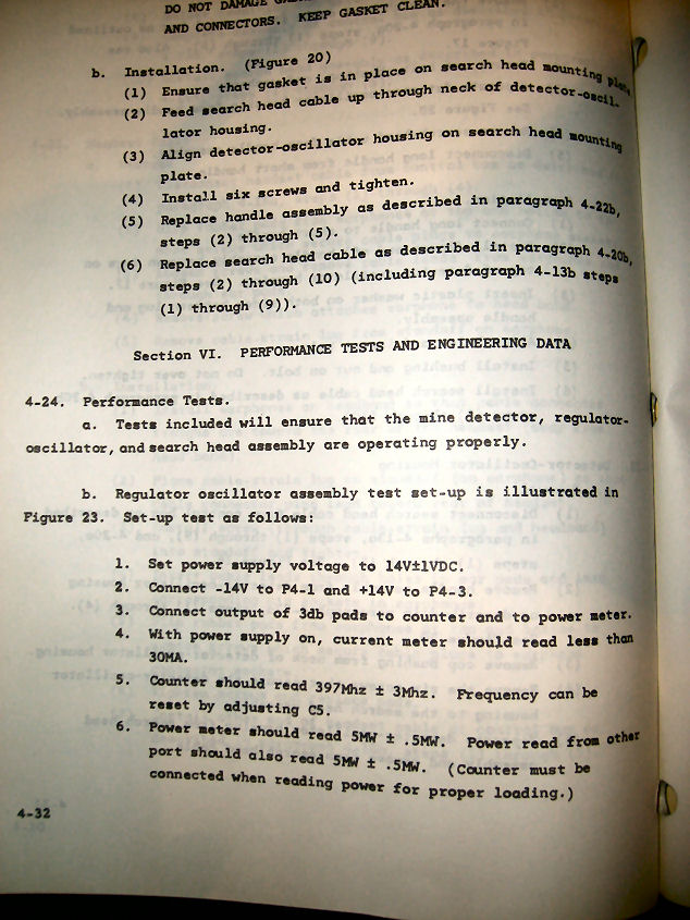

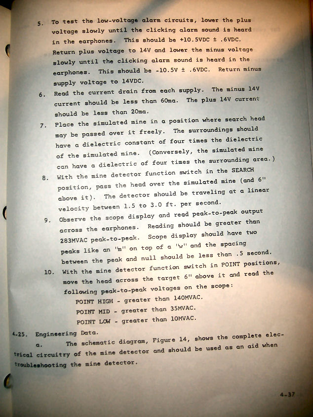

                          Hey Fred:

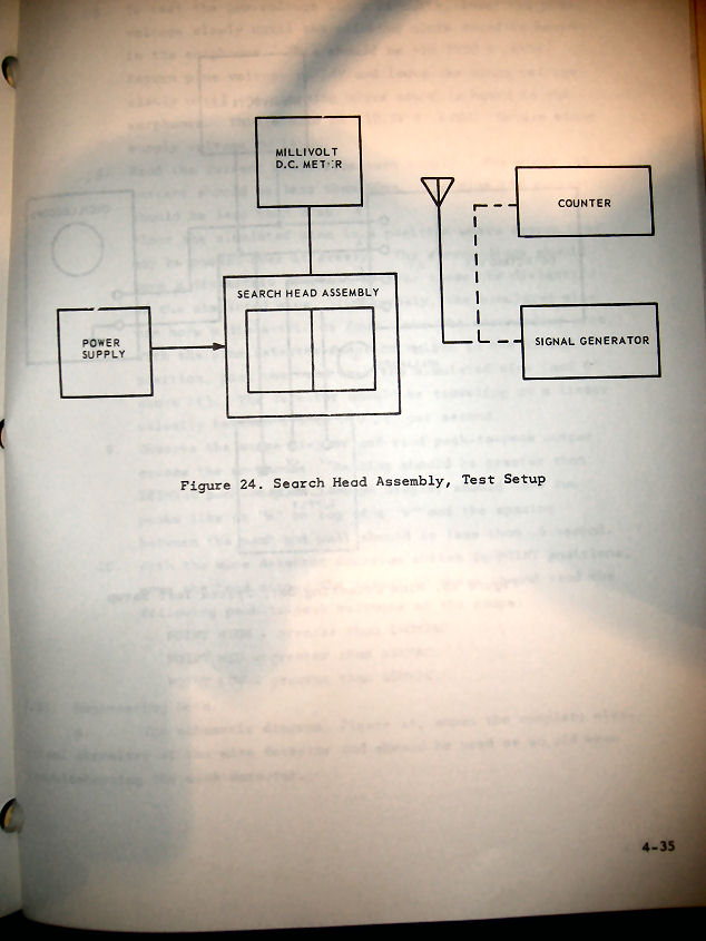

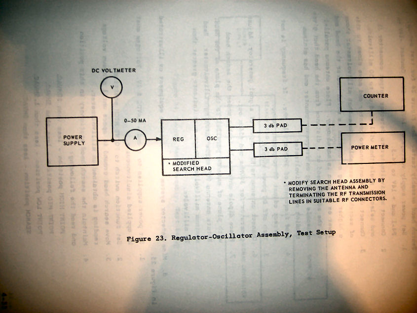

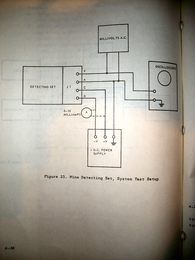

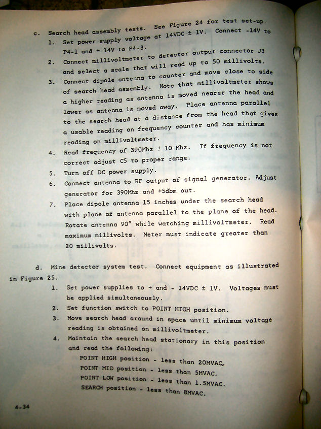

                          I´m very excited with your post where you show pages of the non metallic military detector. Some time ago I have buy the same unit in a surplus store and the manual were not available. Please coul you post the pages with the alignment procedures? the schematic are very clear but the alignment is very important in order to increase performance.
                          Thank´s

                            Hi Willy,
                            Quality is not very good,hope that helps:if you need better let me know.
                            Fred.
                              Thank You very much Fred,
                              The images are fine, this will help me so much!!! I´ll report the results when make the measurements
