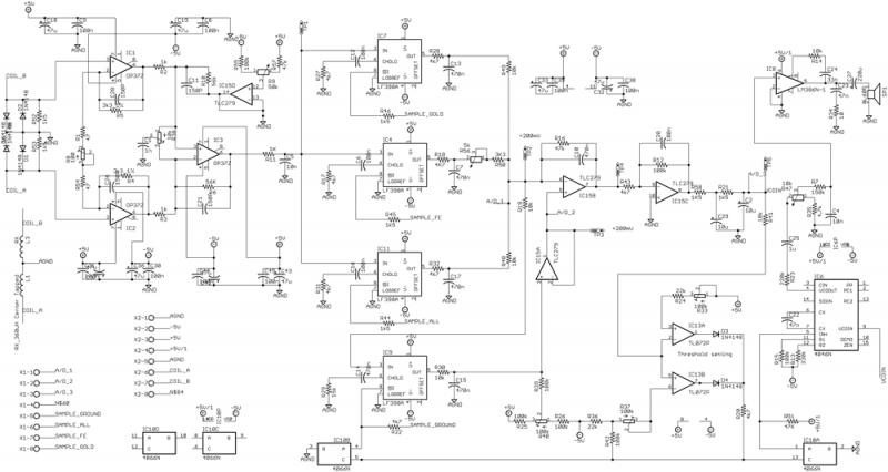

    Here is the discriminating signal processing circuit of the TINKERERS_V1.
    It has been breadboard tested and gives good results.
    The sensitivity is good and the discrimination is to the full depth of detection.
    Any comments, specially on ways to improve are most welcome.
    Tinkerer
    Do you have a higher resolution version that you can post?

        Hi TINKERERS, in to this schematic where is TX coil or Transistor.

          I say congratulations if you made a successful discriminating PI detector! Great job! I hope you make a document of your project and post as file.
          -SB
            TINKERER_V1 DISCRIMINATING PI
            Hobbes,
            attached are the EAGLE files.
            This is a work in progress and the help of all of you is very welcome.
            It would be nice if we could kick the EAGLE files around a bit, each one improving things a bit.
            Tinkerer

                DISCRIMINATING IB-PI
                The TX part is here:
                An induction-balanced PI design originated by Tinkerer and open for community development.
                There is much more information there, about the coil, power supply etc.
                There are also lots of oscilloscope pictures of the signal, discrimination etc.
                Tinkerer

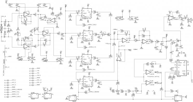

                              Higher resolution RX
