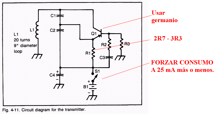

      In some cases the lenght of the wand is important, this is better near 90 cm to 1 m. But if your TX power is poor, yo do nothing with 2 box. Other consideration is the type of transistor in transmitter. I use germanium type and forces the consumption to 25 mA.

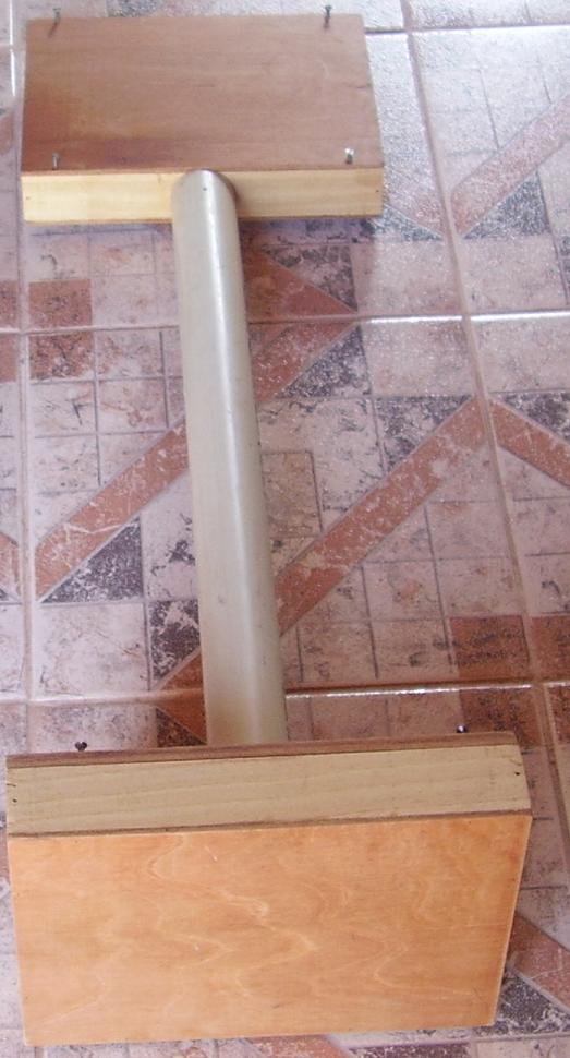

      I remember a project that i made many years ago. It had a bridge with 4 transistors at the output of Tx and 2 MC1349 with 120 db gain on the receiver. Very very strong 2 Box. But, and after very fine coil calibration, i had not the ability to give full power or full Rx gain from the MC1349. With any combination, best results was near to GeminiIII. This is the reason that i say that it is very difficult to go deeper from a Gemini or a Whites with every 2Box detector. Only if you use a very large handle (2m or more) so at fine calibration you can give more power until you hear the beep

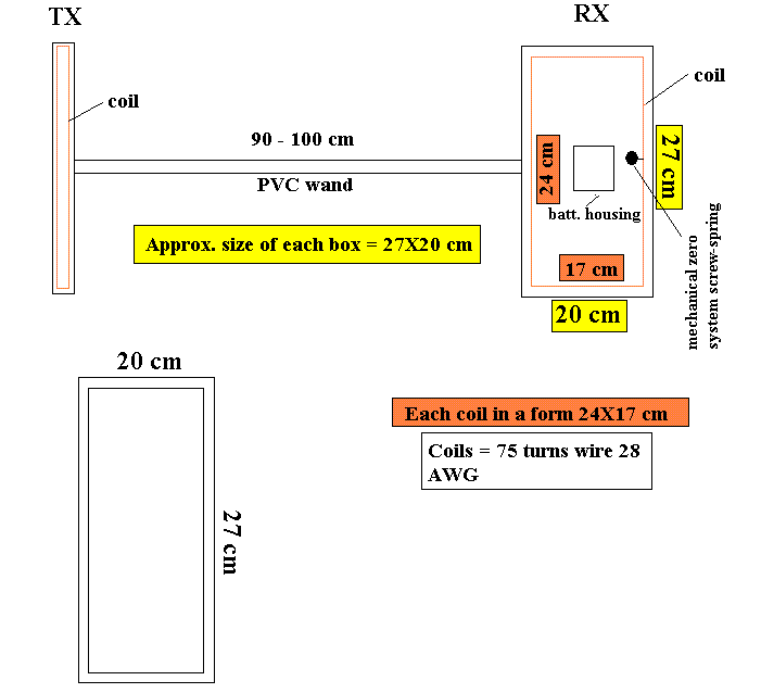

                  This is a 2 box in project. You have here some ideas
                    Here the dimensions.

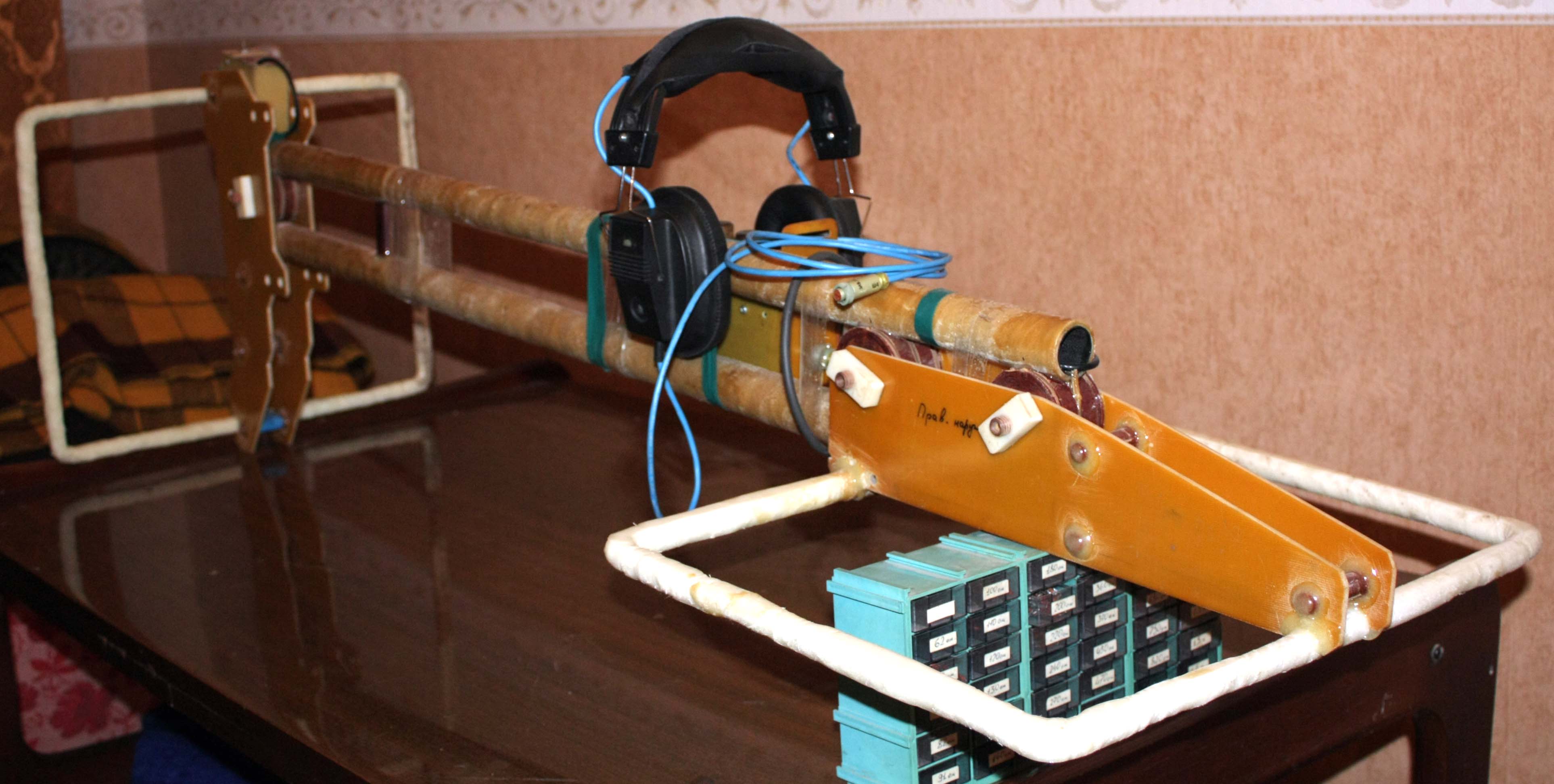

                      • #41
                        I BUILT THIS DETECTOR 8 LATER .
                        DETECT DEPTH IS LOW.18 CM FOR COIN .MAXIM DEPTH FOR VERY LARG TARGET IS 150 CM.
                        THIS DETECTOR NOT GOOD FOR OPRATION

                          Maybe somebody build it. For me, is complicated for 2 box. I think 2 box is a crude detector. Power in transmitter (modulated or not) and sensitive in receiver. Much depend in the exact tune of cap. in coil receiver and correct cap. tank in transmitter coil for to transfer more energy Tx to Rx. There are regulations, but I believe that for personal use you can "abuse" in radiation of Tx.

                          This is a sample what I do with Tx. First, I change silicon transistor by germanium in oscillator. Second, consumption forced 22-25 mA with replacing resistor of emmitter. Use the lowest you can, but always you're sure that oscillations starts. The limit can be 2R7, because with 2R2 don't oscillate. Independent batteries are used for Tx and Rx. 6X1.5 V alkalines for each part (Tx and Rx).

                              I built similar detectors. And my advise for who want... First of all you have to make good mechanical construction for coils. It must be hard. Even very good circuit won`t work without it.
