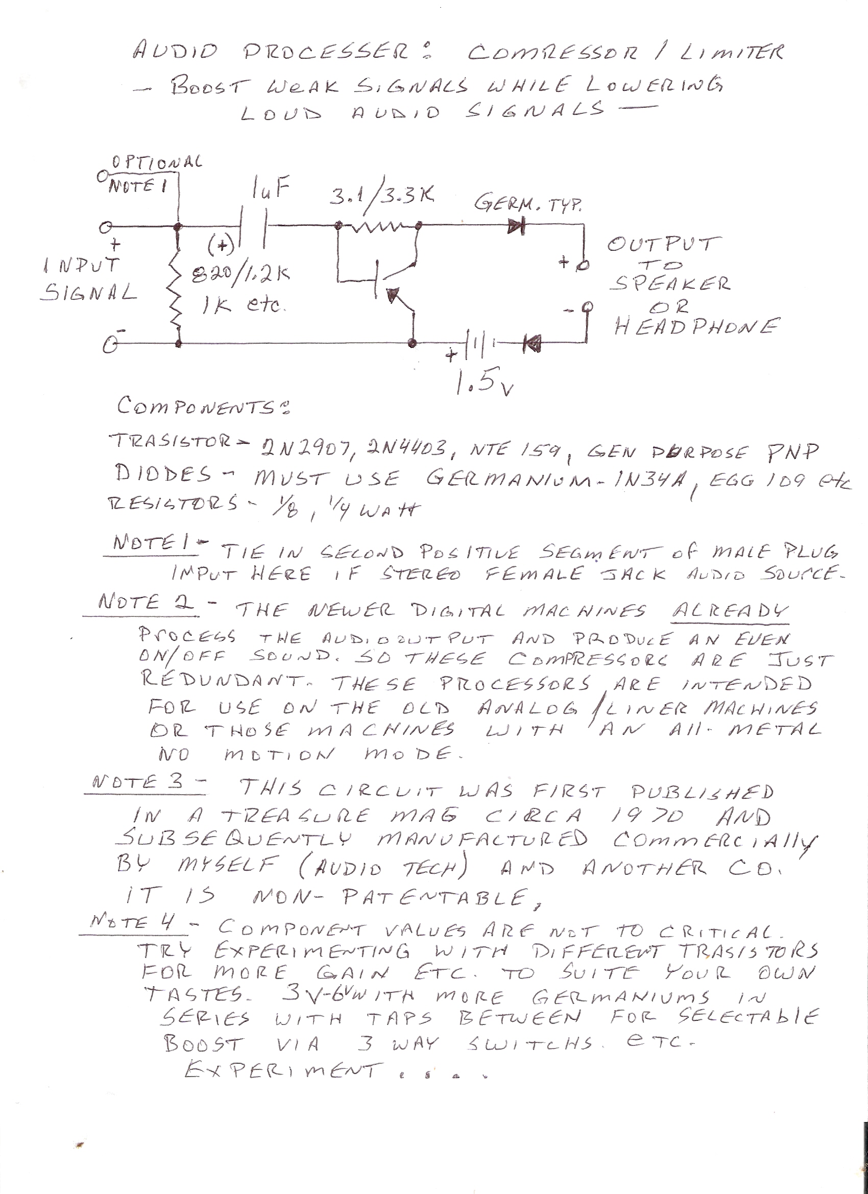

    Yes I would guess that were one to add components into a balanced circuit there would be circuit operational changes. BUT the task here is to recognise that some very major manufactures - Minelab, Tektronics, and I believe Garrett- all had just such an optional external power amp available for those old workhorses. We all know they were smart people Plus owners/operators have reported that they did work. So the question becomes why and HOW did they design the "add-on" circuit to overcome the negitive effects and rebalance the circuit when the circuit was added on. ??? This is not intended as a technical design forum/debate. We are simply asking if there is a few schematics out there that folks can share with us; even internal photos would help the thread. Also helpful and interesting would be first hand experience stated in a down to earth manor with no techno jargon. Anyone??
    I vaguely remember someone saying that the audio output was routed to the coil connector on some machines. Therefore, what might appear as a TX booster could actually still be an audio compressor. Alternatively it's possible that the add-on device is be an RX amplifier. It will be interesting to see if anyone has any information.
      Audio Amp with signal limiter drawing
      I found the drawings and will attempt to upload them now. Besides the standard circuit shown here we also producted one with 3 different levels of amplification, as well as one with a 10 segment LED bar graph which measured intensity of the original signal (helpful for night hunting and depth reading). I can't find the triple boost drawing. But have the LED version , I'll need to clean up the drawing alittle before scanning it. Maybe next week?? I've never tryed the pix upload here yet so my fingers are crossed......which makes it all the harder to do it! hehehehahaha........here goes with the version one upload.
        Doc's audio amp
