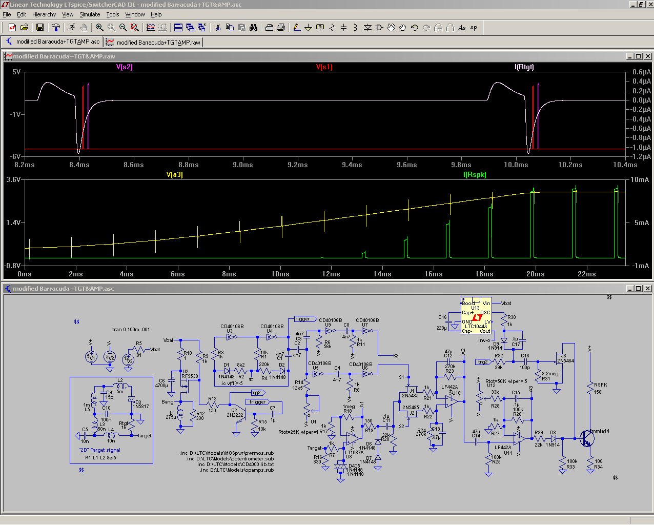

                Barracuda simulation file
                Here I have posted a ZIP file that includes LTspice simulation file of a (simplified) Barracuda circuit (as best as I can determine) and all models and overhead required for a reasonably intelligent person who can operate a computer to be able to run "straight out of the box". Of course, you will need to have LTspice installed on your PC. It is freeware available at: http://www.linear.com/designtools/software/.
                One more stipulation is that you should also insure that spice models for 2N5484 and 2N5485 are available. I have included them, and stated where they should be put. See the standard.jft.txt file for easy instructions. They may already be included with the LTspice download.
                It is good that somebody took the time to reverse engineer this detector, but I think there were several important areas where mistakes were made. I do not believe that a detector made from KT315's drawing or from the subsequent revisions, would work effectively. No offense intended to KT315, but whoever gave you that schematic made some serious errors. There were nonsensical or illegible parts values, a reversed amplifier (U2A), and, what else... ? Oh yes: no, that resistor (R19) cannot go to V- (jeez Louise)! I don't want to throw stones, because I might not have done any better.
                Fortunately, once given a starting point (thanks to KT315) and enough time - it is sometimes possible to adjust a circuit through trial and error until a working circuit is found. I believe that is what I have done, but, I could not perfect the timing and synchronization the way I would want it. I do not know what the original design was, but I am pretty sure that It was not what I started with. So, what I have derived may be functional - but I could not tweak this circuit to where I would say that it is elegant; that is beyond my resources and enthusiasm.
                I leave further tweaking to you, the die-hard builder. That's not me, because although I respect this circuit's simplicity, I would prefer a PI with more adjustment features. If you are going to carry a PI detector around all day, I believe it should be one with a better adjustability range than what I could make of this one. The Barracuda is durable, and good to extreme depths, but, with what I know - I was unable to hack this circuit to perform at a level where I would want to construct a clone. I don't like my secondary delay period adjustment and I don't want to play with it any more.
                Have some of you have already built this, but it did not work? Maybe now, you can get it to work. Please, don't blame me if if doesn't perform to your expectation. And don't blame Anchor company. For somebody who has not already built a Barracuda clone I would say: this circuit is unproven. Why bother? There are other proven designs available for hacking. I think the best features of the Barracuda are its low cost and waterproof durability. It works great underwater and on beaches where you do not want or need a bunch of adjustments! The manufacturer knows for sure what the circuit is and how to tune it. I don't, and you probably don't either.
                If you will scuba, then buy a Baracuda, you will be very happy. But, if you hunt on land; until we can get a better knowledge of the Barracuda circuit (and that means somebody taking one apart and telling us what is REALLY inside*), then, build a Hammerhead (or one of the others)! (Just my two cents worth.)
                I think my package should work, but if somebody has trouble simulating this I will help if you ask. (Oh, but please consult the help files, first.)
                *Please supply timing diagams and photos if the circuit is really strange

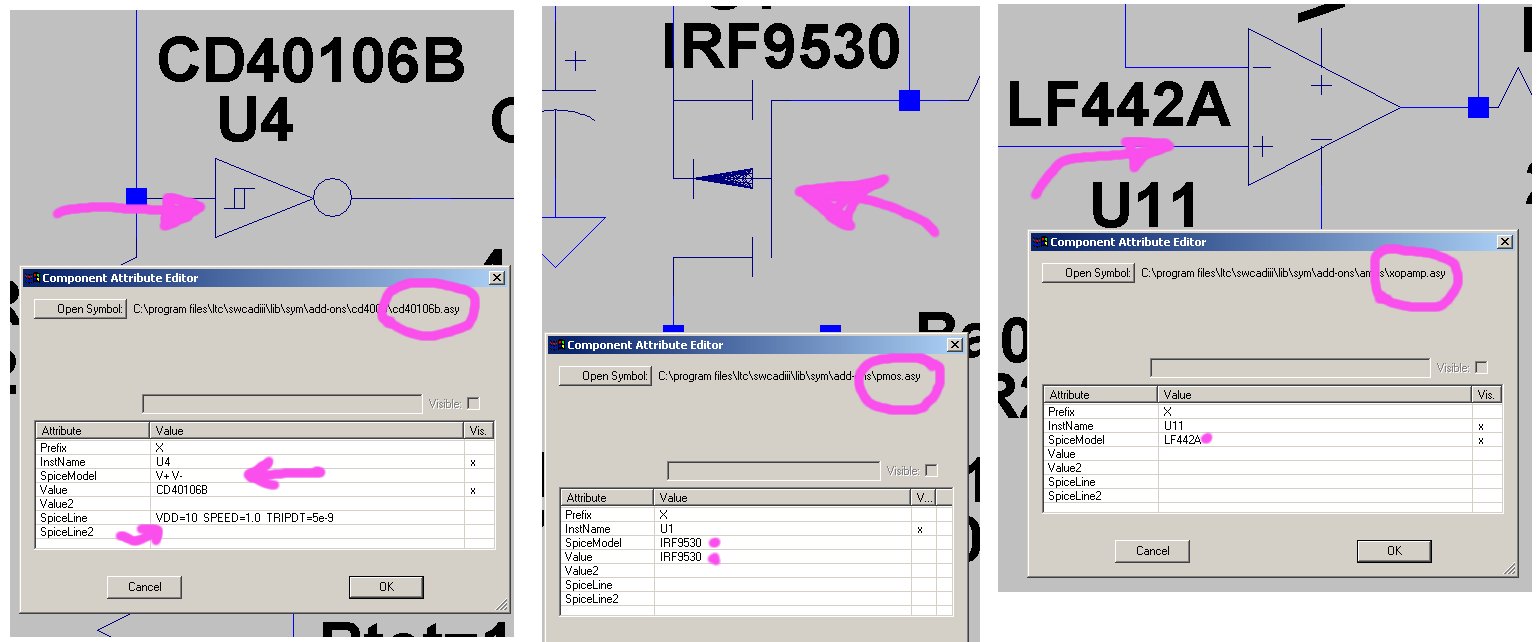

                  whoops-almost forgot...
                  Sorry folks, I left out some important information...
                  When you open Barracuda!+TGT.asc or Quick Barracuda.asc, you will probably get several error messages stating something like: "... can't find IRF9530 asy".
                  You need to use the PMOS symbol that I have included. To add:
                  click the "Add Part" icon (the one with an AND gate symbol) and navigate to the folder that you unzipped. Use the PMOS symbol. After placing the PMOS symbol,
                  right click on it to open its attribute box, and edit it as shown in my new picture.
                  Better still, is to start a new folder inside the LTspice installation folder: C:\Program Files\LTC\SwCADIII\lib\sym\3RDP. Inside the 3RDP folder you can create subfolders
                  to organize different types of parts. Place the *.asy parts that I supplied in a ...\sym\3RDP\WHATEVER folder. Put the complete "CD4000 asy" folder in \3RDP, also.
                  Do the same with xopamp.asy and LF442A.asy. Something like \3RDP\amps would be good. Something like \3RDP\POWER would be a good place for the LTC1044A.asy symbol
                  because it is a modified version of what was supplied with LTspice.
                  I suggest that you rename "CD4000 asy" folder to CD4000; I changed it and should not have. Change it back.
                  You will have to restart LTspice before the new symbols will be available.
                  You will also need to place LF442A and the CD40106 in the schematic. After placing, right click the CD40106 and edit it like in my picture. The LF442A should be OK.
                  It was created from the Xopamp.asy symbol and needs no further editing, I think. Once you place and edit a part once, you can copy and paste it many times.
                  If you leave all model files in the same folder as the simulation.asc file, then simply use the ".inc whatever.sub" statement (already present) without indicating "drive:\pathname\".
                  It's hard, I know - but I try to make this easy. If I left something ELSE out, please let me know. I'm sorry, but I lied when I said this was for everybody.
                  I forgot that you've gotta have more than a little geekness or you will give up too soon.
                  I'll try not to bother you any more with this unsolicited junk. Good luck to yous.
                  • #54

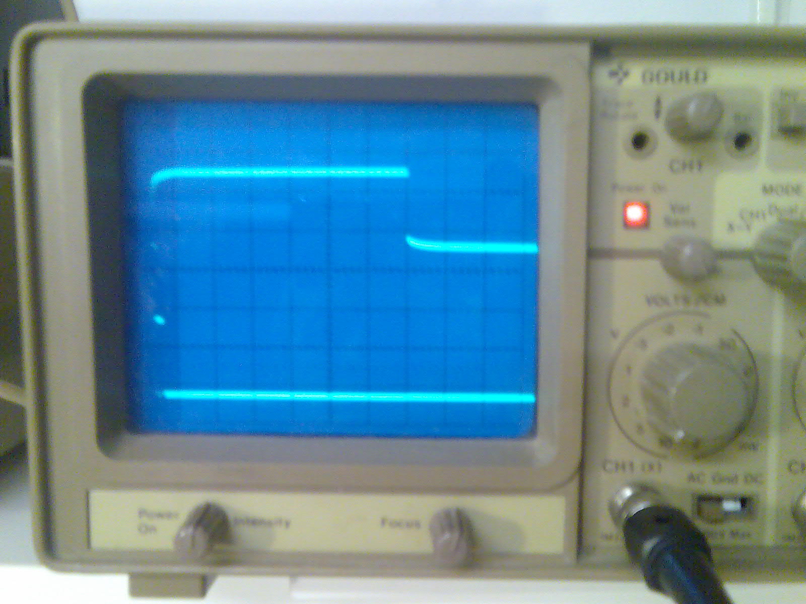

                    Hi All.
                    I just finished with the painting of my Lab and now i am ready to try some detectors.
                    For the first i tried the Barracuda with timing as porkluvr wrote at #49.
                    Pulses are good but...... there is a big mistake. Pulse of delay1 (first sample) don't begin after the finish of the Tx pulse but when Tx pulse begin.
                    It is not possible to work the detector with this timing.
                    I played with the LTSpice simulator without results.
                    So i will try with a difference circuit for sample pulses.

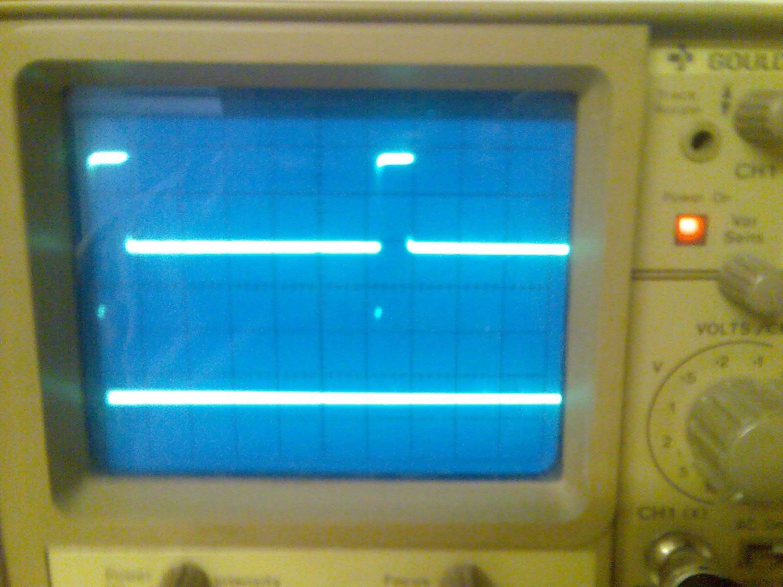

                    • #55
                      I made an other pvb with 2 IC's 4538 for the sample signal.
                      Until now i have not good results.
                      Today i have visitors at home, so at night or tommorow i will make the new experiment.
                      When it will work i am afraid that it would be a new detector

                                Hello porkluvr. Thanks for your files and interesting. There is a big problem with the timing so i constructed a small pcb with one 555 and two 4538. It produce very good pulses but now i have problem with the match of the pulses. You Know.... difference voltage (not symetrical at the 453, difference phase (180 degree reverse),etc. But never mind..... i will match it. The problem is that at the final... it will be a difference detector (litle from Barracuda....a litle from Whites.... a little from me ...etc)
                                Ohhh something else. When i load the Barracuda!+TGT.asc and run simulation i take a message that says "could not open library file "FMMTA14.sub"
                                What i can do????
