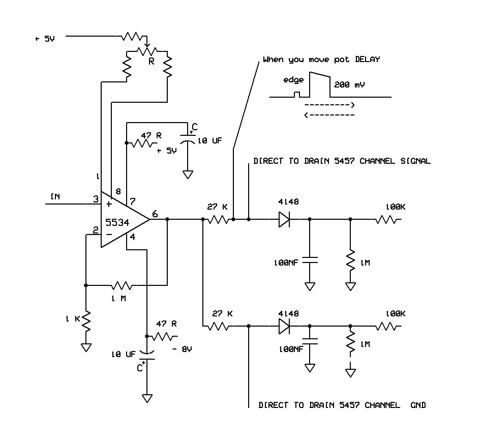

          • #65
            Hello forum
            Porkluvr I have revised the schematic in my post 45 is OK 100% I post the front end i use for the two channel .
            BEST WISHES 2008
            • #66
              Hi Alex.
              Maybe all your schematic to work fine, but when i simulate the out of 40106 direct to 2N5485 then the pulses are not good. Maybe 40106 have not the ability to direct load the 2N5485. The same problem i have now with the 4538. Alone are working perfect but when i connect to the 2N3819 the pulse it falls. Today i will connect a resistance in series and i believe to finish the problem.
              • #67
                Check your 2N3819 connections. There are differents 2N3819 pinouts used by different manufacturers. You probably assume SGD but actually have GSD, or vice-versa.
                Also, 2N3819 is probably not the best choice for a 2N5485 substitute because VGS(off) is a little high.
                Hi porkluvr.
                The connections of 3819 are good. Today i will try to connect in series with gate a resistor (56.... 100k). If i will not solve the problem then i will change the 3819 with BF245B.
                I will try it later. Now i have problem with the TV antenna and i must repair it (i can't hear my sons)
