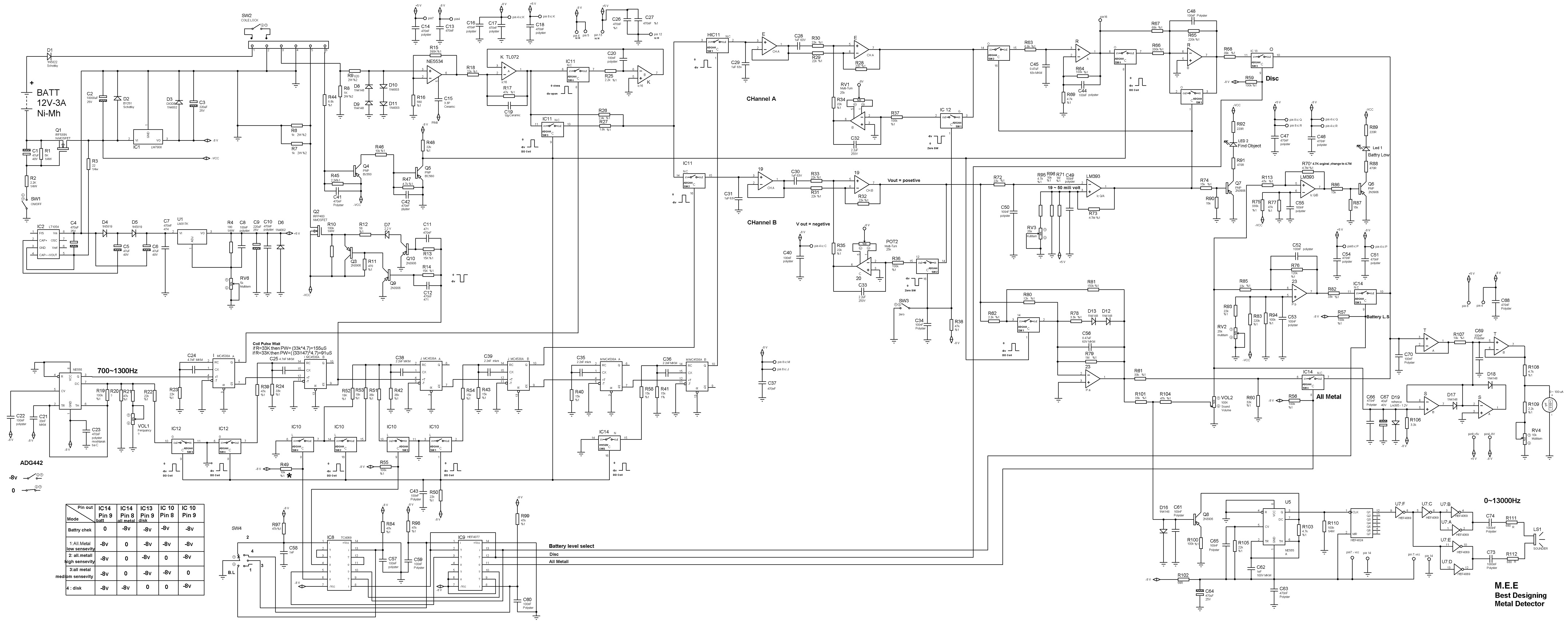

    this is a lorenz pulse 5 schematic
    all know this project is very very hard for me
    but im send for all
    100% is ok i made it
    tanks
    • mee60 that looks nice, good job!
      • fine job. thank you.
        • Mee60, very good job
          Thank you
          • Mee60, Hard job and good job give you a lot of satisfaction , Thank you to share for the forum,
            Saludos from Mexico,
            Alexis
            • thank you very much mee60 for sharing schematic sorry can you share search coil detail for this metal detector? , very good and hard job and good luck.

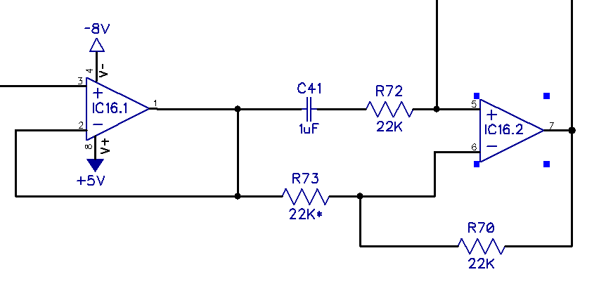

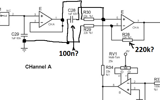

                  • I think the amplifier circuit is wrong. It should be something like that.
                    • Sasho connections appear to be consistent with mine which I have from drawing schematic from the original board photo.
                      For component values I can't speak. I did mark R73 with * when I draw this few months ago - I don't remember exactly why - probably wasn't sure for the value.
                      • This is a classical circuit of a DC amplifier controlled by an integrator.

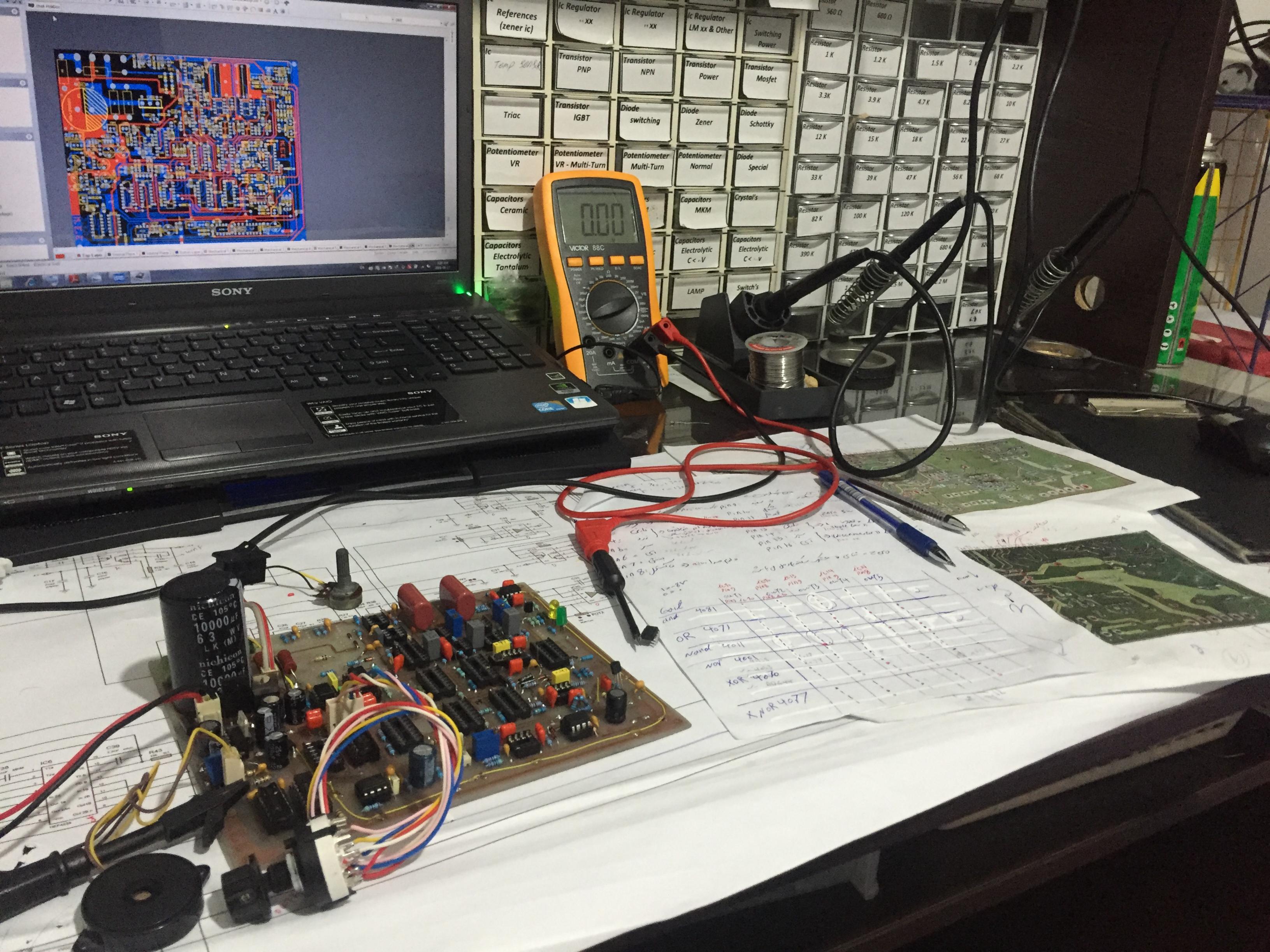

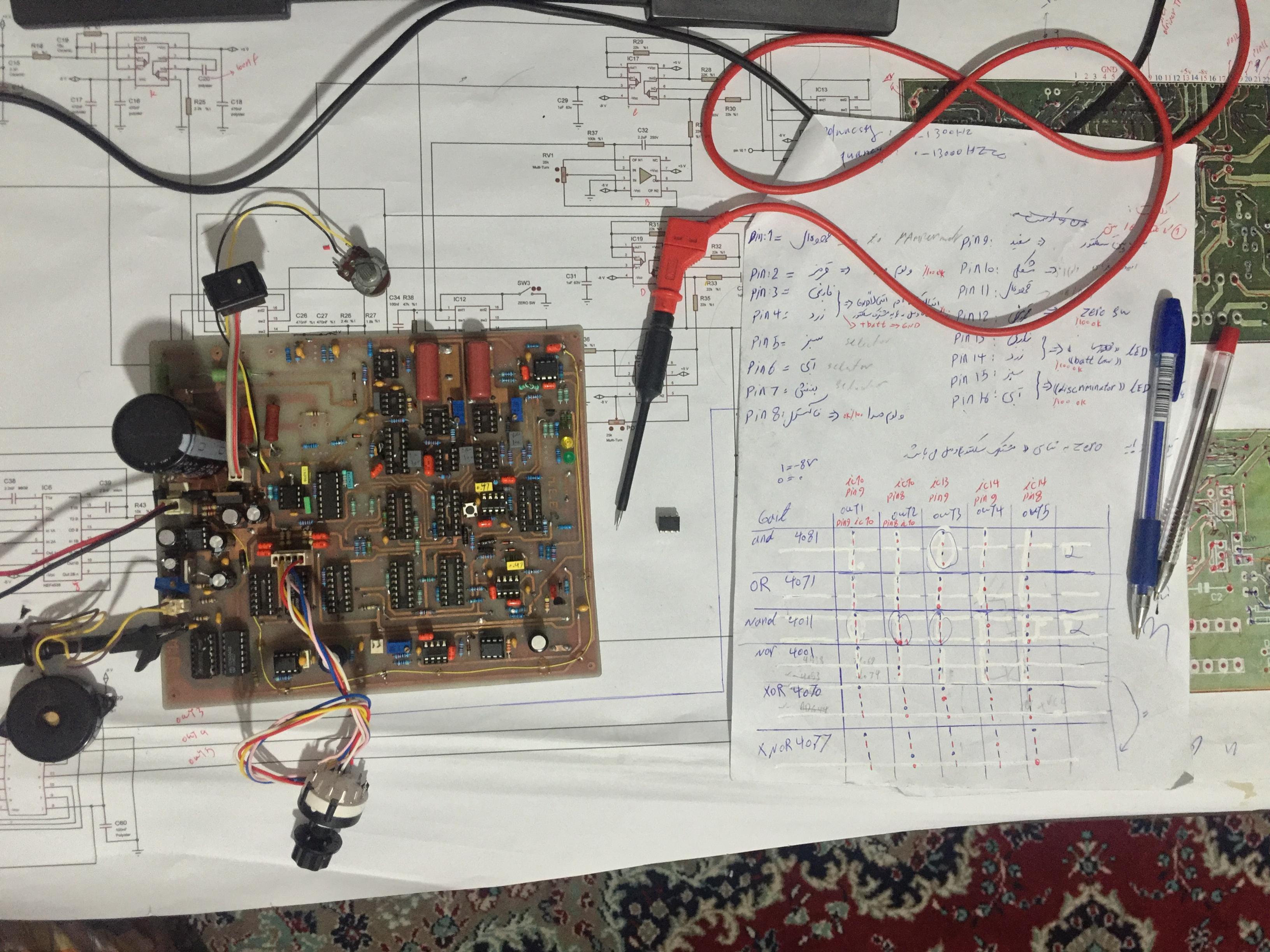

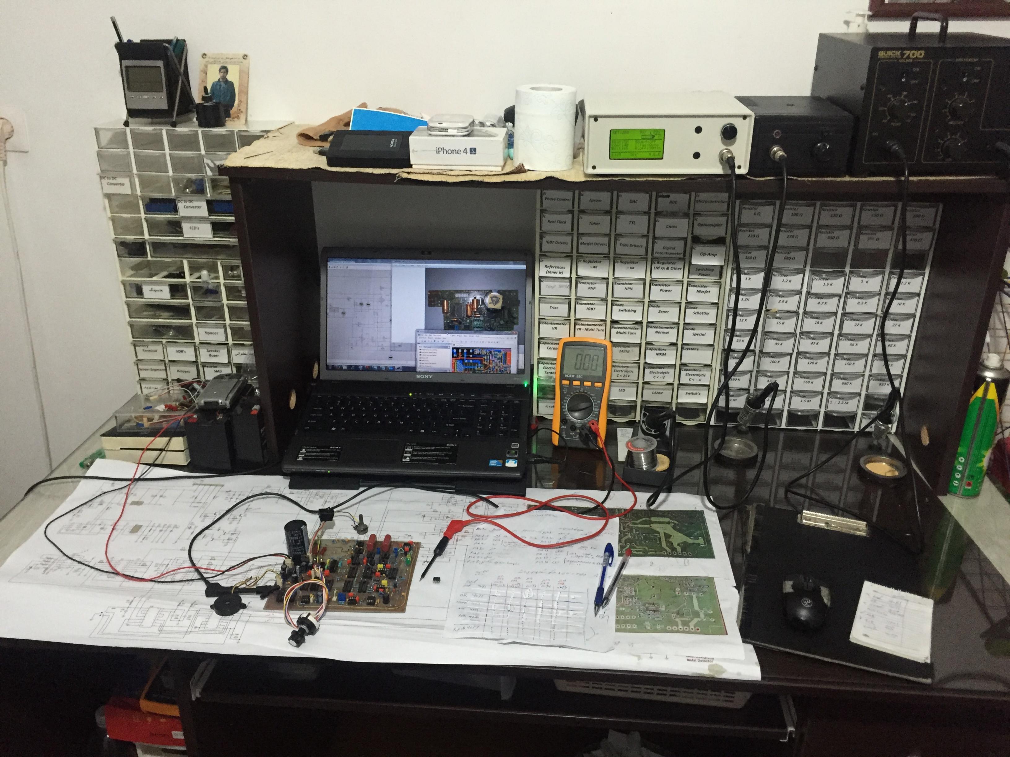

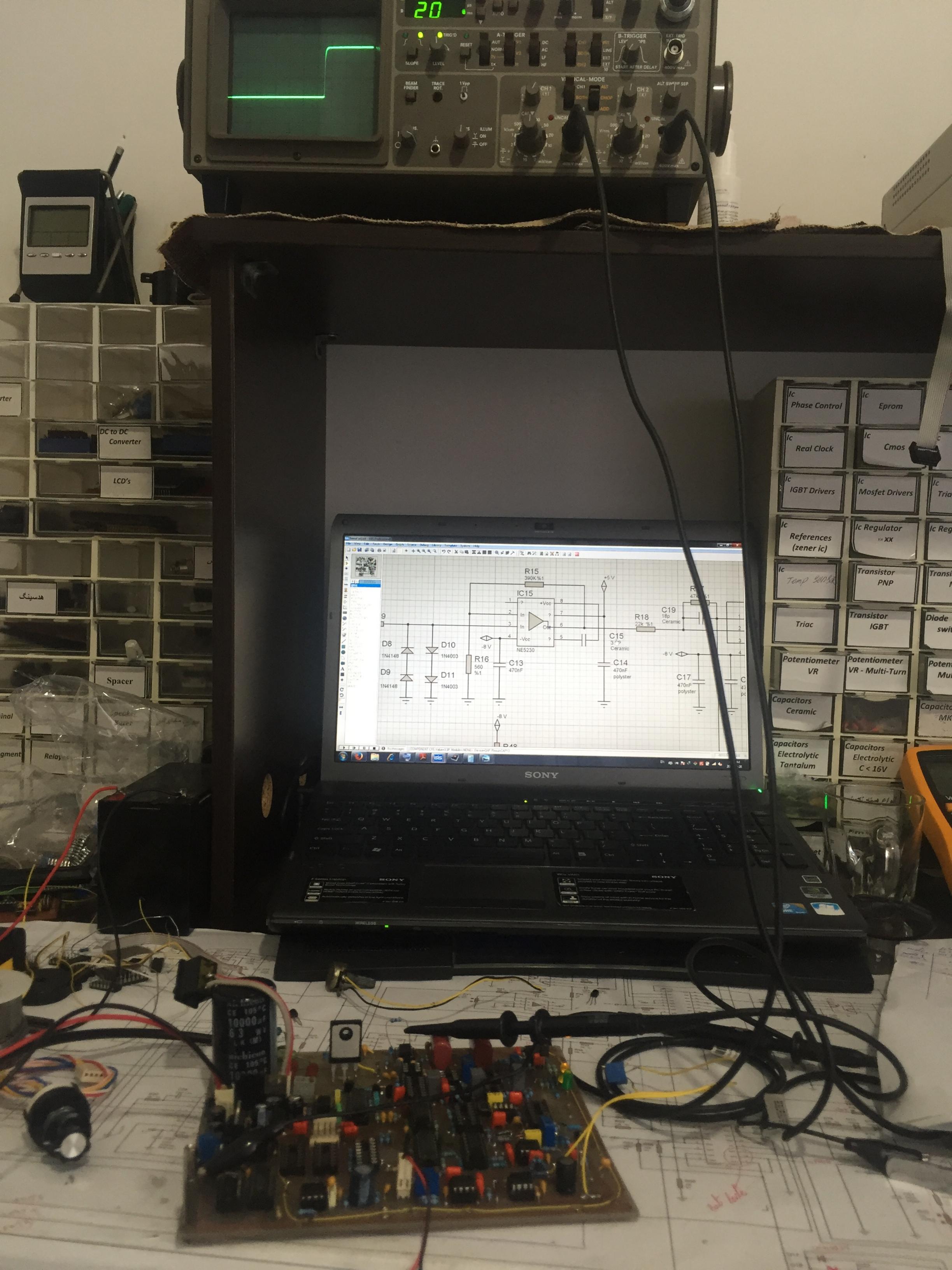

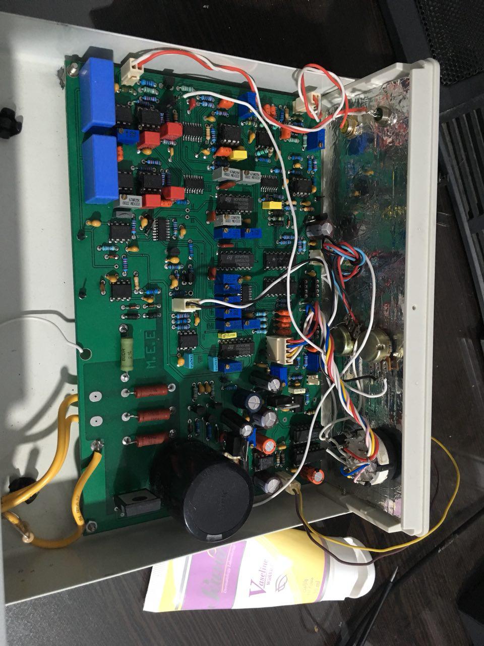

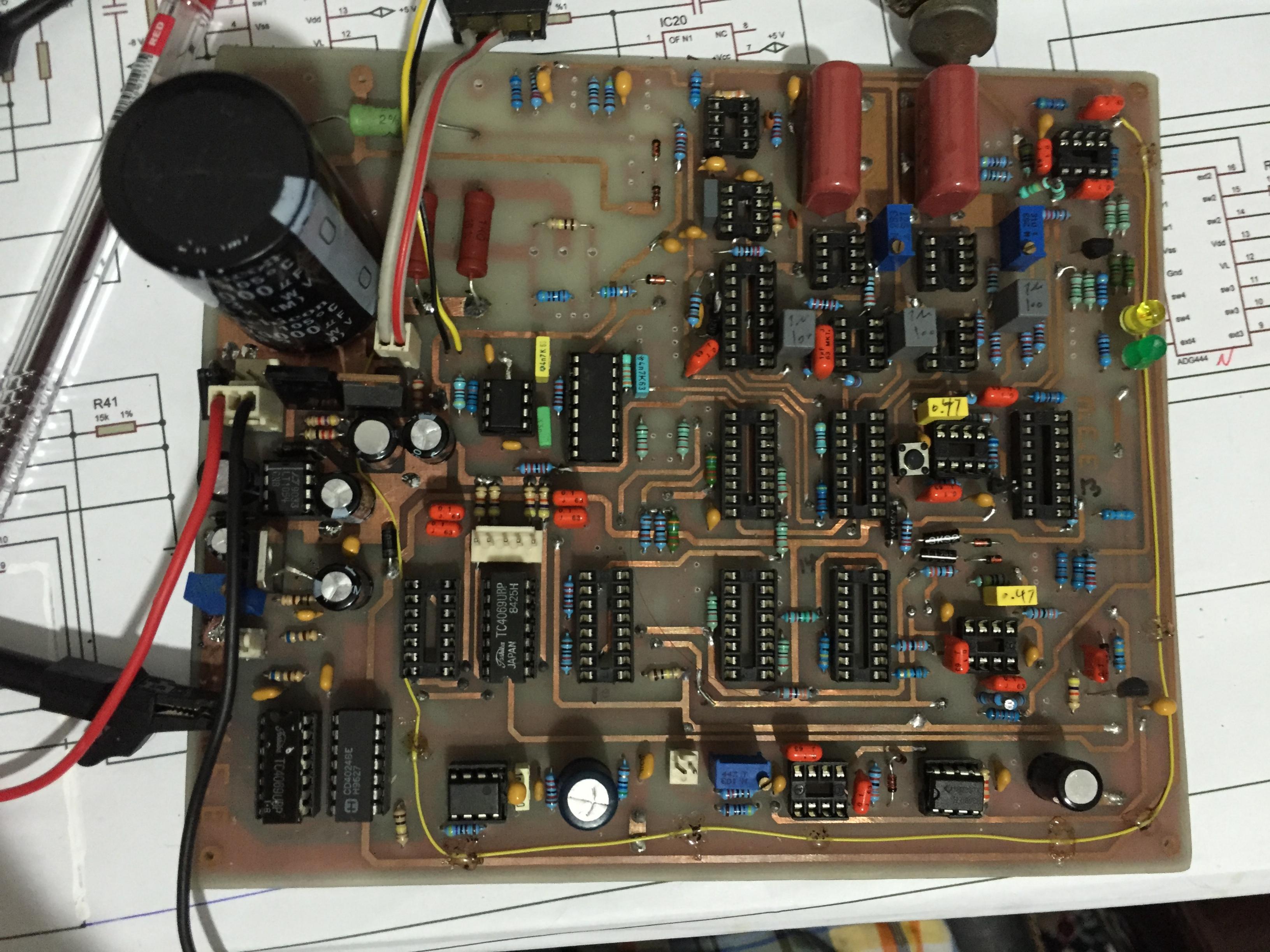

                        • hi all
                          i drawing lorenz lp 5 schematic of original circuit pic .Maybe it's a mistake.
                          but i make it and worked fine
                          not : ADG444 not worked in circuit it typing wrong . it is ADG 442 im used it .
                          not : power supply in circuit is -8v and +6.5v . im chennged original circuit with lm317( original ic is lm2950 dip )
                          not : i dont know original coil parameters but i used mono coil (( 35 cm coil 1.8~2 ohm 390~400uH)) and (( 50cm coil 2.1 ohm 400uH)) . 35 cm coil is better in my test.

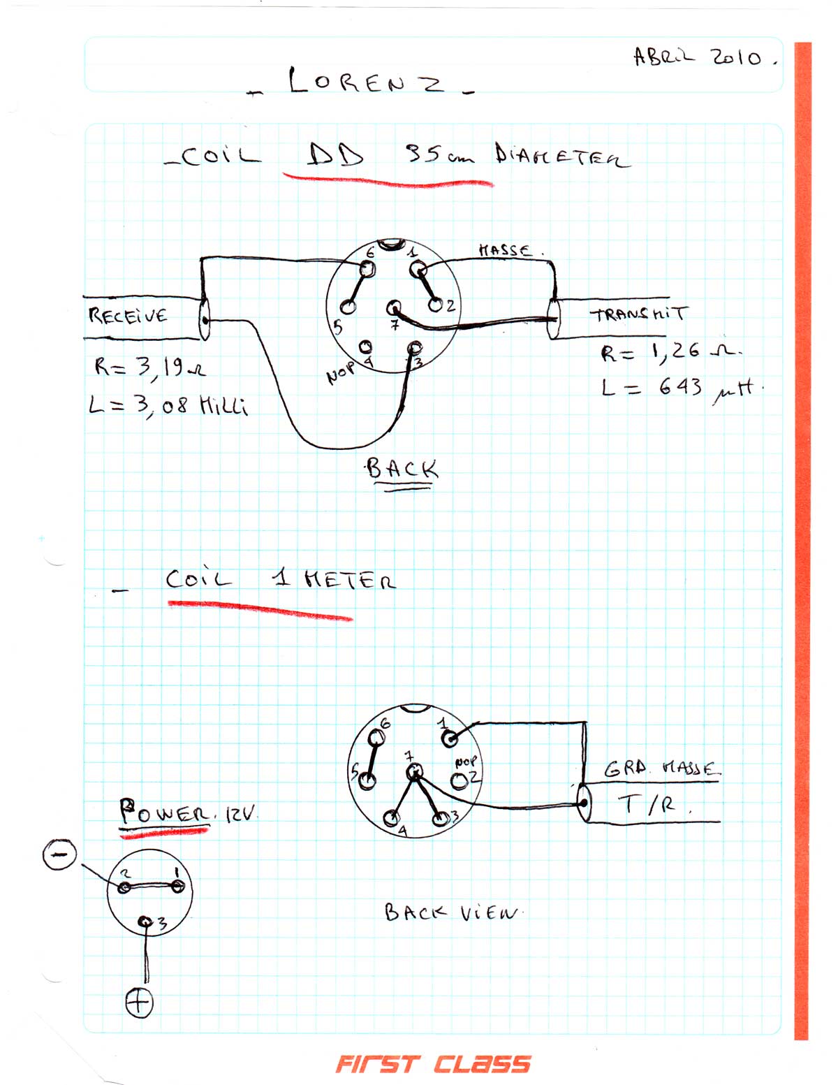

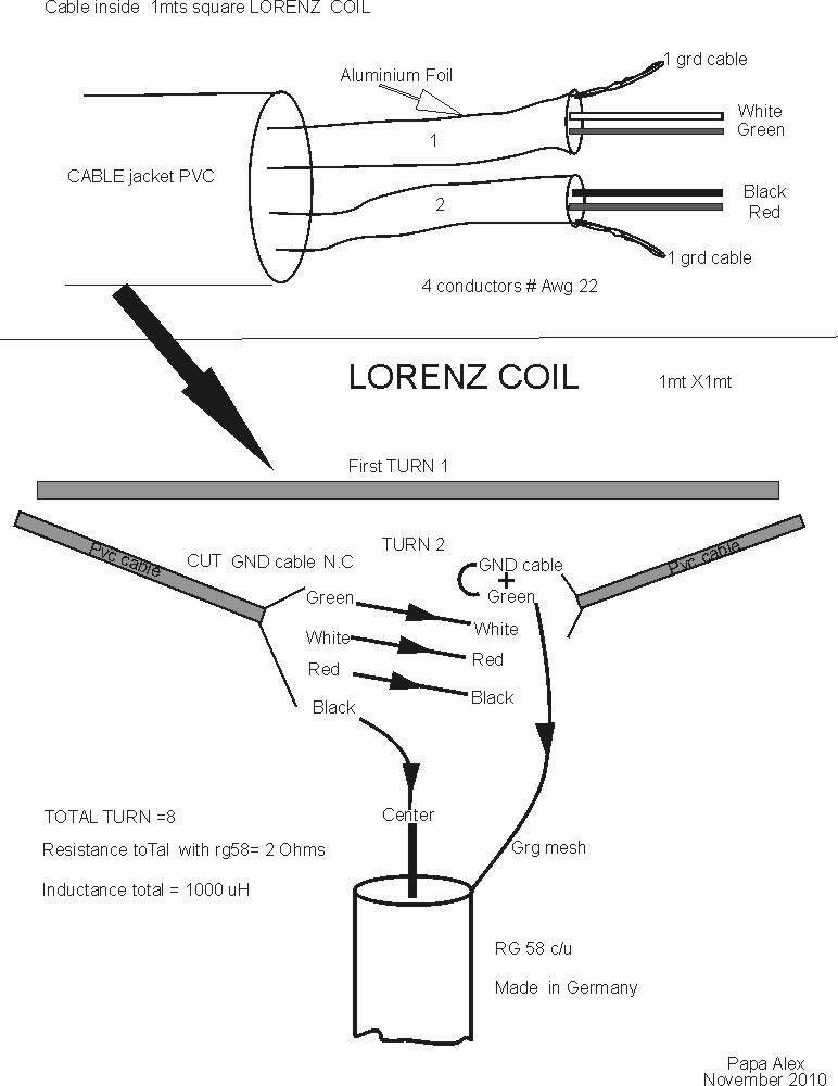

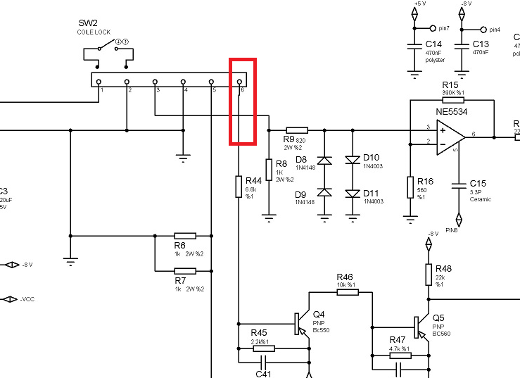

                          • Where the marked in red is connected with mono coil?
                            • Hi
                              when used DD coil this pin (6) connects to grund.
                              Please see original connectors
                              • Im asking for Mono coil. The original drawing is not in English and it's not very clear how to connect it for Mono coil.
