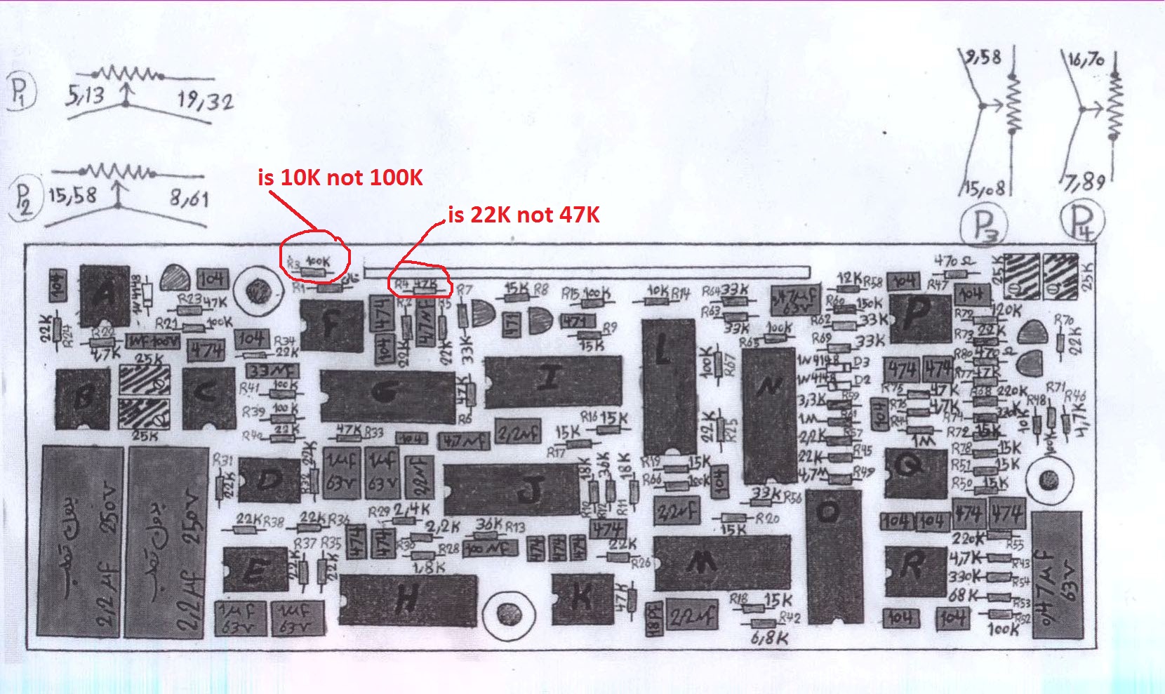

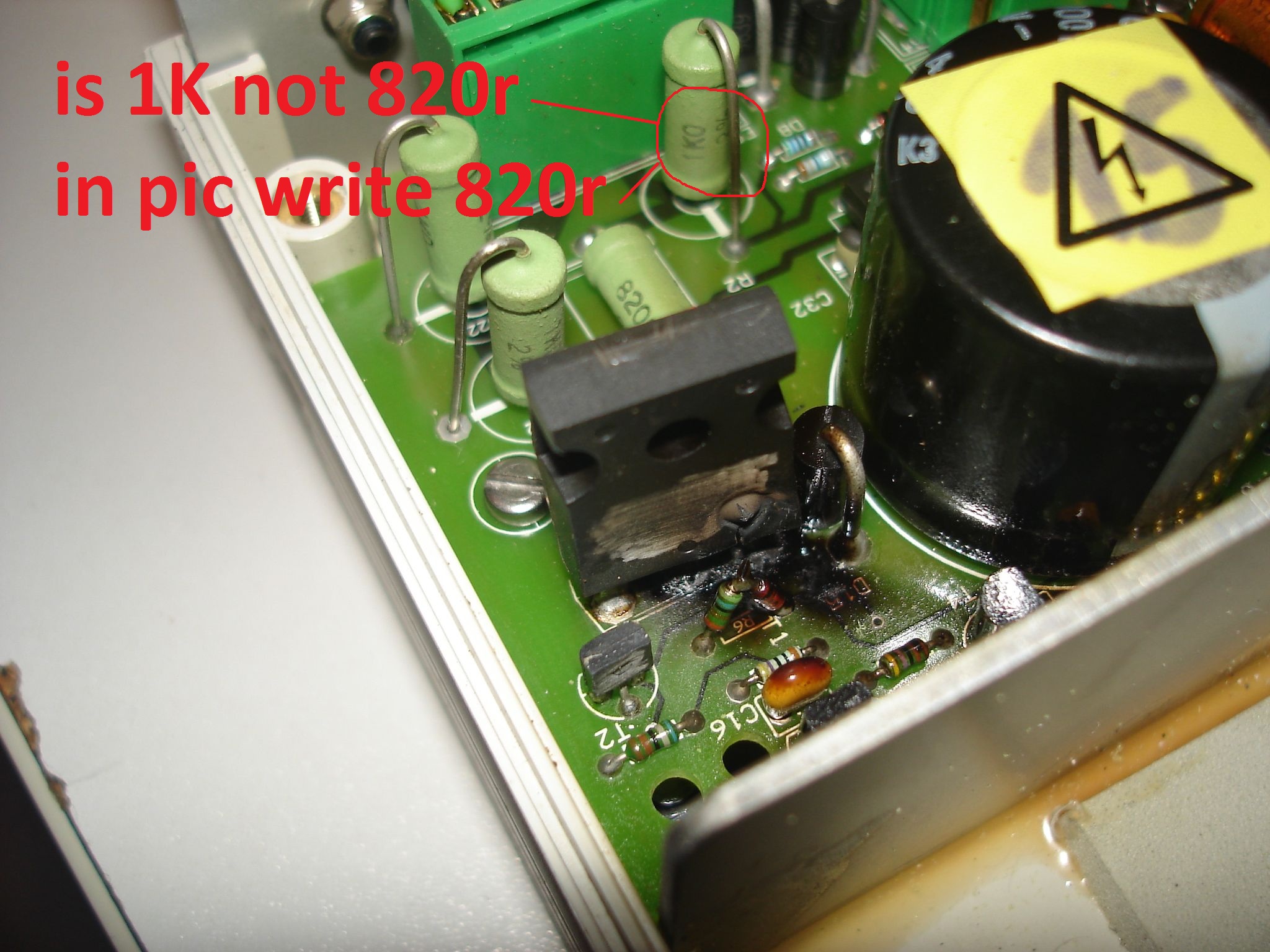

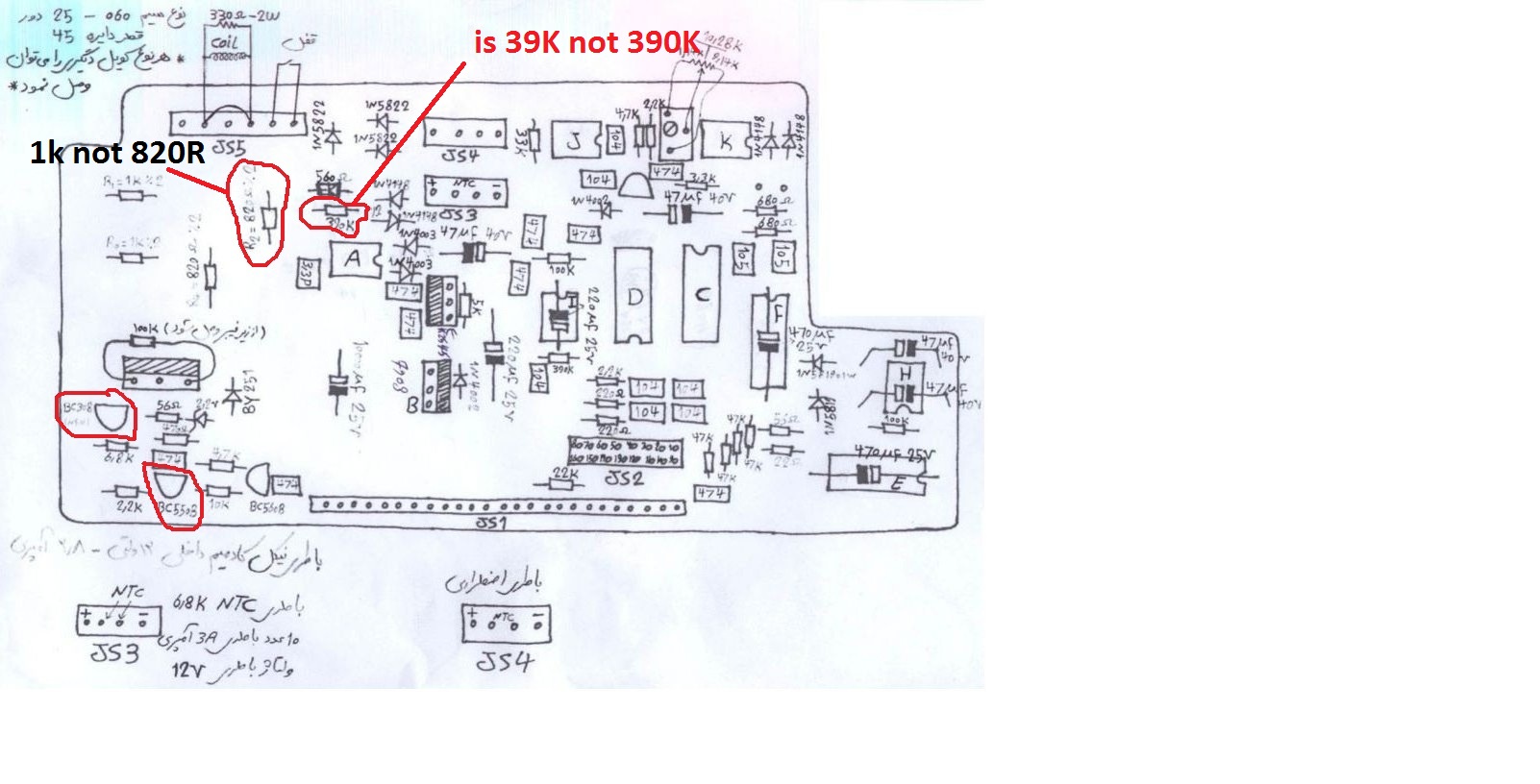

    • hi kt315
      There are many problems in the photo. For example, the values of some of the parts is not true.
      In the photo below you can see that I've corrected them.
      The person who wrote these values is a big mistake
      Probably with on-board measurement was recovered.
      And parts not out of board for measured
      I need to picture quality on board
      Help me please
      After the project put at the disposal of all
      tanks

      • a problem is in a people. they are not able to desolder a pcb and draw normal schematic causing other people to suffer.
        • Ok
          im draw the schematic
          but the pic is low quality , is very bad for read resistor values
          i need a high quality pictures of board s
          how are have high quality pictures of boards?

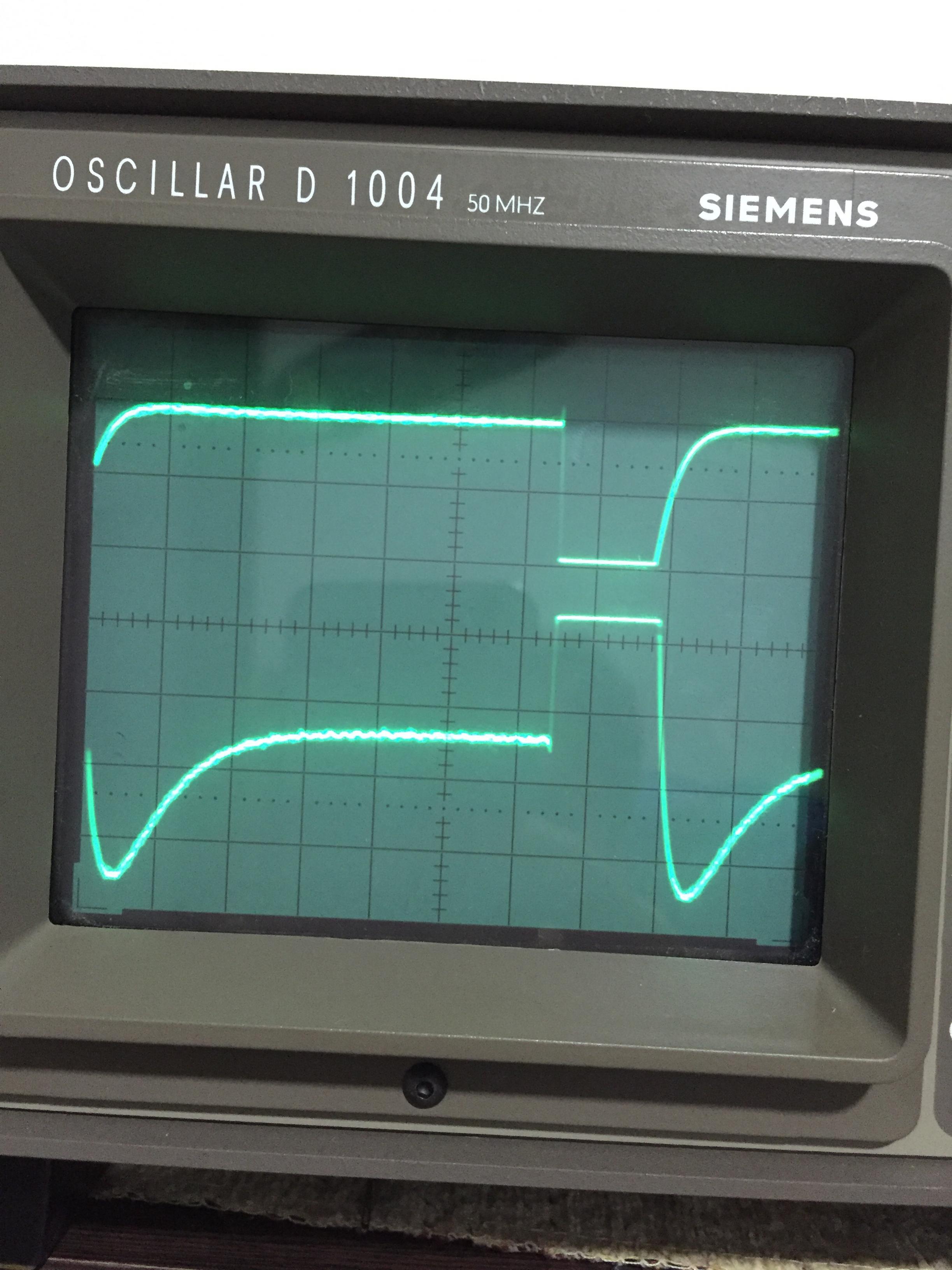

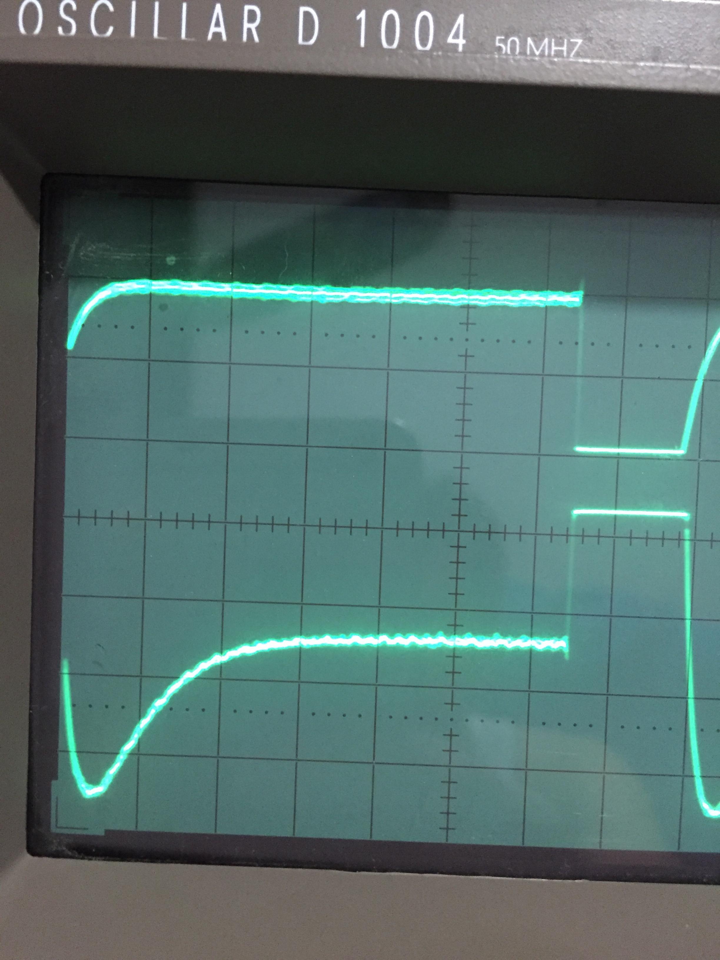

            • coil signals with minimum nois

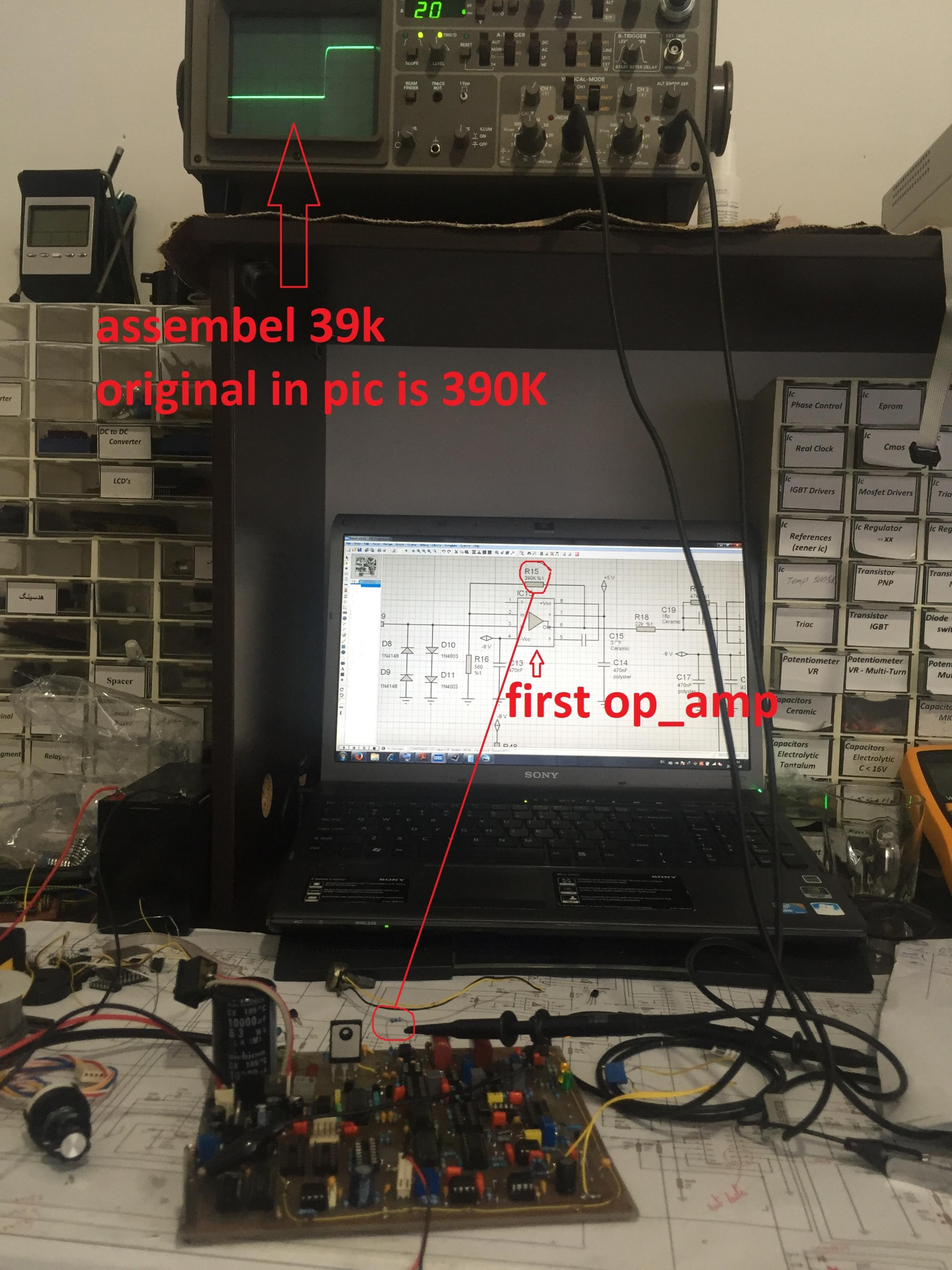

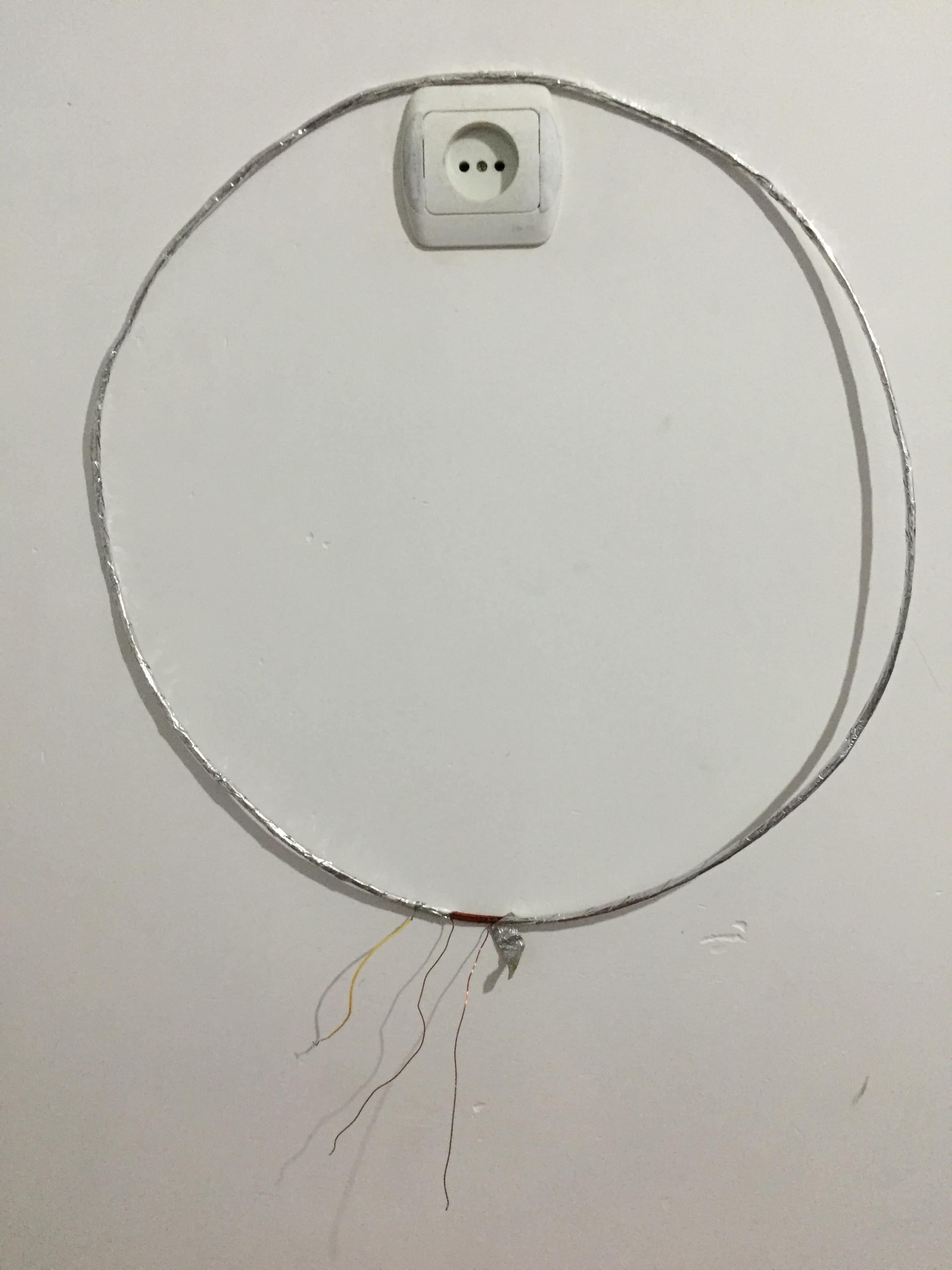

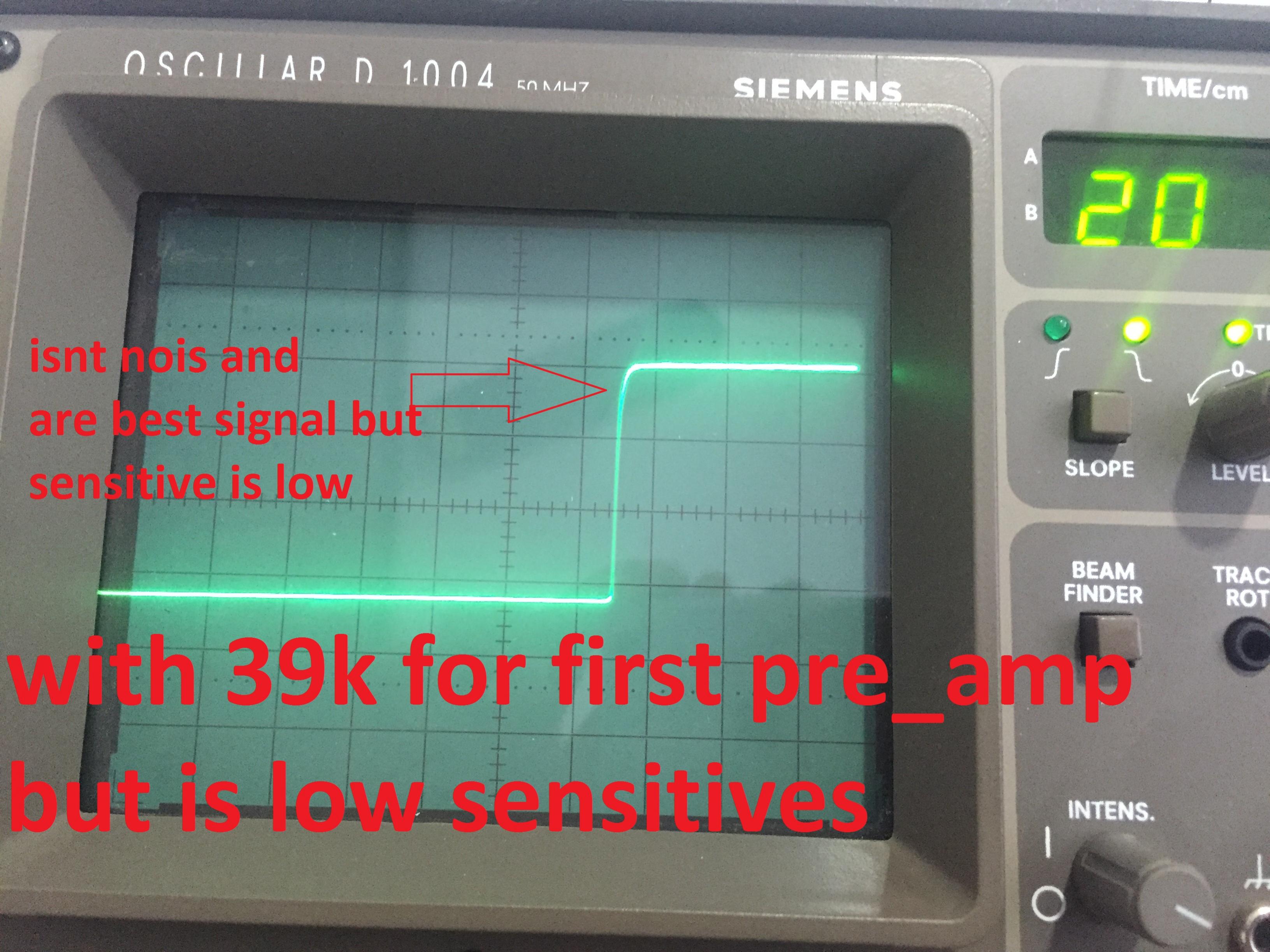

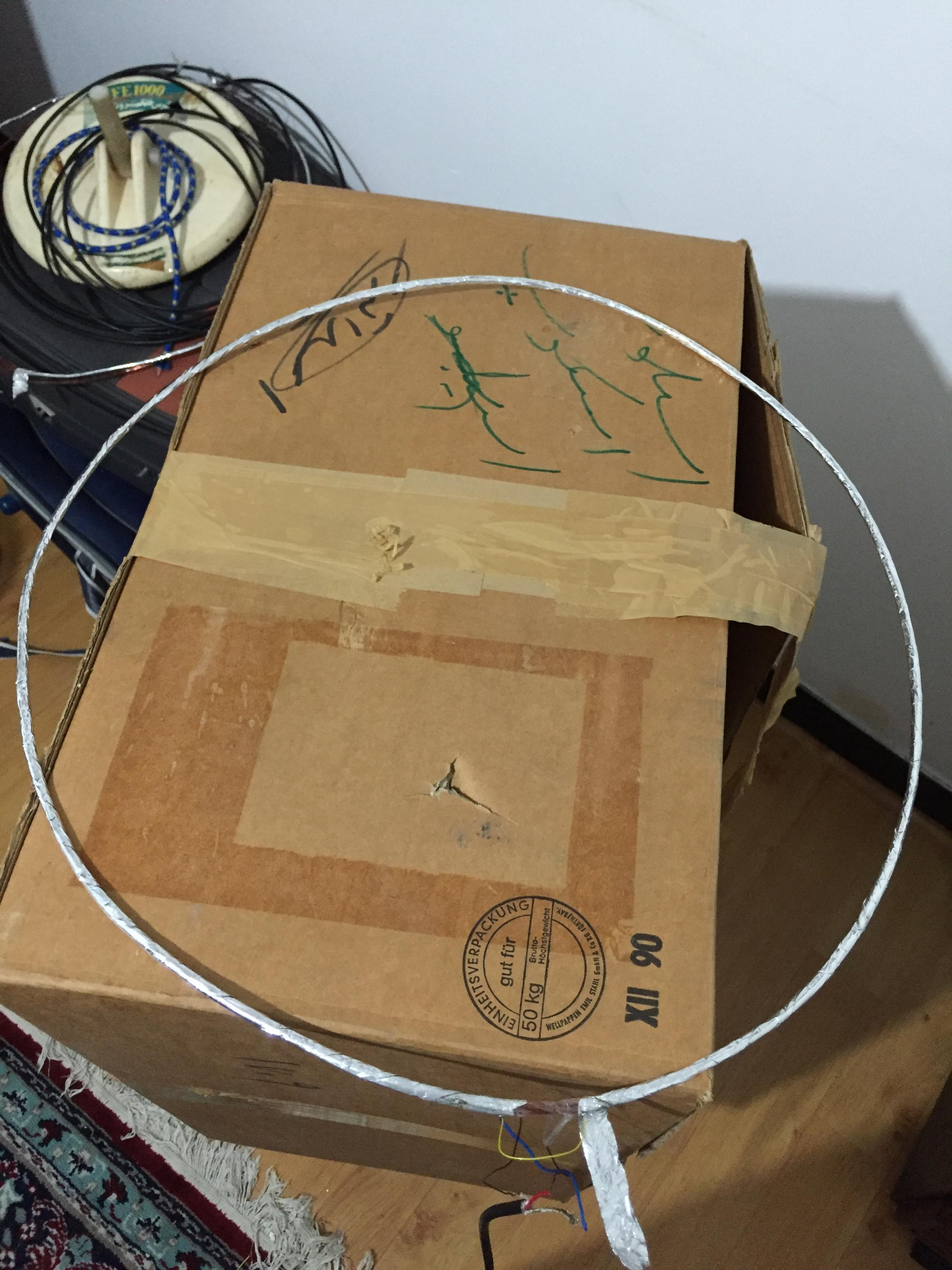

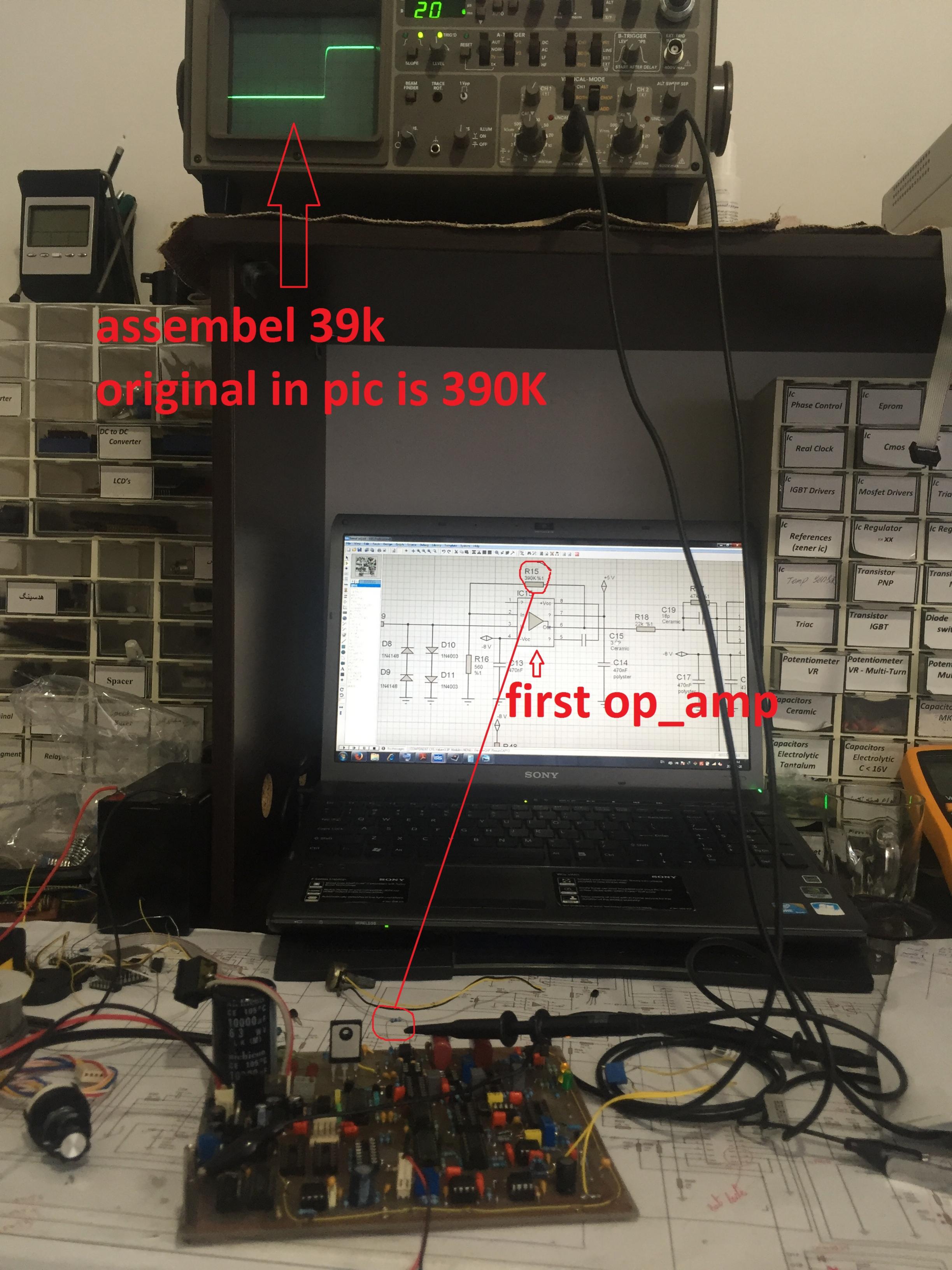

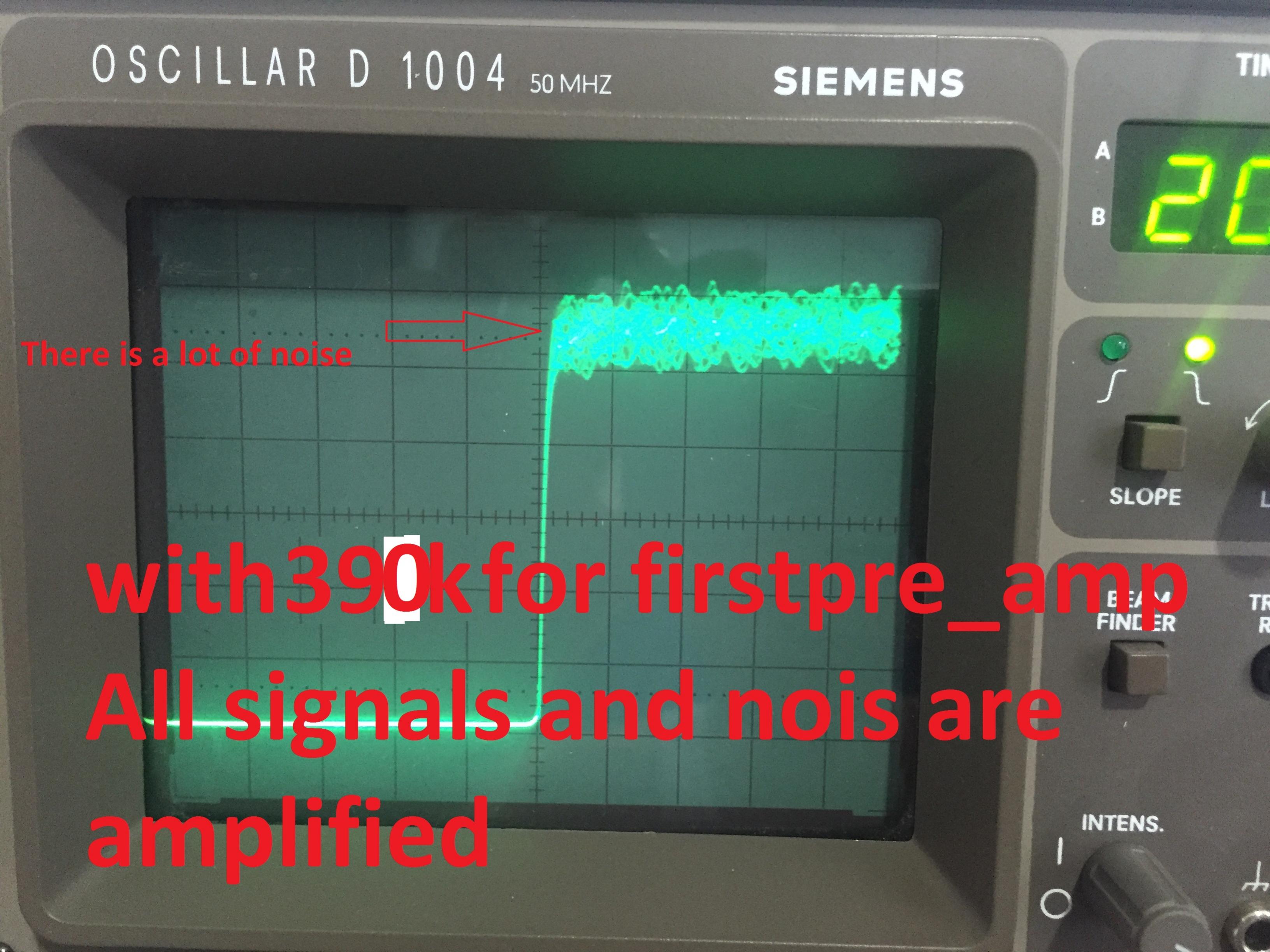

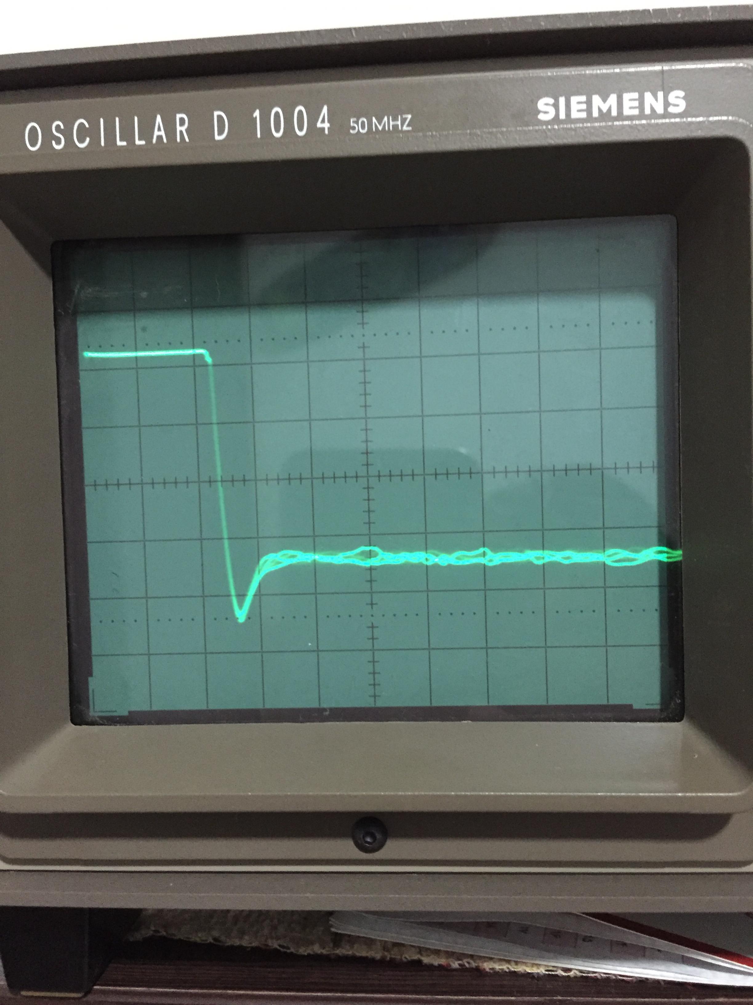

              • hi all
                my lorenz project first op amp output is not stable
                im secure coil barameter is a mistake
                my hand make coil is :
                45cm / 0.60 mm / 25 turn / 2 ohm / 635 uh
                and
                45cm / 0.60 mm / 17 turn / 1.8 ohm / 510 uh
                i need a lorenz coil parameter
                is he opened lorenz coil ?

                • just add a resistor parallel to coil, start form 2k then go down to the lowest value where the coil not rings so much
                  as i know from other coil we x-rayed here the wire for tx coil or monocoil is not such big Diameter
                  try better 0,3 or 0,4mm
                  the inductivity under 400µH
                  hope you don´t misuse all Information you get here, be fair
                  good luck for your further work

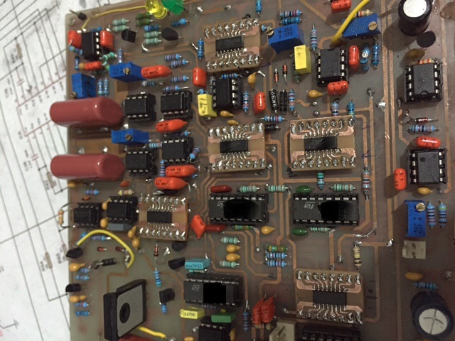

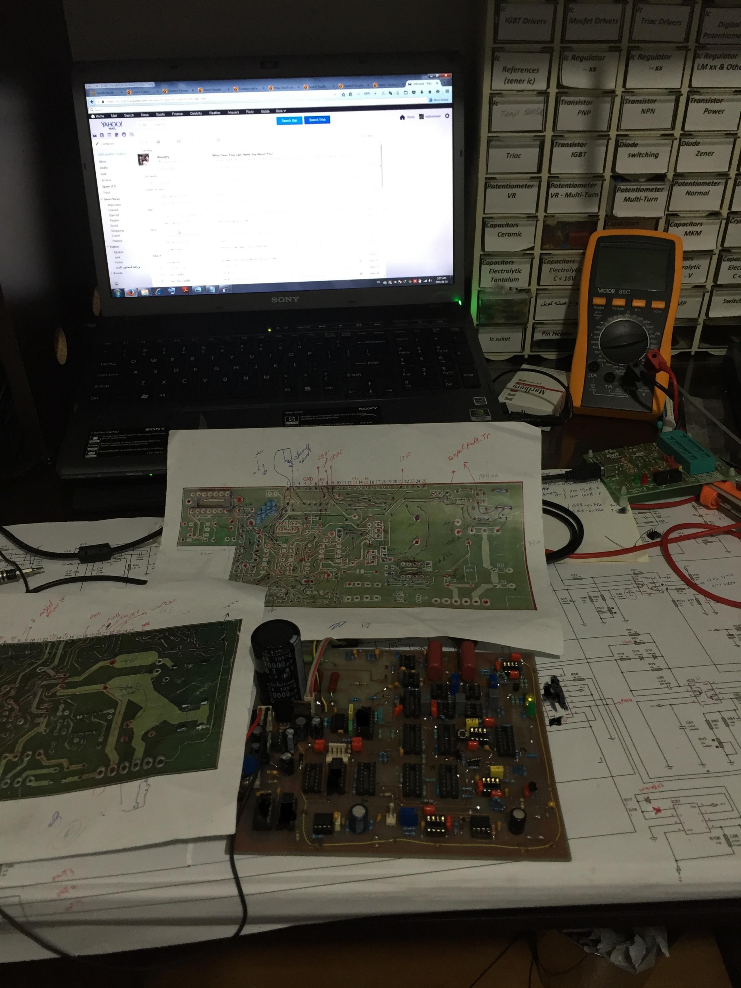

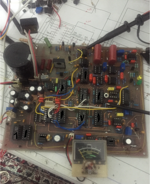

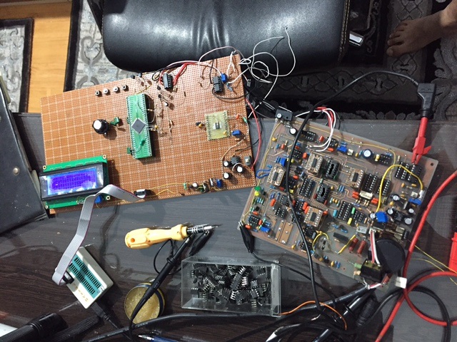

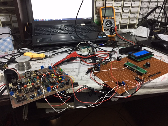

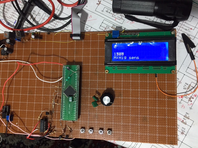

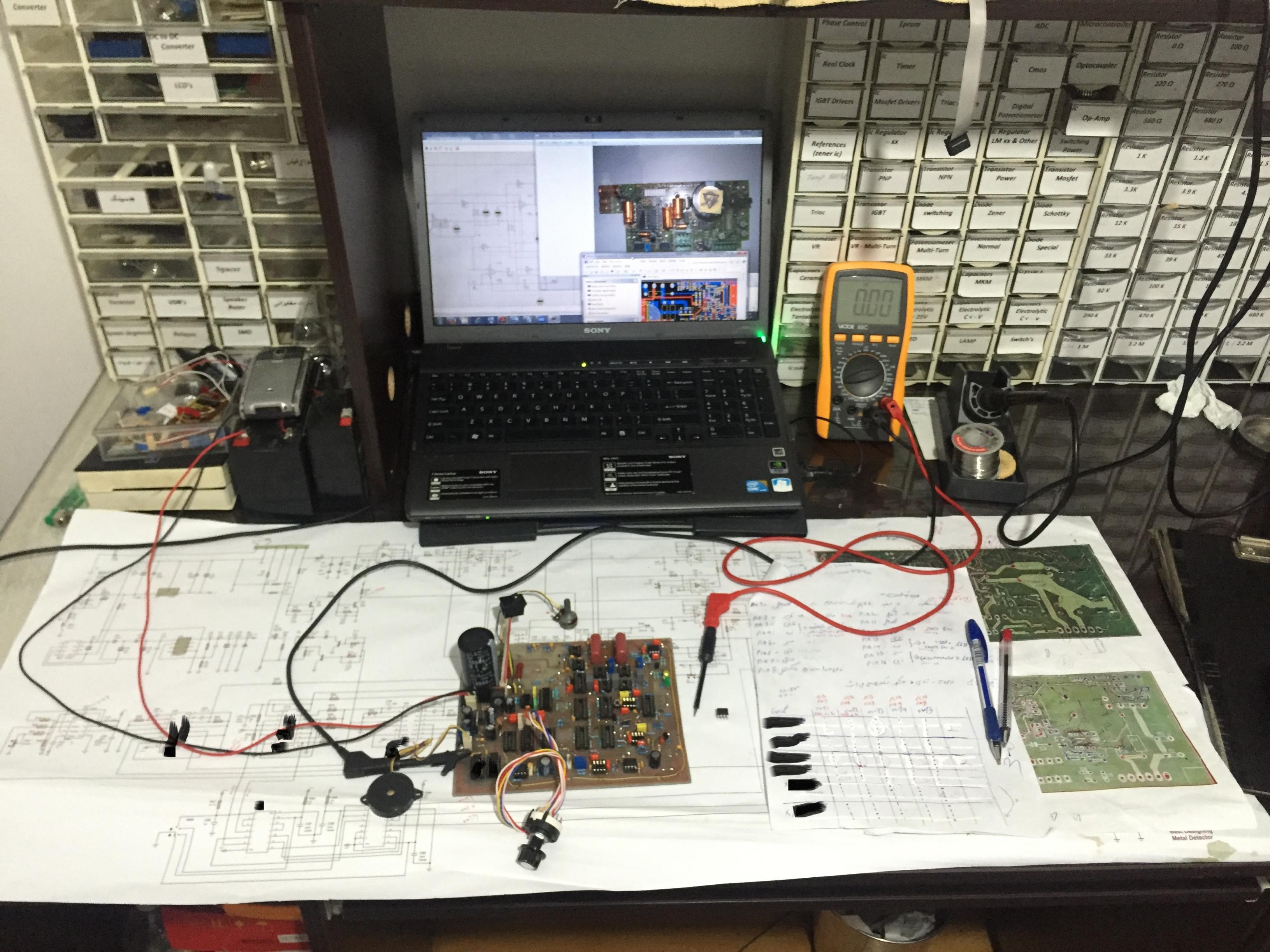

                        • hi all
                          i can make lorenz puls 5 of on the original electrical board.
                          this work is very hard because all part number ( ic and transistor and diod and ... ) was clear.
                          very difficult drawing circuit schematic because there 2 electronic board and was bilateral . but i succeeded draw schematic .
                          so over the schematic i got part number and i got Op-Amp number with accounts.
                          so i make new pcb designing wihh altium software and make pcb and assemble part .
                          im happy
                          my project is true .yes.my metal detector (( lorenz LP5)) is worked.
                          when my project to end in next level
                          i to obtain pulse time with oscilloscope for example i to understand mosfet pulse wait and mosfet pulse frequency so to obtain delay pulse and delay pulse wait and other pulse ..
                          so i make this pulse with atxmega64au micro controller and use ads1232 analog to digital converter .
                          very good projects
                          i am successful.
                          yes
                          in reality in next level i make lorenz deep max
                          im happy

                          • Well done.
                            Are planning to share the schematic with this forum?
                            • mee60 you might get good advice on the schematic, there are many smart people here, just give some material to think of.
                              So far lots of PCB pictures and no electrical schematic we've seen. There might be errors which are hard to find out alone.

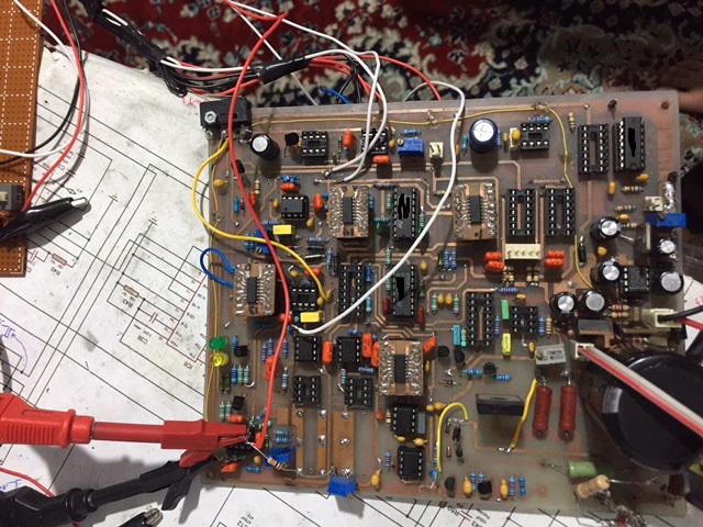

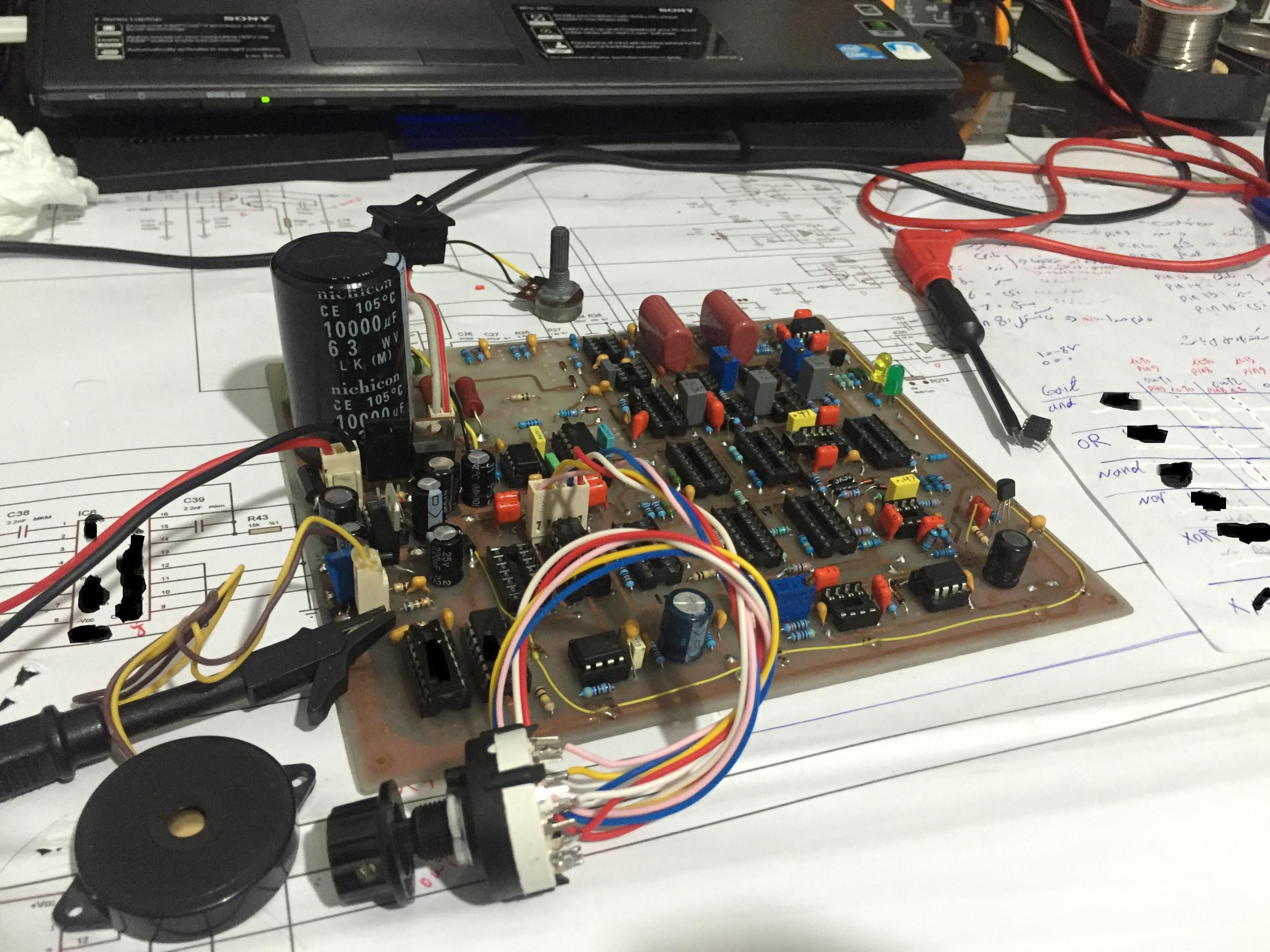

                                hi
                                im finished the lorenz lp 5 circuit alone. and someone in here not help me .
                                reading my old post .
                                i have very problem but alone to finish all problem.
                                but so i have one problem i dont no original lorenz coil , i need a original parameters lorenz coil (uH and Ohm)
                                i used 400Uh , 2 Ohm 45 and 35 cm mono coil , its good and not problem but i think a original parameters is beater . or pic of one the lorenz coil opened cover is very good.
                                tanx
