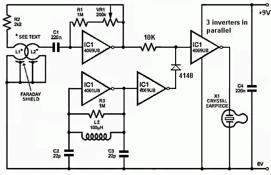

Hi mikbg. I am referring to post # 39 here on this subject and not the one "Popular Electronics, May. 1969". But there is no language barrier seems to do in the matter.This design has excellent sensitivity but for our purposes is the Eastern European shallow and not deep enough.In your opinion this design has flaws? Please give your suggestion and set the whole pattern.Originally posted by mikebg View PostMaikl, the circuit diagram of CCO MD attached in mentioned post # 39 has many disadvantages. They are described in that thread (post #48 etc). What frequency shows your AM radio?
Maikl, the schematic in post #39 here is TARSOS. You ask my opinion for TARSOS?Originally posted by maikl View PostHi mikbg. I am referring to post # 39 here on this subject and not the one "Popular Electronics, May. 1969". But there is no language barrier seems to do in the matter.This design has excellent sensitivity but for our purposes is the Eastern European shallow and not deep enough.In your opinion this design has flaws? Please give your suggestion and set the whole pattern.
Nabiul,Originally posted by nabiul View PostThe schematic in my first post. The one in post #12 is a beat balance detector, not the CCO.
The disadvantages of circuit diagram in post #1 are:
1. Too large supply voltage. If using HCMOS inverter (like HC04) instead 4069, the circuit can be powered by 2 x AA rechargeable cells (2.4V battery).
2. Negative feedback via R is too weak, so the input resistance of inverting amplifier is not zero. This decreases Q factor of tuned circuit L2-C1 and increases bandwidth, ie the preamp generates more noise.
3. The 500KHz operating frequency is too high.
4. The capacitance of the capacitor C2 is too large. You can increase the number of turns on L2 and this the sensitivity, if using smaller capacitance for C2.
5. IC1a is loaded unduly with DC current in operating point. Instead of R2 must be connected a capacitor.
6. Is not intended a control knob to adjust the sound frequency.
7. Is not intended to suppress the GND signal using a second RX coil, connected in series to R2.
8. Remains not used 3 inverters of IC1. They can be used to replace the action of IC2 and connected in parallel to IC1a to increase TX current.
Yes all those things are true and the circuit could be greatly improved, but I've already built it and I need to know how to fix it.

Nabiul, if your hobby is electronics, you should buy a ton of diodes 1N4148. They are very small and the most cheap diodes for signal processing.Originally posted by nabiul View PostIs that particular diode necessary or can it be any old diode? I've got a ton of 200v 3A diodes.
However I posted an idea only. Since for me this is a BAD CIRCUIT, my advice is to try something better, like HOUNDOG. Here is an idea for modernisation of HOUNDOG.Attached Files
Originally posted by mikebg View PostNabiul, if your hobby is electronics, you should buy a ton of diodes 1N4148. They are very small and the most cheap diodes for signal processing.

Patern Mikebg has small mistake (short-circuit between "lm" and "rg"). These dots near coils (L2A - L2B) will be inconvenient also.
After making on table this and you will hear connecting to some amplifier all, but not artefacts (money).
This requires the stable technique, wise PCB and a lot of time.
I think, that more quickly and cheap for You this to buy new, cheap MD Chinese and to test in terrain one's seeker's abilities.
