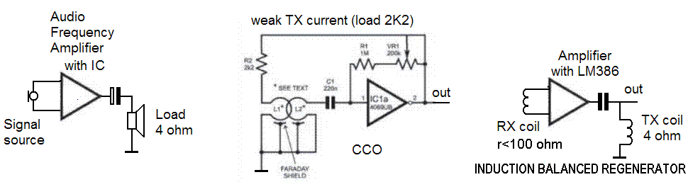

Concerning the principle of action, both circuit diagrams are so similar that it can be called "audio frequency amplifier" with regeneration (positive feedback).
View the following circuit diagrams and determine what IC should be used, CD4069 or LM386?Attached Files

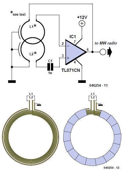

Here's a simple BFO of Scarborough:"Here's something completely different. I'm well known for my electronic designs, and here's one of the classics. It gives good performance and stability for a beat frequency operation (BFO) metal detector. BFO in itself, though, is not very sensitive -- yet it's easy and fun. This metal detector will pick up a 25 mm (1") diameter coin at 90 mm (31"). The design is based on a simple inverter oscillator, which is attached to a Medium Wave radio aerial. When metal is brought near to coil L1, the frequency of the oscillator changes, bringing about a shift in the difference frequency in the MW radio speaker. Solder the circuit and take a wire to the MW radio aerial as shown. This should be screened, with the screen going to -6V (negative). Switch on both metal detector and radio, and tune the radio until a clear heterodyne (a whistle) is heard in the speaker (some heterodynes will work better than others). There will be a "band of silence" at the centre of most heterodynes (a zero beat frequency), and depending which side of this zero beat frequency is tuned in, the tone in the radio speaker will rise or fall at the presence of metal. It will also respond differently to ferrous and non-ferrous metals." Signs of a single coil TX.Attached Files
In this dizaj between pin3 and pin4 (tl071) added identical coil it was CCO.Two TX coil.There is no TX and RX.Double BFO.The design is not fine if compared to the IB.But it's CCO.With the simplicity of it gives a lot.Attached Files

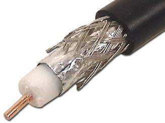

Hi nabiul.Of the coil unit to put the two coaxial cables(with one wire in the middle see photo).When you come near hand, micro-inductor L3 will be changed in the earpiece volume (but only in that place).Open and look at headphones, see what the impedance (is given in ohms and write on them).This type of metal detector has a sound discrimination.Pliers need to "see" other sound.A video on your detector does not "see" pliers.It is also an important direction of coil (change in one coil wire layout).There is no need to change C2 and C3.VR1 = 200K put it on the middle position then slowly move a coil until you hear high-pitched tone (this is where the fine-adjust the detector).This circuit elemenatacan withstand up to 15V voltage (add another battery).Attached Files
I wanted to use coaxial cables, but I don't think I have any right now. I have to check.
