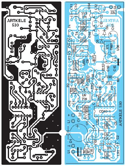

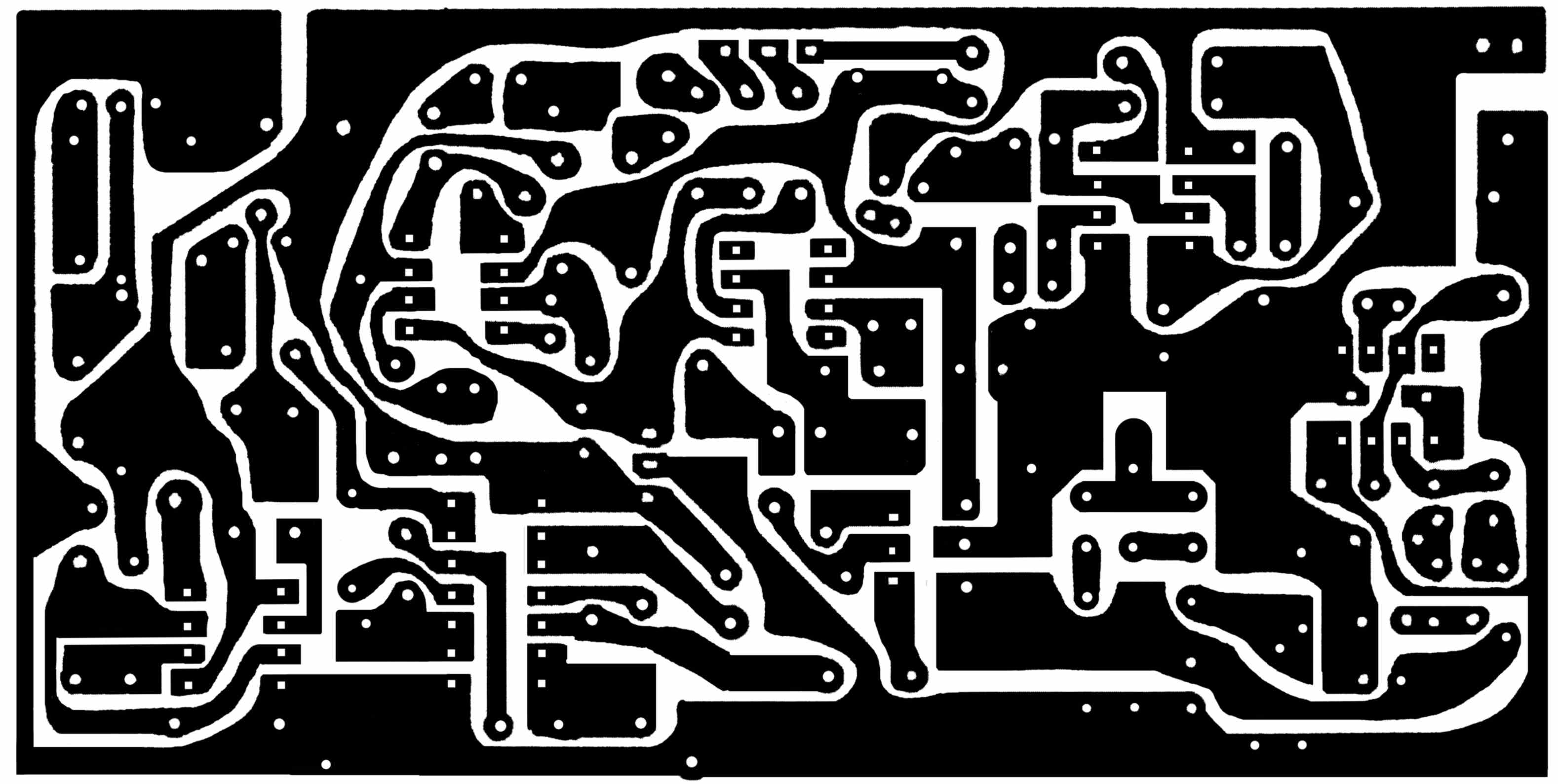

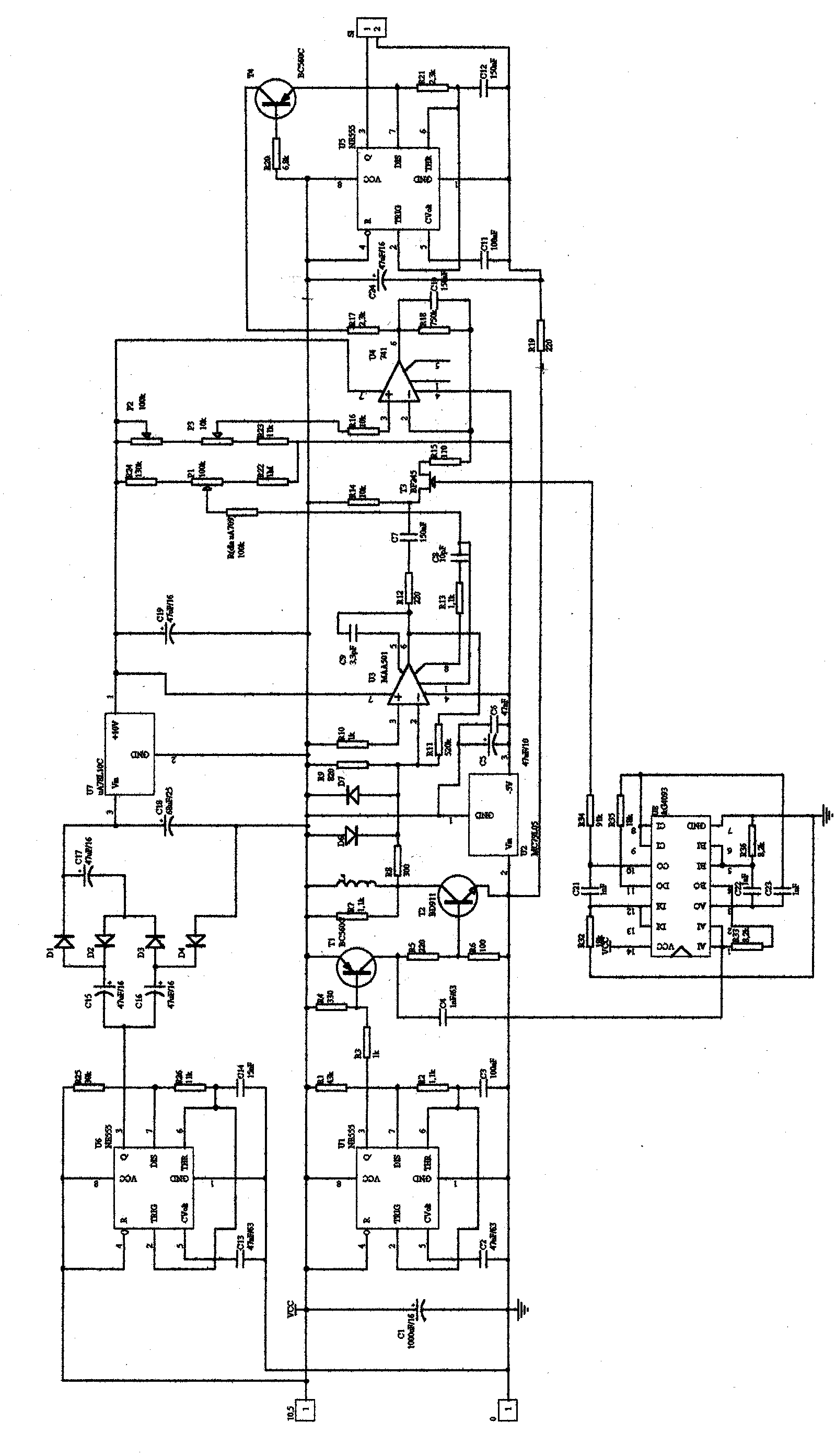

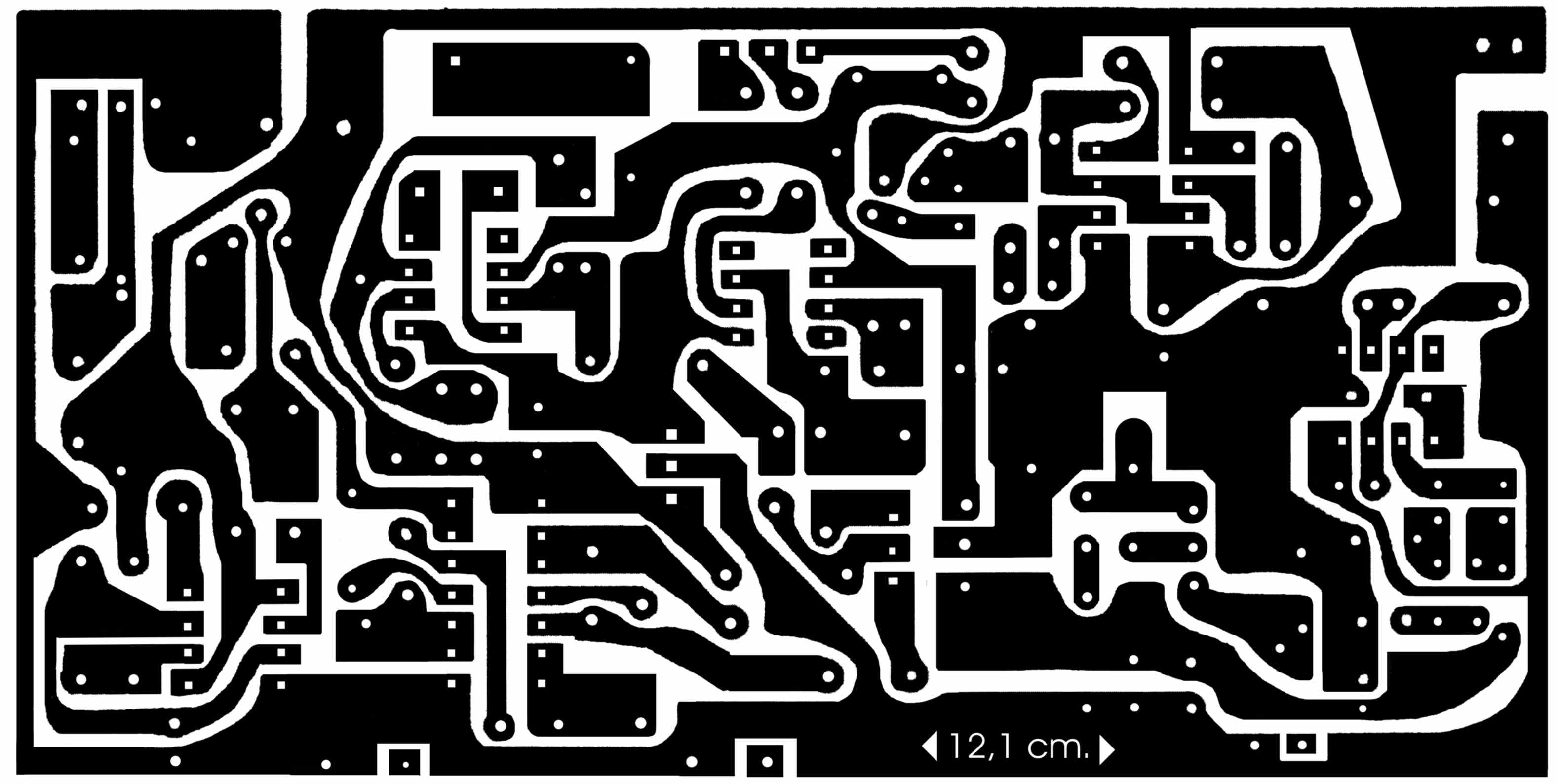

This cannot be simpler (even single coil is not needed):Originally posted by yhl View PostWho is Gary pulse. Single coil circuitry and PCB. I need more production tutorials / I need a simpler, the betterAttached Files

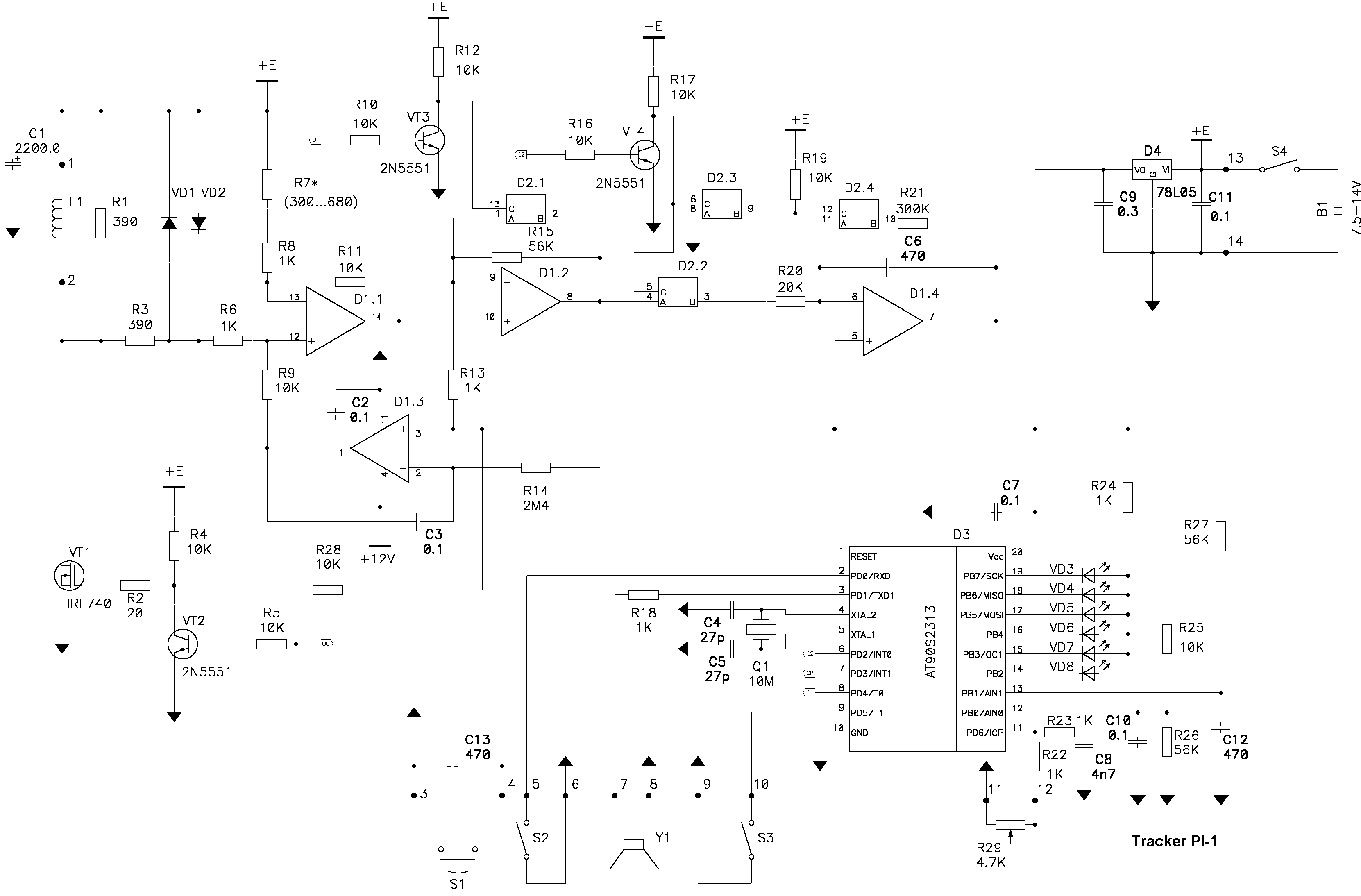

the simplest PI is Tracker-PI. only 3 (THREE) IC packs:
1. ATMEL
2. TL074
3. CD4066
THAT"S ALL BUDDY WM6!
beside maybe 78L05
