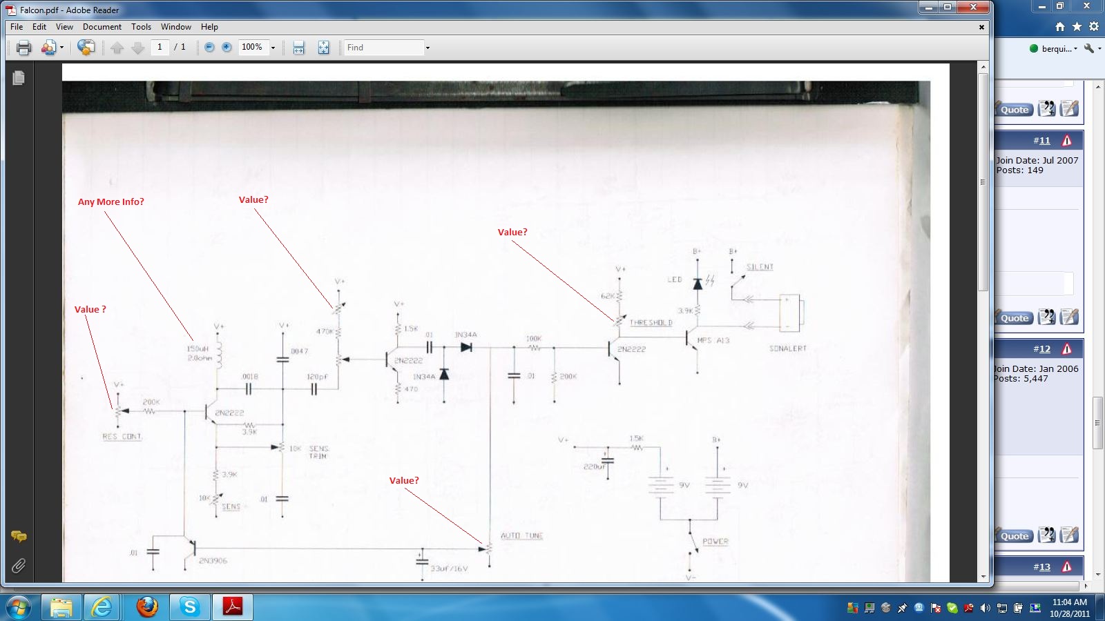

    Does anyone have any more Info on the Falcon?
    Looking for some values here.
    Thank You!
      OK! it nothing more then a Modified Colpit Osc but how is it doing the detection?
      Were in the circuit is it pulling off the freq offset?

        It should be easy enough to figure out the values of the potentiometers, just by trying "obvious" values & tracing the signal, but don't expect it to work any better than an old Studfinder
          It's not a BFO or frequency shift detector. The colpits osc is set so that any non ferrous metal close to the inductor causes a change (loading) in amplitude. The buffer amp(2N2222) and 1N34 diodes form an AM demodulator or Rectifier for the sine wave. The change in DC voltage is used to set off the buzzer. The only difference between this and the average stud finder. Is that some of the DC voltage is fed back to the osc to maintain the bias voltage on the base of osc transistor. "Automatic Ground Balance"
          Google "Loaded Loop Detector" they were widely used to sense cars at traffic lights.
          I have the original unit and will measure the pots tommorow and post.
            In old days, this configuration is called "ALL" or Amplitude Locked Loop. Rectifier and feedback will maintain constant oscillator amplitude at some point, loading the LC tank will change that control signal and this is detected as a target response. Probably worst way to detect metal. Very long time ago, similar circuits, but in GHz range is used for motion detectors in alarm systems, but due to RF interference, abandoned whit mobile phone introduction. Anyway, don't spend too much time on this one.

                    Here are the values for the pots and trimmers. This is for the MD 8, current model is MD 20. The probe is a 3/8" ferrite core probably 20 to 40 turns of AWG 32? These must be good for something, I believe mine is from the 1980's
                      WoW! Thank You Sir!

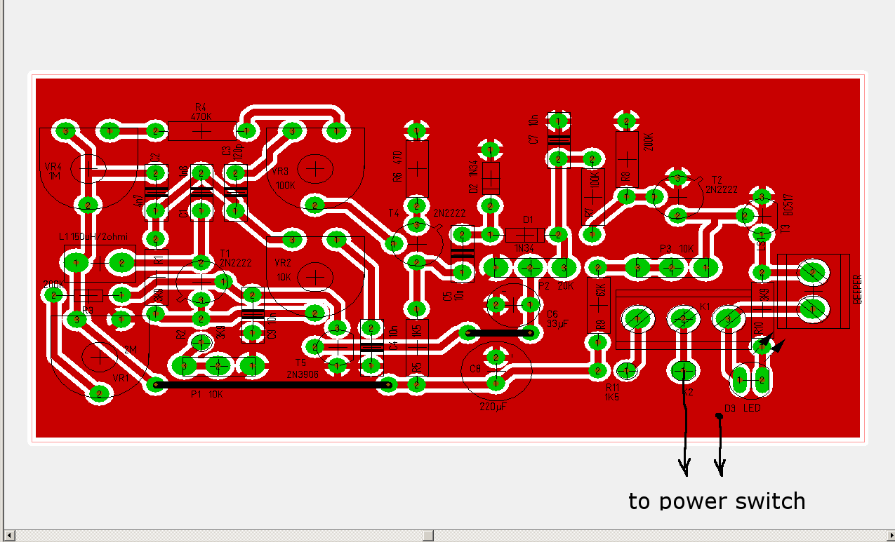

                            If anybody has developed a PCB layout for the schematic that was made available in this thread, would you please post it.
                            I am gathering components to build this project and have never successfully used a PCB layout design program.

                              Just an idea without silent switch.Click image for larger version
                                Thank you, I have been trying with DipTrace but my board looks like crap compared to yours.
