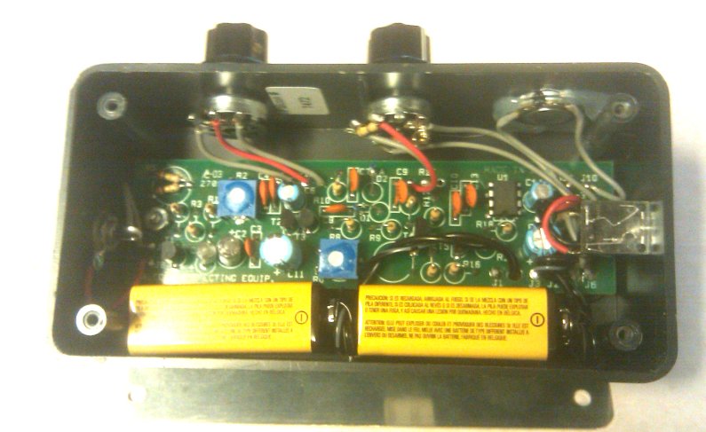

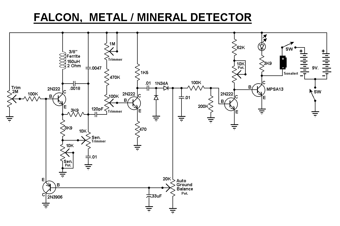

    It would be easy to make a schematic from the pcb (reverse engineering) but we need the components values.
    • #47
      Noro did mean new version, with NE555.
      Thanks - I didn't realise there was a newer version.
      That's all I have anyway.

          Apparently there's a newer version that includes a 555 timer.

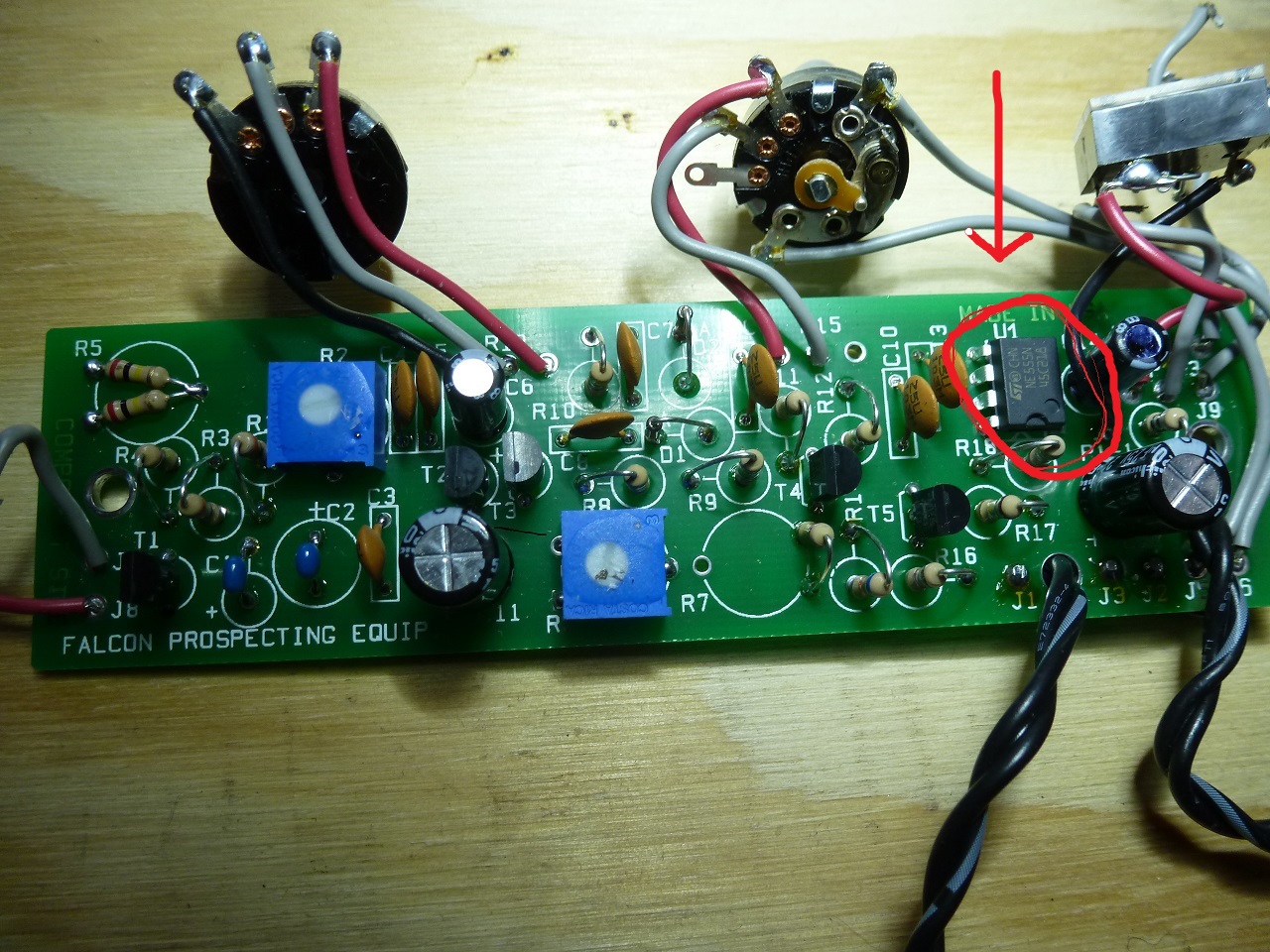

            Thank you for your help everyone.
            Qiaozhi, the picture appears a 4-pin chip.
            jtz54 it says it is 555 or similar (written 555 shown in picture).
            I suppose it is a VCO 555
            We begin with the first version and will communicate the results ... I hope to getClick image for larger version

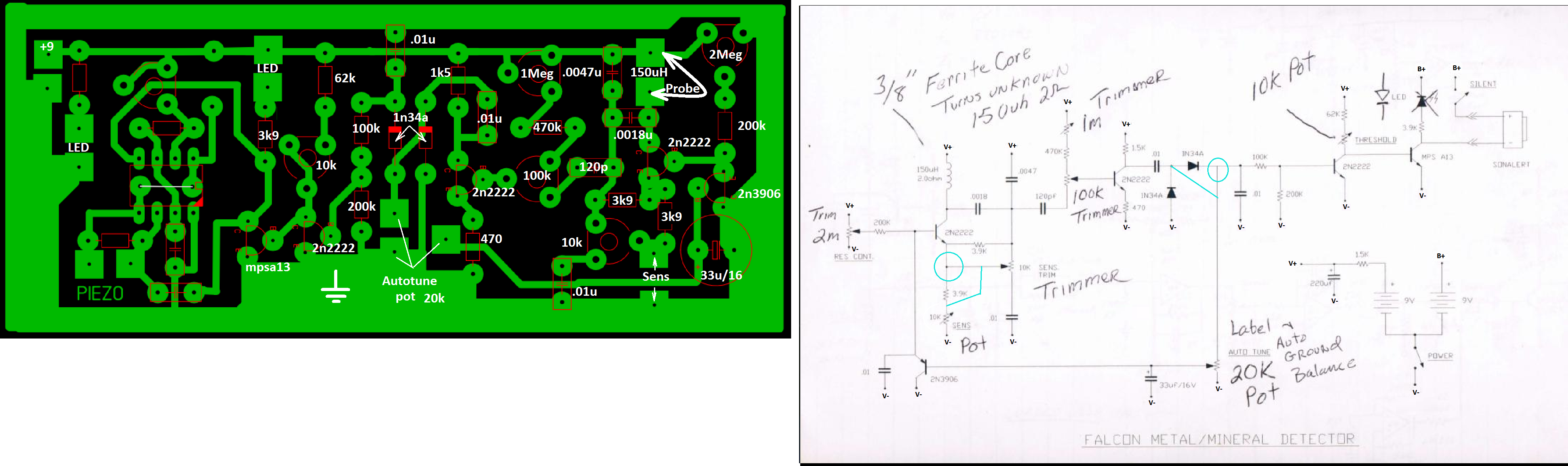

                      • #56
Name:	Old and new.png
ID:	343649Check for mistakes
                        • #57
                          tnx Thomas ! yes i have mistakes in lay.

                            I have built this with a hand laid out board using Thomas's as a template but using SMD resistors and capacitors does anyone have an alignment procedure template.
                            Regards, Ian.
                            • #59
                              Hi Ian,
                              Think there may be a few hints on these three pages. But no real alignment setup described. I do vaguely remember some talk of a copper collar being involved, probably on some other site.
                              • #60
                                Hi greylourie, yes I have read all that is here I have waveforms but no audio but without an alignment procedure I have no idea where all the trimmers should be set to I will worry about the copper band when I get the unit working.
                                Regards, Ian.
