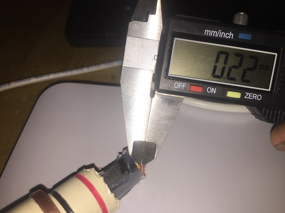

    Think it´s 0.20mm wire, showing 0.22mm.
    Its hard to measure so tiny wire when i cant grab it so good.
    Need to calculate the coil winding now, not my best skill. But there is plenty calculator for it, but i dont know how to enter the information to get it to show 140 or 150uh and the resistance at about 2ohm
    Somebody know how to make the search coil?

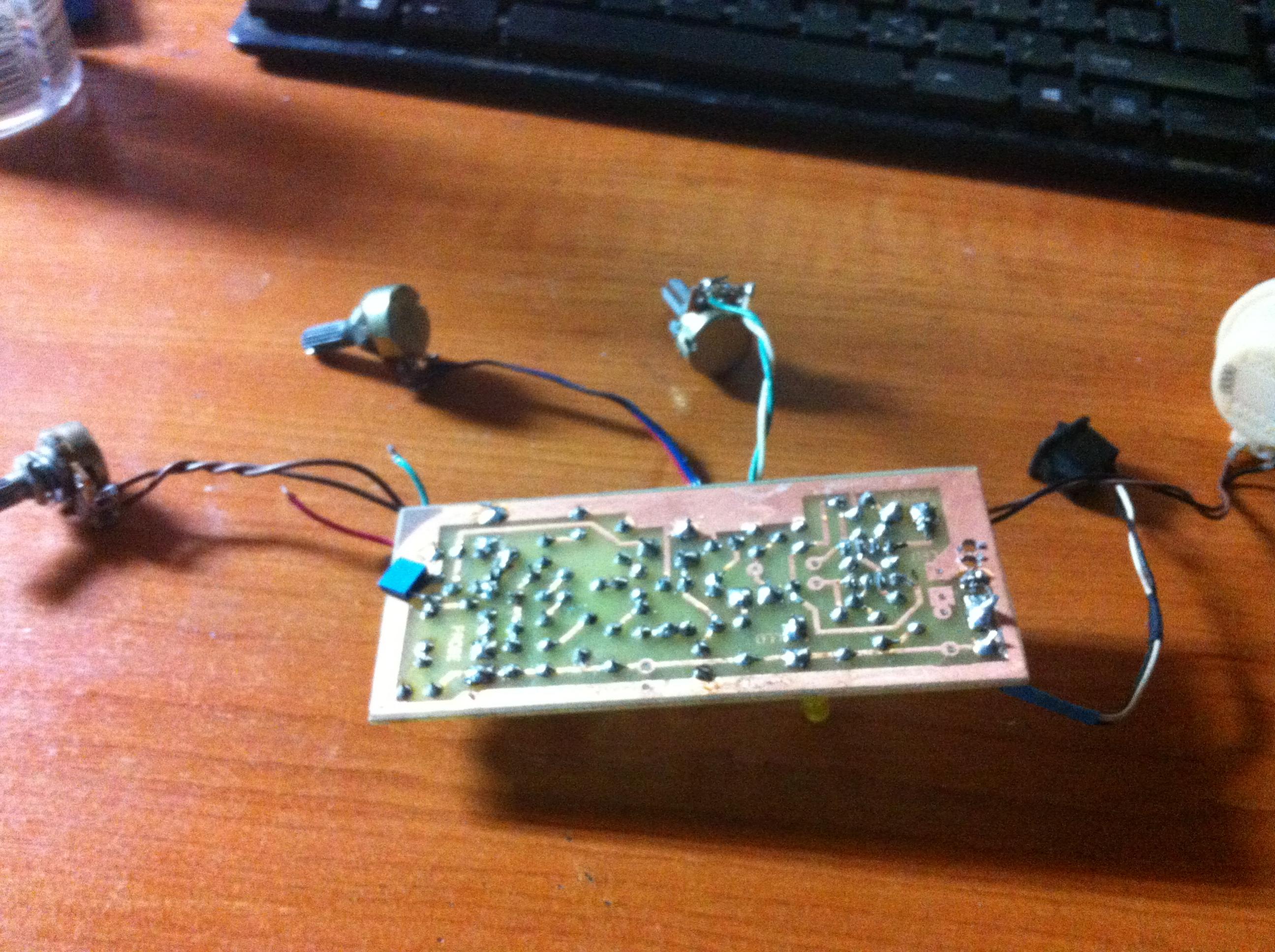

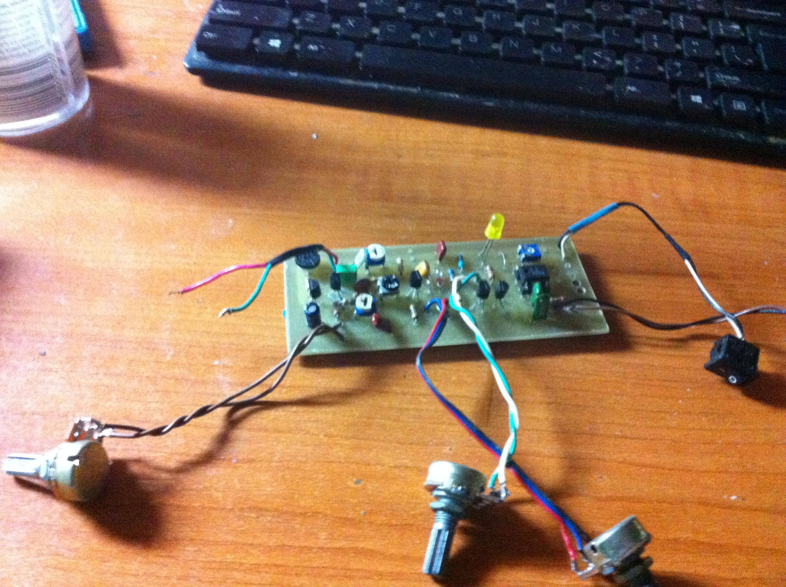

                    • This is photo of MD falcon test ,Friiman your coil is shelted in tinker cooper foil ? tnx for photo!Click image for larger version
ID:	344443Click image for larger version
                      • Originally posted by Noro View Post
                        This is photo of MD falcon test ,Friiman your coil is shelted in tinker cooper foil ? tnx for photo![ATTACH]34863[/ATTACH][ATTACH]34864[/ATTACH]

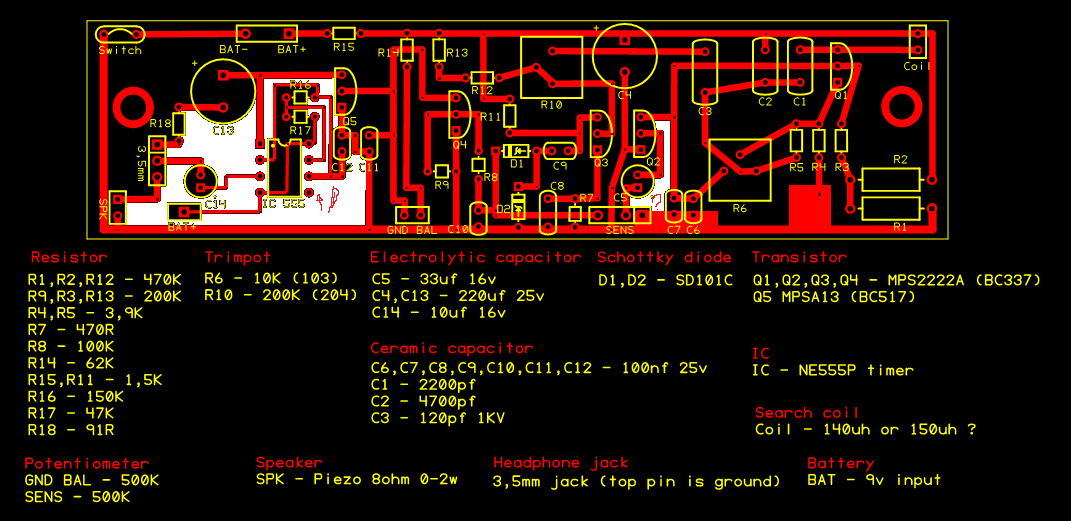

                        Yes Noro it's shelted in some copper foil. Is the pcb image of your md falcon design?
                        I have tested winding some coils and i am almost there with the count of winding.
                        Anybody know if a resistor in the pcb with a different tolerance will be a bad choice. I have tested resistors with 1% tolerance and 5% on the prototype pcb. What can be different with other tolerance?

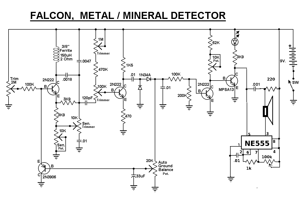

                        • Friiman you have a schematic? because i I suppose my schematic is wrong.Regard Noro.(
                          it does not fit for this forum schematic)Click image for larger version
                            it does not fit for this forum schematic)[ATTACH]34865[/ATTACH]
                            I posted it earlier in this thread.
                            • for example pin of 5 of ci 555 is free but in your schematic is galvanic coupled to colector Q5!
                              C5 33 micro in schematic is couple to ground, but in pcb is coupling to sensibiliti potentiometerClick image for larger version

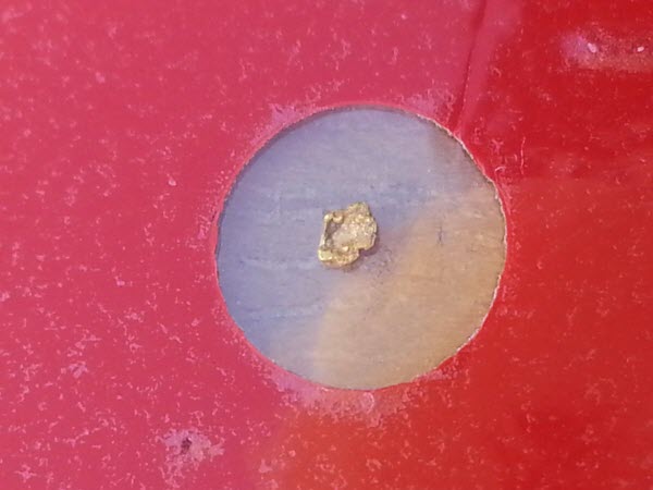

                              • The Falcon MD20 is extremely simple and depth is ridiculous, yet my first ever gold nugget was found using this device. It was on the slate bedrock of a ditch next to a primary deposit (gold-bearing arsenopyrite in quartz - Teleno peak - León - Spain).
                                Working principle: mineral or a metallic objects near the ferrite head change its inductance which causes a change in the amplitude of a Colpitt's oscillator. This kind of oscillator varies its amplitude with frequency. Metals increase the frequency and decrease the amplitude, minerals do the opposite. The waveform is then rectified and used to modulate a buzzer.
                                Because this machine has its well defined niche in locating superficial small gold and gold specks embedded in rock, I've decided to build my own version with the following (radical) modifications.
                                - Vackar oscillator at 400 MHz (amplitude is rather constant with frequency)
                                - Frequency counter based on ATtiny85.
                                It will work by continously measuring the frequency and comparing it to a sliding-window time-average. The MCU can be used to produce a sound indication (wavetable) and/or visual indication.
                                Will keep you posted.
