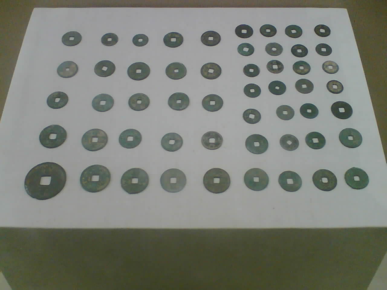

    我完成了我的一部分 I finished my part of the Gary PI MD
    Congratulations yhl.
    Are coin findings on last picture yours, done by Gary PI, or out from local museum?

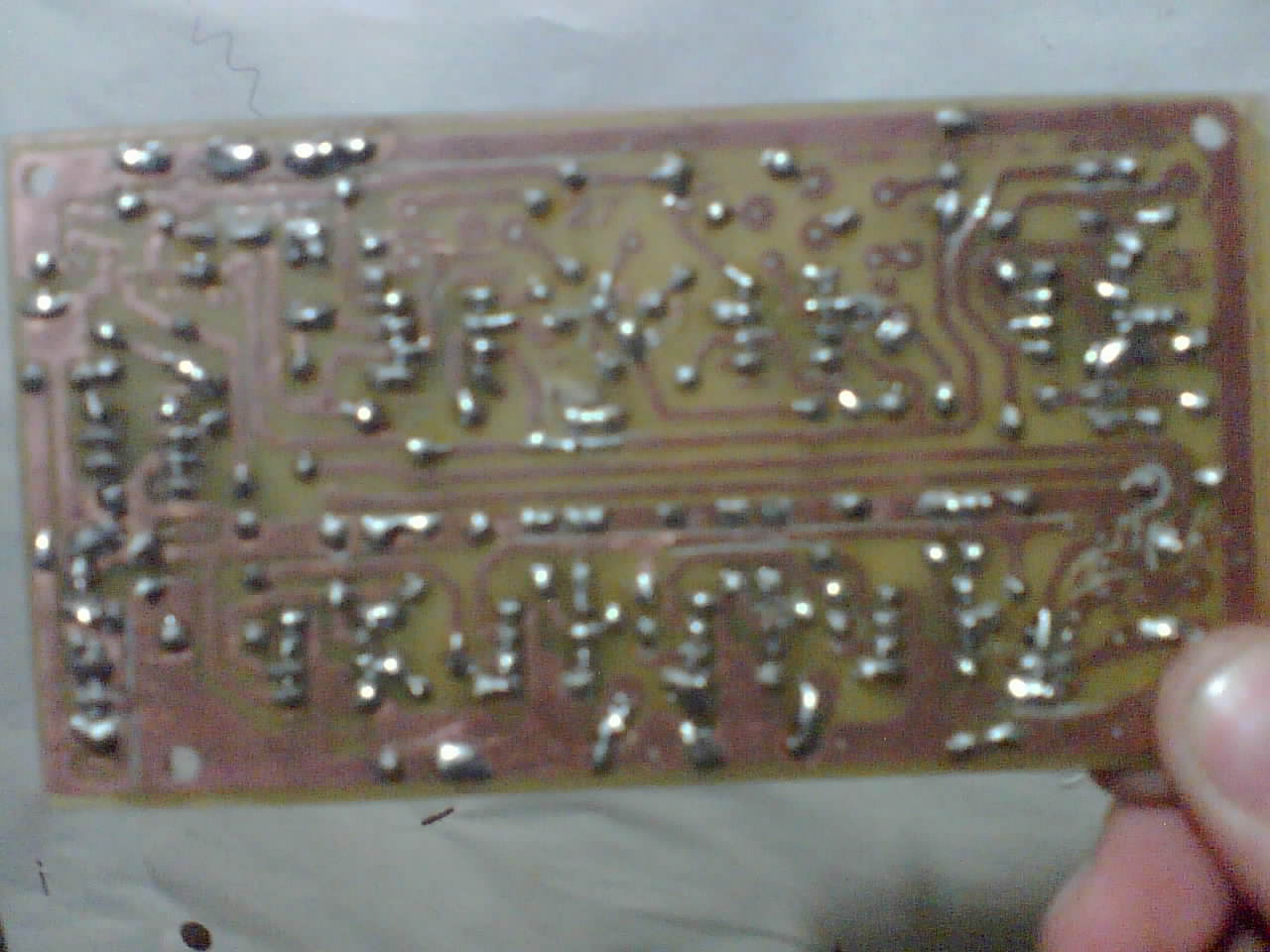

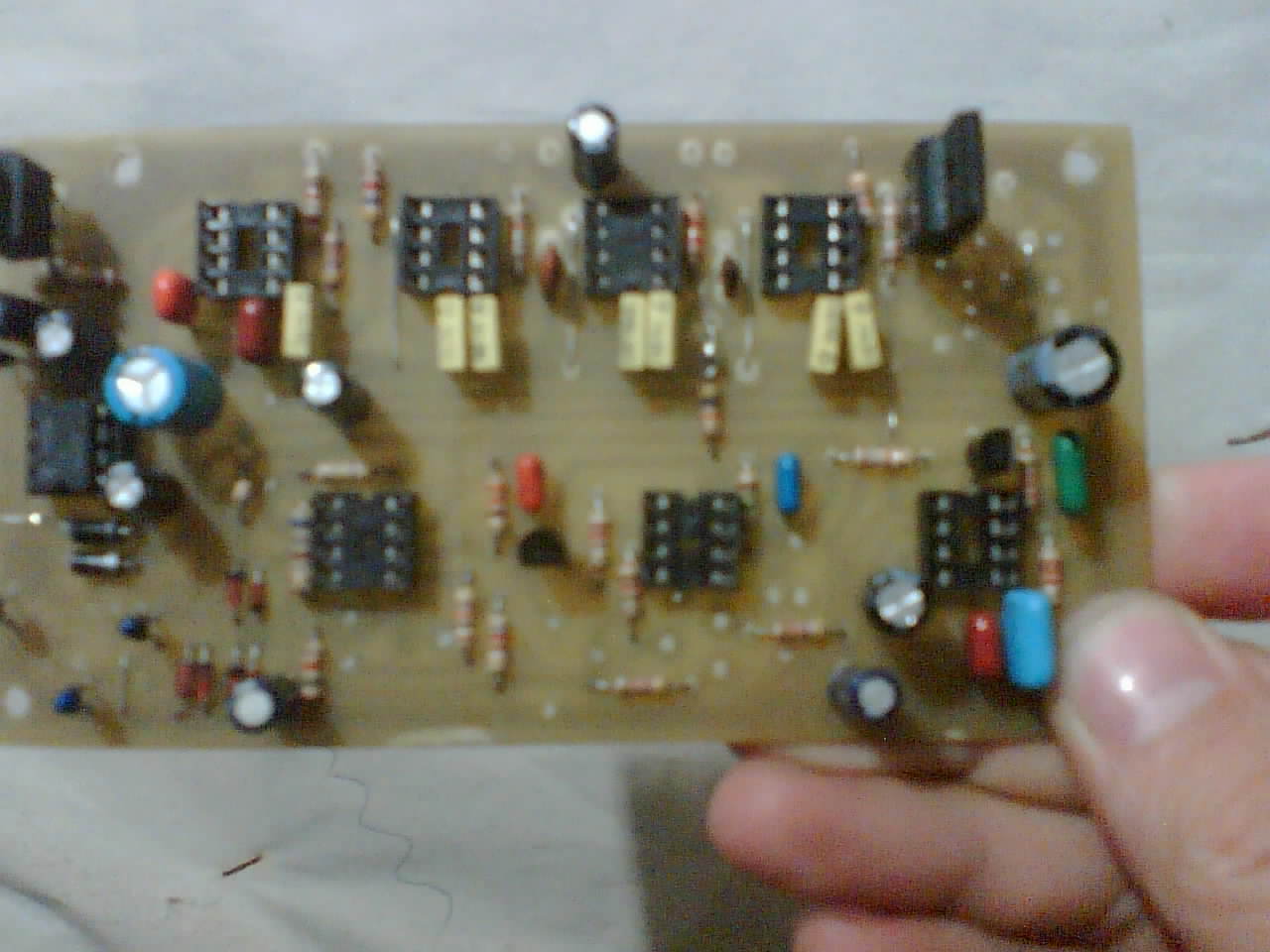

        Need help
        I do a circuit. But not enough depth detection / 2.5CM coins only 10CM.
        Circuit the total current only 55 mA. If there are problems?
        Points are normal voltage

                        But the current of the circuit is the work of only 55 mA. Each voltage is normal. Electronic parts no problem.
                          I want to know
                          I could try to build a coil. I just want to ask why the current only 55 mA under?
                          Q1 IRF740. I used the 6N60 replaced. Parameters of the same
                            LOOK
                            [Help] display IRF840 What could be better than the tube?
                            IRF840 500V 8A 125W NMOS field effect transistor can be substituted with a common 6N60
                              I agree. The quiescent current seems to be on the low side. Maybe the TX pulse width is too small or you need to increase the frequency. I would recheck the component values in the TX driver circuit.
