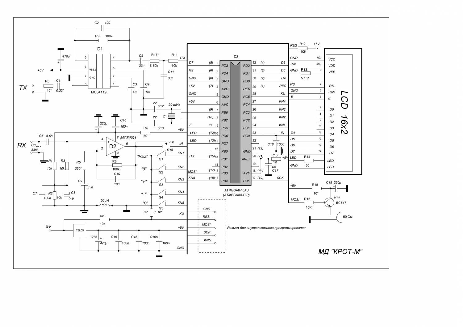

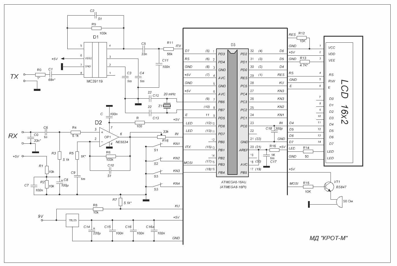

    schematic
    all information on a site of author http://radiodom.ucoz.ru/index/selekt...ot_m_quot/0-14
    video http://depositfiles.com/files/fjxclgtbx
      Some technical data (regarding author):
      - IB type detector,
      - working frequency selectable from 4 to 12 kHz (coil have to be tunned to selected Freq.)
      - multi-tone ID
      - supply 7-9V
      - consumption 50mA
      - discriminative
      - visual display
      - suggested/tested coil 20cm (CC type with RX and TX coil tunned in resonance)
      - sensitivity in air test: 25mm (1") coin at 30cm (12") distance
        Hi
        Anyone here built this detector ?
        The circuit Ive posted uses a MC34119, cheapest price I can find is £15.00, MCP601 is only £3.53, got everything else in stock.
        Looked at a video file on the site and either it doesn't do it justice or theres instability problems and needs further work.
        Would help if I could understand Russian.
          It seems there is no means for measuring TX phase to use as reference. If the TX tank is anywhere near its resonance, where it's reasonably efficient to drive, shifts in its inductance due to ground conditions will shift the TX phase, regardless of fixed tx drive. Air tests would likely not reveal this?

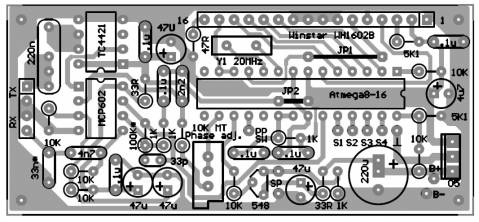

            Anyone here attach the PCB please, or PM-me,because on the author's site there is no PCB Plate
            thanks
              http://radiodom.ucoz.ru/Plata_krot-new1.lay
                Which size is the PCB plate for printing??? in cm or inches...
                thanks
                  you can find the right printing sizes if you take the atmega ic socket for controll the scale
                  or the pi n connector for lcd most 2,54mm distance pin to pin
                    I did give a direct link on LAY file. let him upload SPRINT LAYOUT 6 from the net and in the soft he can measure what he want easely.

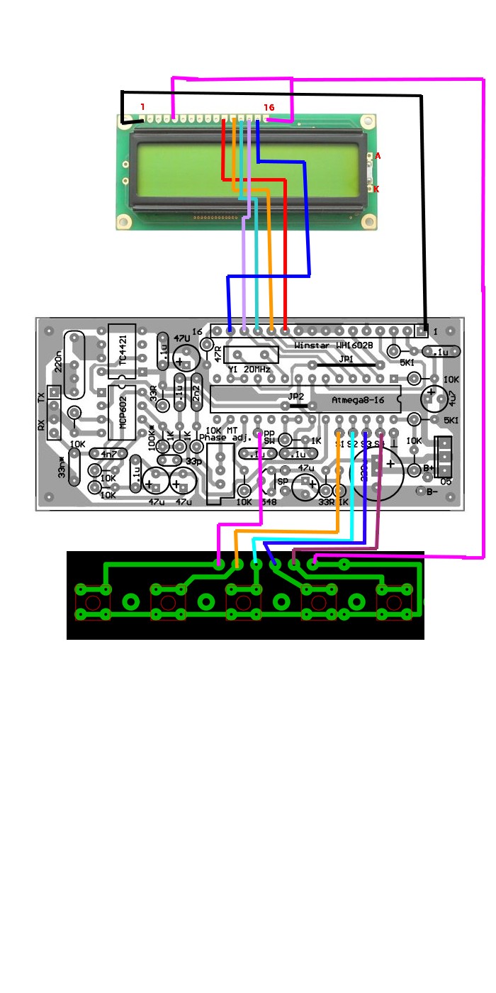

                      I built this scheme. It is practically the same and it does not work, I think my connections to lcd are wrong. The detector makes noise when I press a button and the LCD is illuminated 3 seconds and no letters.
                      pcb file upload I have used, do not hold me responsible if inoperative.
                      If anyone can help I would appreciate.

                        Originally posted by Virdi_248 View Post
                        [ATTACH]32446[/ATTACH]I built this scheme. It is practically the same and it does not work, I think my connections to lcd are wrong. The detector makes noise when I press a button and the LCD is illuminated 3 seconds and no letters.
                        Image with connections to lcd.
                          Originally posted by The-Force View Post
                          [ATTACH]32447[/ATTACH]
                          Thank you very much. Modificare the circuit right now, tomorrow I comment. Thank you very much again.
                            It did not work, I'll build another from 0. Spoiled several integrated or maybe the lcd.

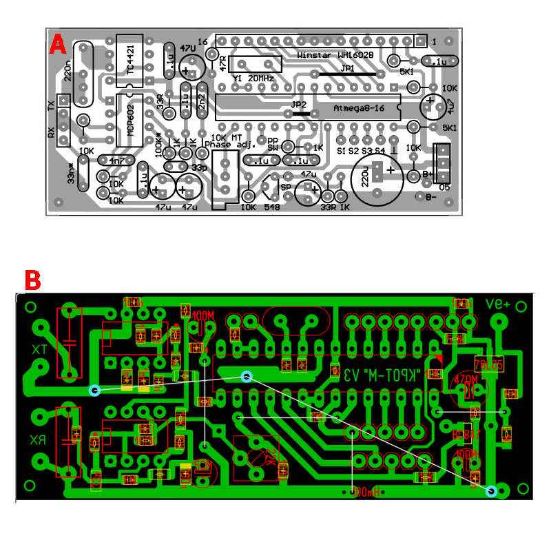

                            which is the pcb of your circuit?
                            Image A or B?
