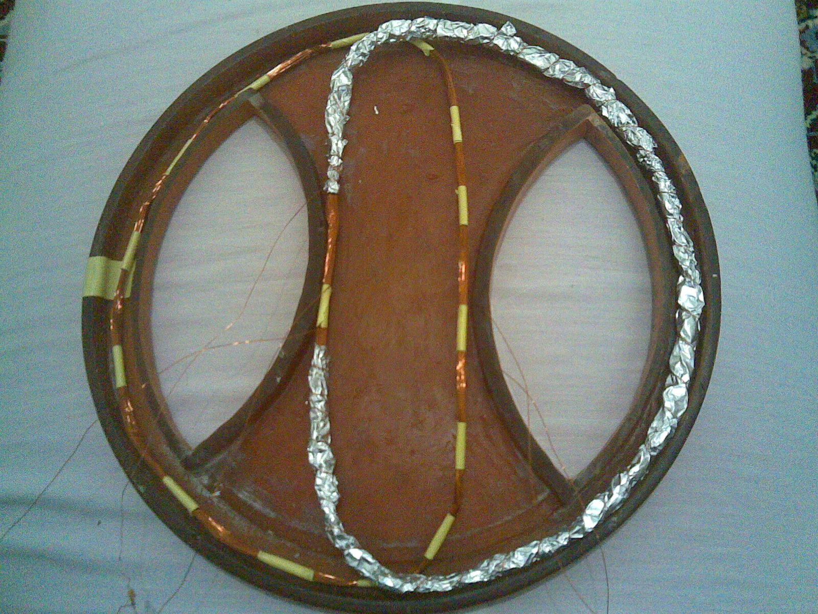

                    my coil picture:
                      Originally posted by mehdi View Post
                      my coil picture:
                      Mehdi,
                      Nulling and tuning is what we must do next. My guess is that you have way too much overlap on your coils.

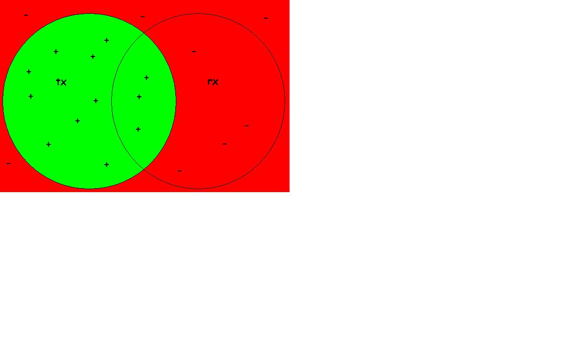

                      First, grasp your coil with your right hand, palm upward with your thumb extending in the direction of your Tx coil winding and your fingers wrapped around the coil. (Right hand rule). Your thumb represents the flow of current at some instant in time. The rest of your fingers represent magnetic flux at the same instant in time. Now notice that the magnetic flux (or your fingers) goes UP in the middle and DOWN on the sides.
                      The attached diagram may help as well. The green area would represent the magnetic flux going in one direction and the red will be the other. Notice that the Rx coil see both.
                      This is greatly simplified, but will help to illustrate.
                      If you position your RX coil overlapping in just the right spot, it sees magnetic flux going UP AND DOWN and the net signal is ZERO. So this will be the NULL point and hence IB Induction balance) - Little or no Tx signal induced in the RX coil and you will have a minimal residual signal from U1a Pin 1. You will want to move your coils around while monitoring pin 1 to achieve a good null. This can be done with a DVM on the AC setting.
                      Also, see the excellent article by Carl on coil types that may help you understand as well.
                      Once you null your coils we can work on tuning. Assuming that your tuning in not too far off to begin with, this should be easy.

                          Monitor pin #1 on U1a With a Voltmeter on the AC setting. With your coils just barely overlapping, move them closer together little by little. You will find a point where the Voltage will "dip" or "null" .. maybe 4mV will be the minimum. This is the point where you achieve induction balance. Next, if your coils are tuned, the area of your null will be very small.. less than 1mm!!
