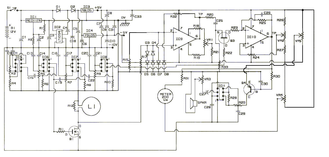

    I created a Gary pulse 1, hoping to get your help. I changed the 2N3819, but the circuit is detected low. I already have two pieces of the same circuit board, they generally work the same.
    I set the IC9, 0. 5 V
    YOU say, Connect a Voltmeter to Pin 6 of IC9 and Note the Voltage Reading, Now Bring a large piece of metal Near the coil, and this voltage should go Higher [Possibly up to 2 Volts.)
    I Now Bring a large piece of metal Near the coil, only 0.7 volts
      I am now using a 2N3819.
        Maybe a Poor Coil?

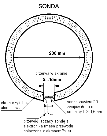

          I was only 0. 5MM line. This parameter can it?
            First, I Don't understand the Language on your Drawing.
            What is 0.5MM line?
            Your Wire Size?
            0.5mm is about 24 AWG
            0.3mm is Even Smaller. But Not sure why that is on the Picture.
            And If that is what your using, its a Bit Small.
            I Recommend 20 to 22 AWG.
            Why Did you make a Shielded Coil?
            I Don't recommend a shielded coil on my detector.
            At least Not for General Detecting.
              hi
              Yes I know. This picture is I found. I have a folder, you can see.
              What is a Polish website.
              I did not do the coil, I just made a 0.8 mm. 30 laps. 28 cm of the common coil.
              http://www.elektroda.pl/rtvforum/topic1056104.html

                Flat coil is difficult to build, you have no easy coil parameters?
                  This makes a fairly good coil.
                  http://www3.telus.net/chemelec/Proje...l/New-Coil.jpg
