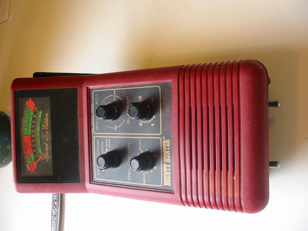

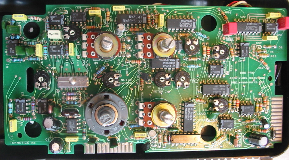

    Here are some pics of the board from my Teknetics Big Bud Pro SE. Please note that my board has some damage where someone used too long of mounting screw and it went straight through the board. I bought it in non-working condition because of that, but it works fine now. I thought I would post as it might be helpful to someone. No, I don't have a schematic. It's on my "to do" list. Too many projects, not enough time.

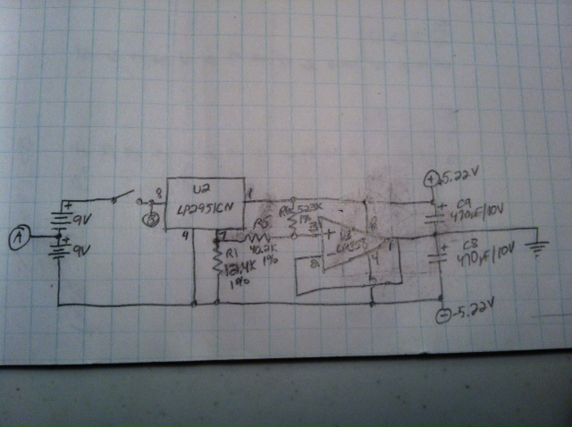

      Big Bud Pro SE Power Supply
      Here is a quick sketch of the power supply of my Big Bud Pro SE.
        Bud Pro schematic
          Thank you very much Reg. Now I can put my Big Bud Pro back together.

              It does appear to be a different model. From what I can tell, the Bid Bud Pro and Big Bud Pro SE are VERY similar, but not identical. The power supply is the same approach, but a lower voltage on the SE.

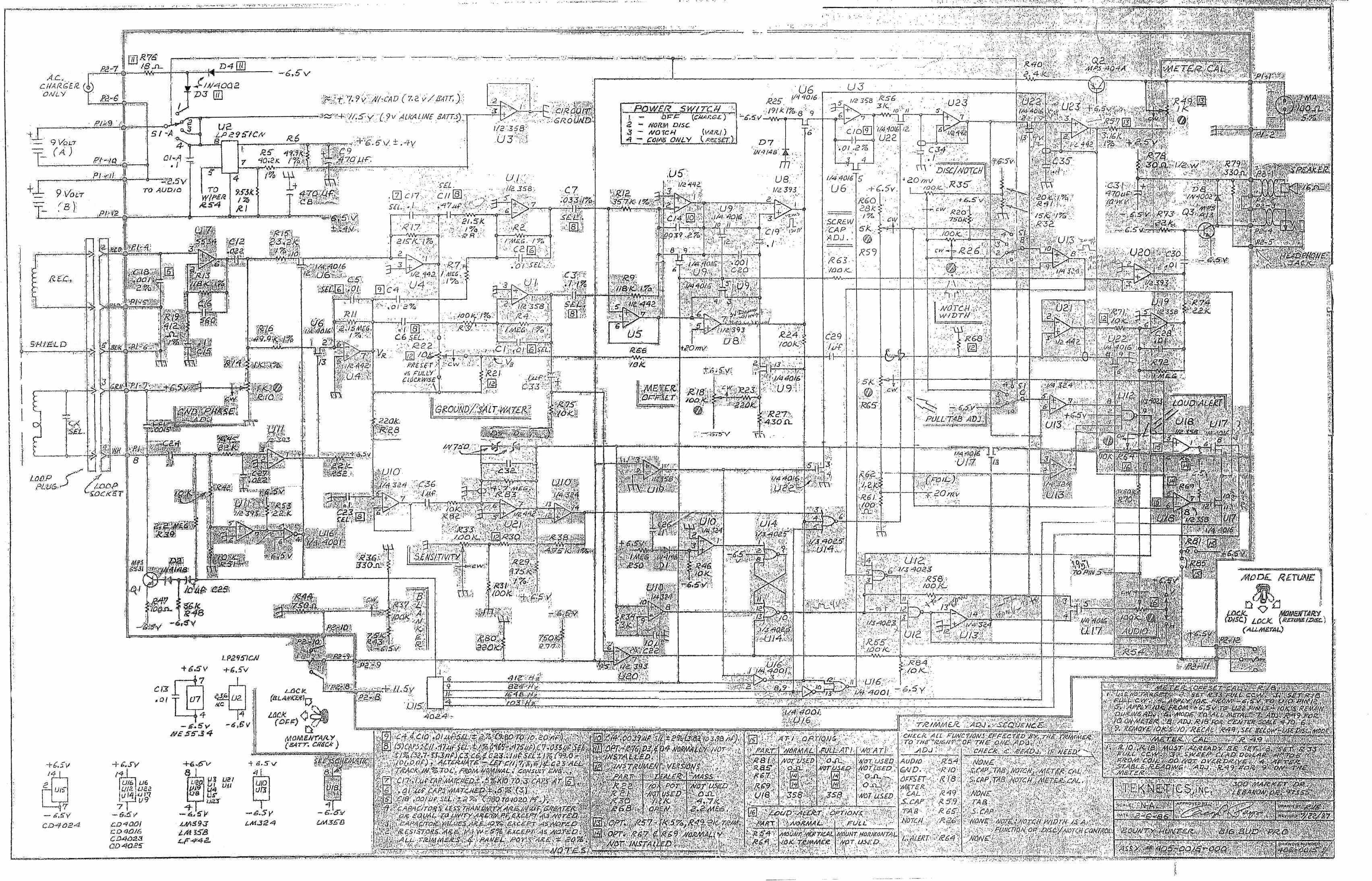

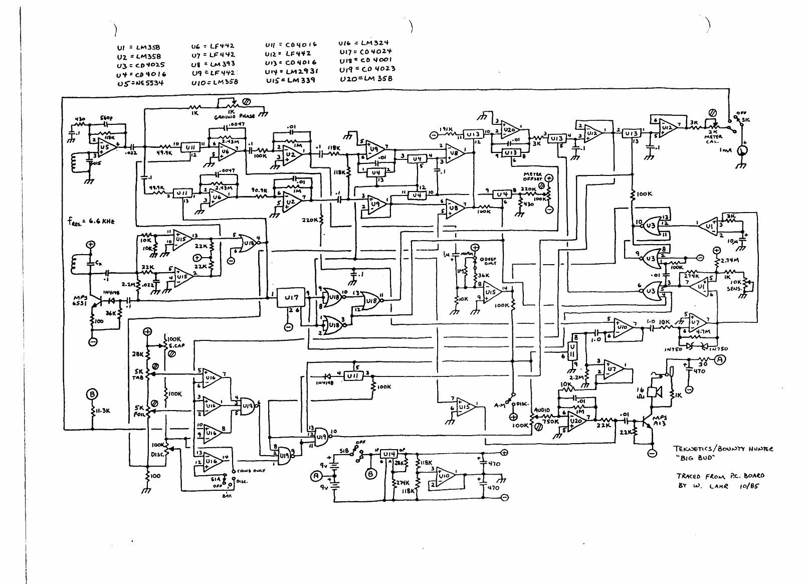

                It would be interesting to draw out the SE unit, and view its changes circuit by circuit, right agains the Big Bud schematic that Reg provided. Then compare it with the Russian Narod schematic. Of course the Russian Narod schematic was not really Russian, but was a schematic of the Big Bud drawn out by William Lahr, formerly of Whites Electronics in the past, in the year 1985. I am going to post it right here, so that others will have it for its information. Lahr was known for having very accurate schematics...
                The earlier Big Bud detector had a fixed 3" deep blanker circuit. I am going to clarify that a bit, as you can see in the Lahr schematic, at U15 where it mentions "norm" for "normal", it is not in blanking mode. When you switch it to "deep", which is away from "+Volts", it is in a fixed 3" deep blanking mode.

                  The Bid Bud Pro SE that I have I found listed for sale on a forum in non-working condition. I patched a #6 screw sized hole in the PCB and replaced one busted diode and it sprang to life. I got an extra complete rod and a 10 inch coil with it so I asked the guy where the other detector was. It had quit working and he had thrown it away. So sad.

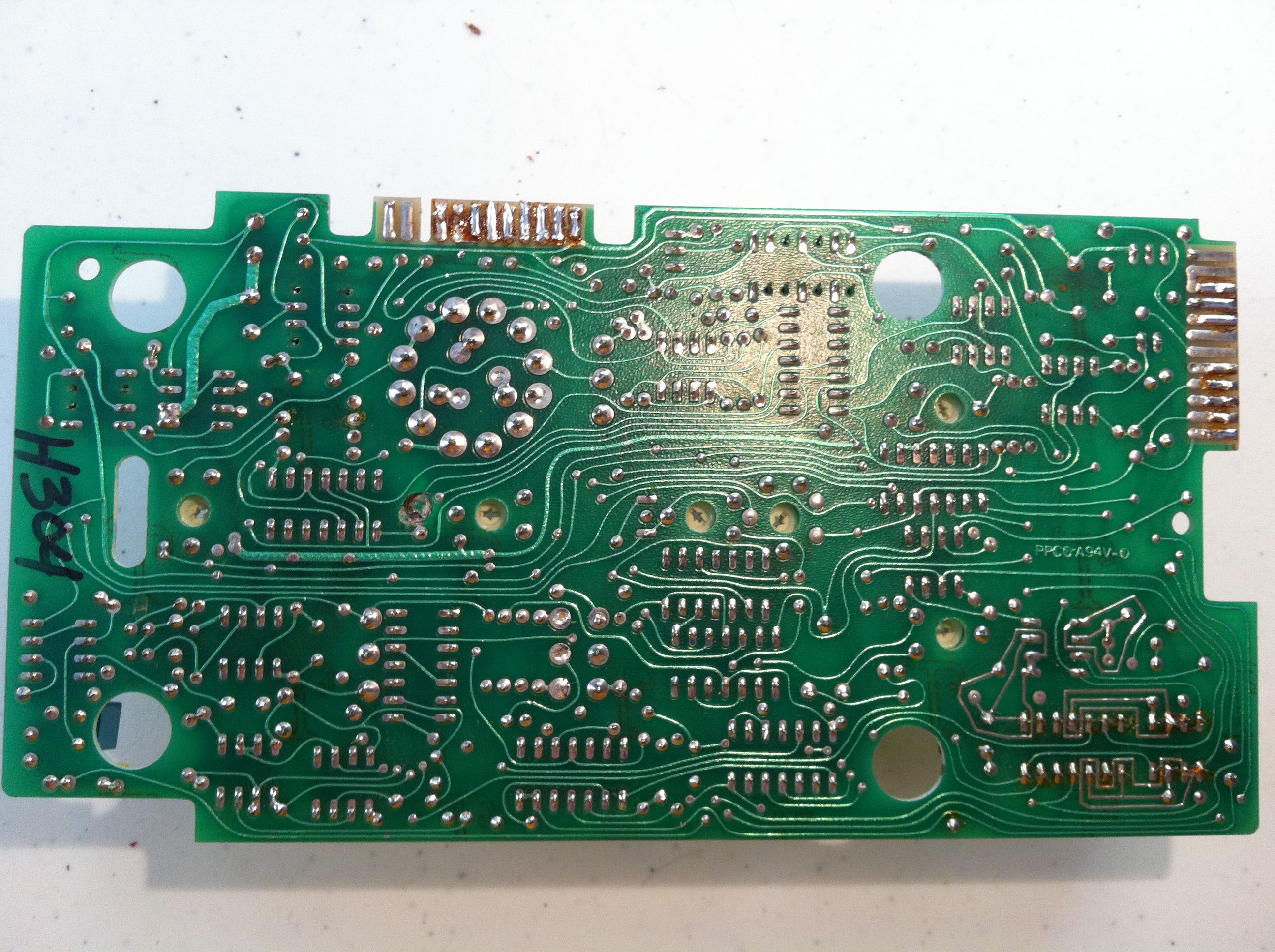

                    More Pix
                    Thanks Merc for sharing and Reg ,,,god bless. I too only had Bill's drawing. The factory circuit is a Gem.

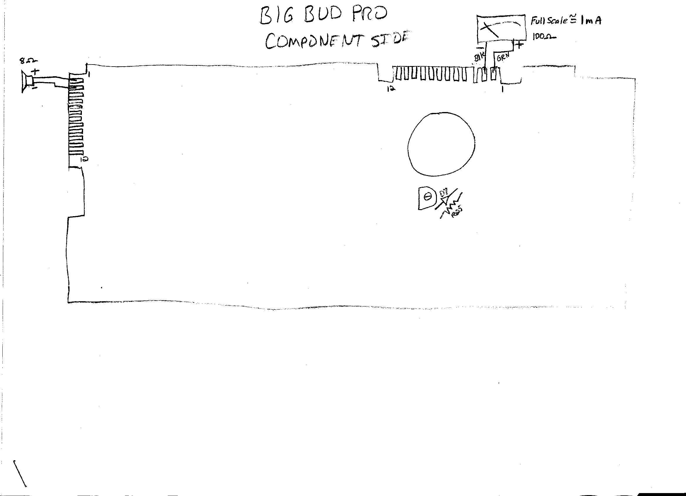

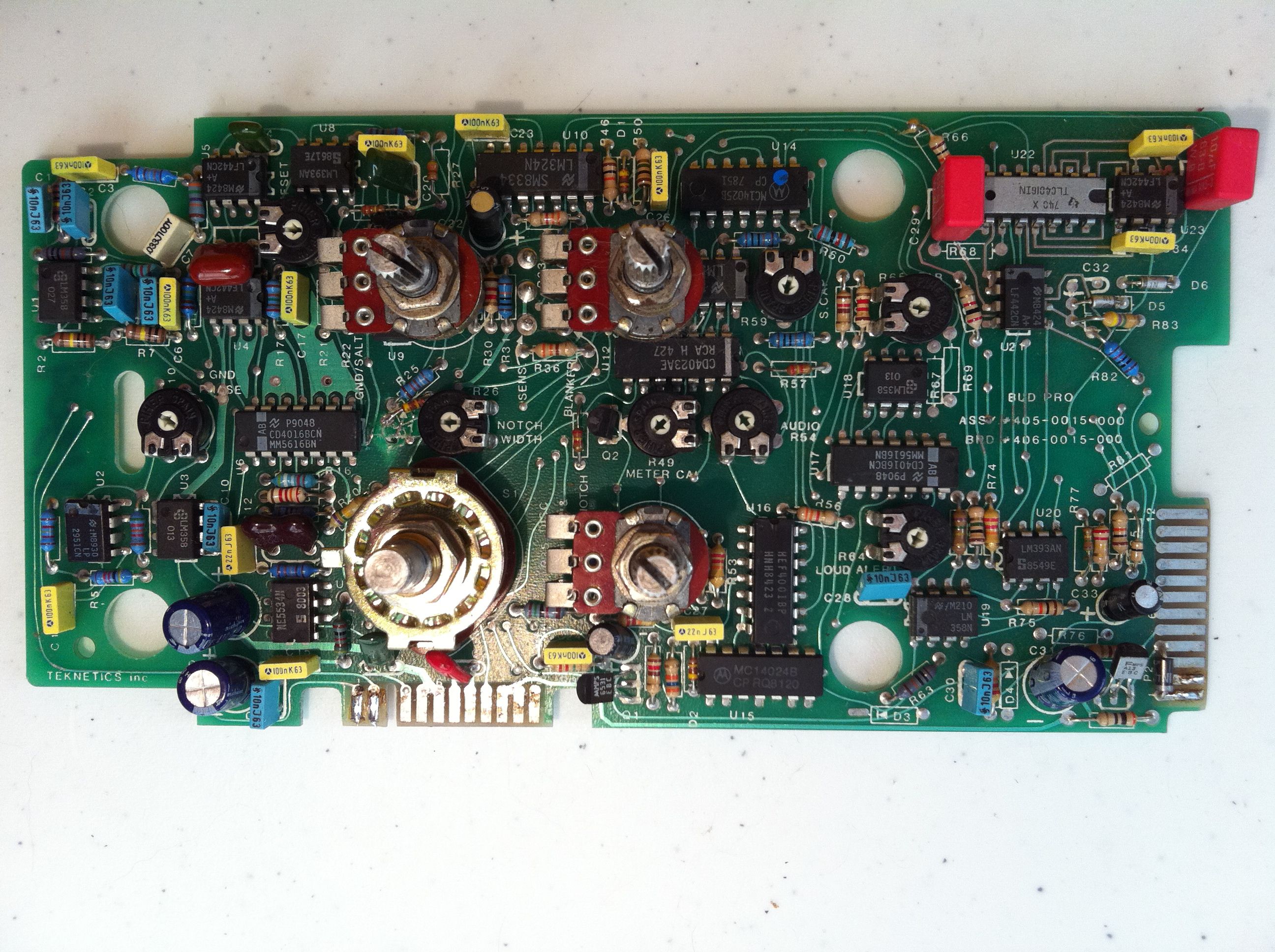

                    It's always fun to share board pix for comparison. Note that my BBPro SE PCB is a bit different. U6 on my board is masked and also has a ?temp? device attached. Least thats what I assumed it was. Can someone please tell me what that is? Mine also has an external Sensitivity pot wired to the back of the board. Maybe they all did and yours was just removed for some reason. I dunno. Probably other differences too.
                    Anyways too cool guys. Thanks again for sharing.
                    Phil M
                      Missed your wirements attachment on first read-through Merc. I see now that they all had the external Sens control.
                      Still like to know what that weird thing is attached to U6 on mine is though. Anyone know?
                        I think it may have been a crude attempt at shielding that IC from outside interference.
                        Merc
                          Turtlebowl, I notice in your pics there is no solder on the PCB edge connectors. Does your BBPro SE have connectors to slide onto the PCB? Mine just has wires soldered directly to those contacts.
                          Merc
                            Wires??
                            Mine is remote control!
                            I wish. No Merc, I wish I could say it did have edge connectors. I must have wire braided the pads prior to reassembly.
                            Another thing that always interests me when comparing boards is the date codes on the chips. Its amazing the span of years,,,,, Your board has chips that span from 1980 to 1990.
                            Your explanation on my U6 makes good sense. Thanks Merc.

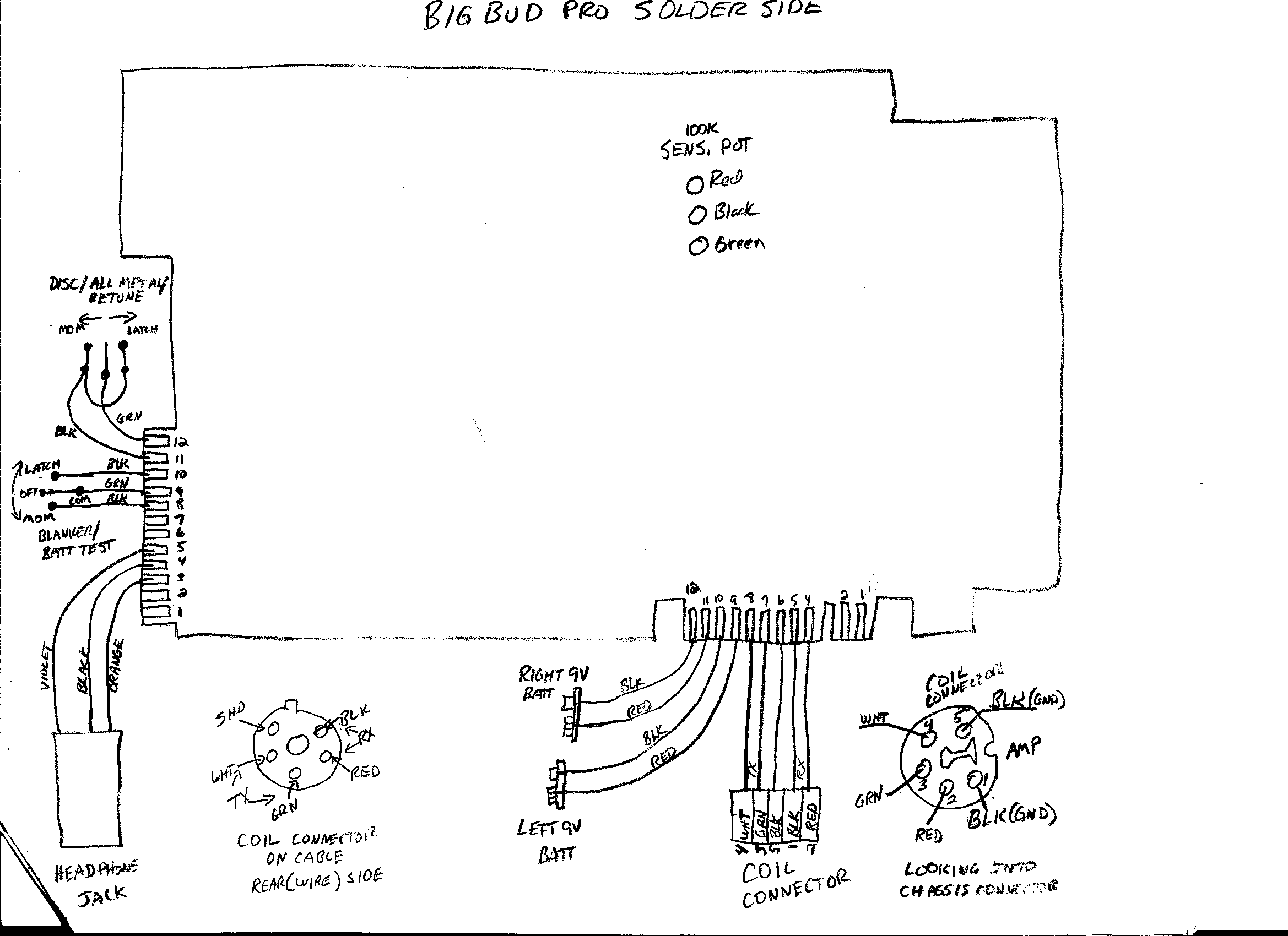

                              I'm working on cleaning-up the schematic posted by Reg. Blue prints do not scan well. Here is the progress so far.
                              Merc
