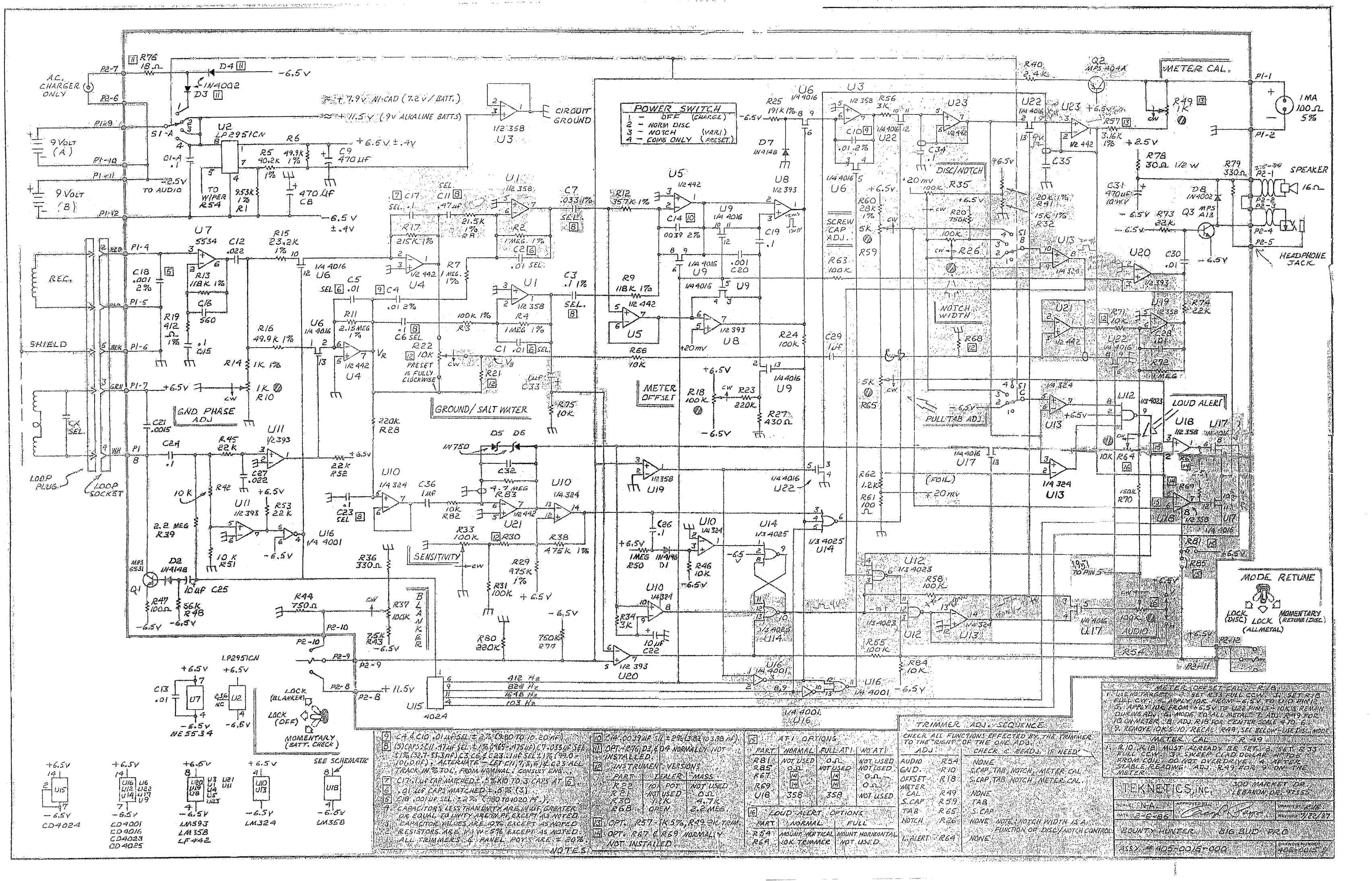

        I'm working on cleaning-up the schematic posted by Reg. Blue prints do not scan well. Here is the progress so far.
        Merc
        I had also started to clean up the schematic during an idle period, but you are much further ahead. Glad I didn't spend too much time on it!
          Perhaps in the future we could divide one into four quarters and each clean up a section. It's possible but I wonder how good it would look when put back together. I'm using Gimp to clean this one.

            Thanks Merc for posting the schematic. I traced my Big Bud 220 Select and drew the schematic in sections but still had a few things missing when I went to draw them together. This will be some help as I can see the circuit is almost identical. The 220 is a newer detector but for some reason they went back to a zener diode connected to a pass transistor for the regulator. The ground reference is created the same way with the 358 and voltage divider. It has a little more circuitry than the SE because the ID and depth meters are separate. I hope to be posting it soon.

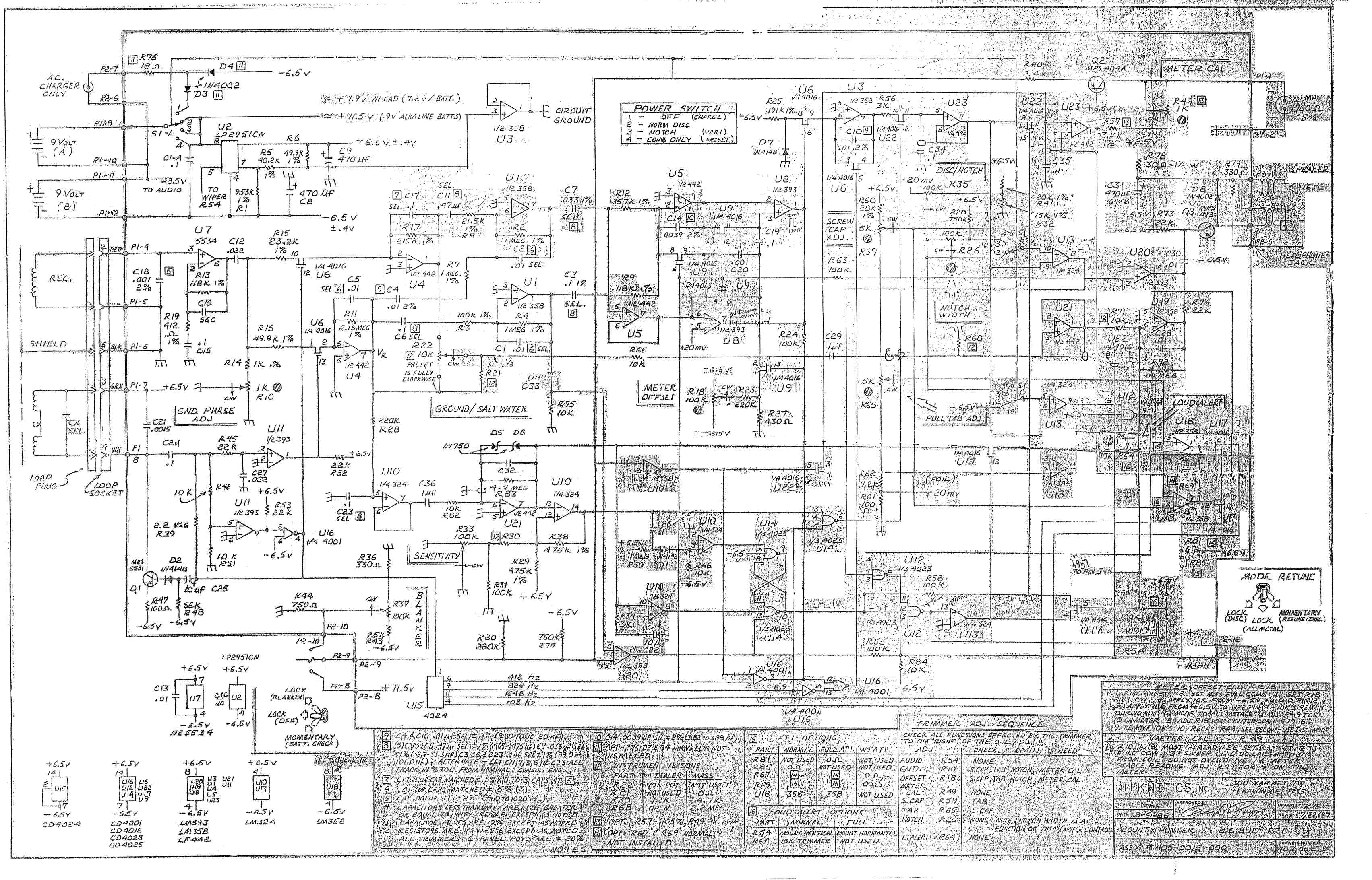

                      Here is an update but I'm going to need some help. The "Loud Alert" area of the diagram where U13 and part of U17 are. I can't tell where U17 connects. There was a fold right in that area. Could someone please take a look at the original PDF and see if they can tell me U17(the part controlled by pin13) connects to the rest of the circuit?

                        Merc,
                        You have several chips, which are 4016 chips, the 4016 is a 12 Pin chip, and one of them is U17. It uses only 3 sections of this chip, the 4th section from what I see, is not used. I think the area you mention is the place where the section using IC17 of 4016 consisting of pins 6, 8, and 9. Those are kind of blurred in that area.
                        If you follow the lines, of these three pins of U17, you can see where the connections go. I am not sure if that solves your queston or not...
                        The other two sections of U17 4016 chips consist of one part that uses pins 3, 4, and 5, another part uses pins 10, 11, and 12. The part that has pins 1, 2, and 7 does not seem to be used in any of the 4016 chips in this schematic.

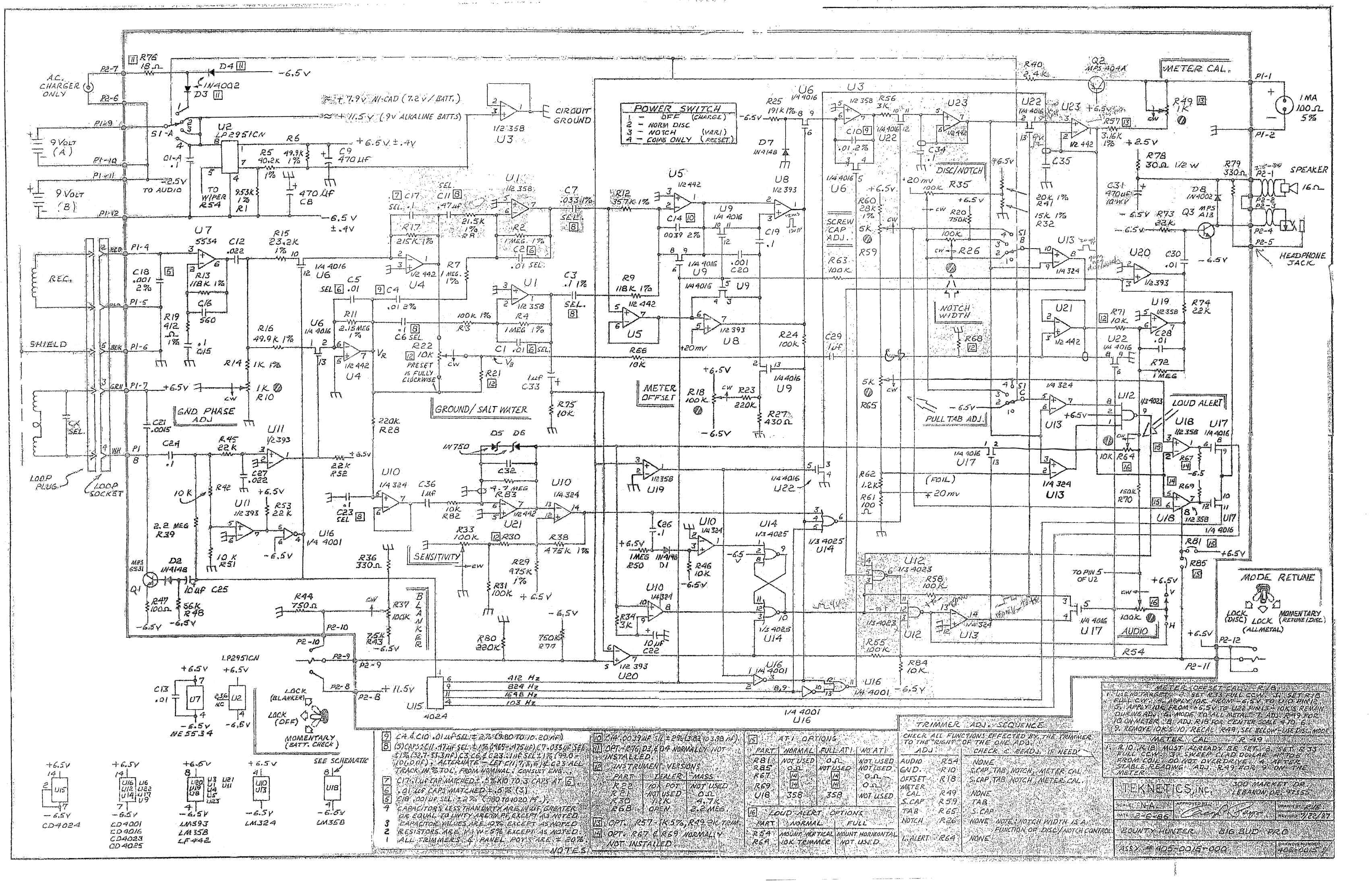

                          Never mind. I figured it out by comparing the schematic to BB Pro SE that is still apart on my workbench beside me. It is VERY similar if not identical to the schematic. The reason for the difference in supply voltage may just be a difference in adjustment of R54 which is marked "Audio". It ties to the voltage regulator U2.
                          Merc
                            I think I got most of the hard to read area correct. I had to compare to my machine.

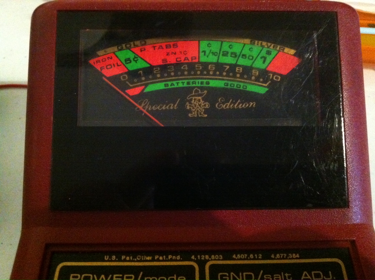

                              Melbeta, I figured out my 4016 issue by comparing to my detector. Whatever schematic this is, it matches my detector perfectly so far. I'll keep looking for differences, but so far every IC number, resistor, capacitor and pot have matched up perfectly. Here is the meter face of my unit.
                                The only thing I see so far is that I don't have the charging circuitry; D3, D4, R76. There are solder pads and silk screened markings on the board for them, but no components. I'm guessing they decided to leave that feature off of this model. Perhaps the hole where the charge connector would have been is occupied by a switch or knob.
