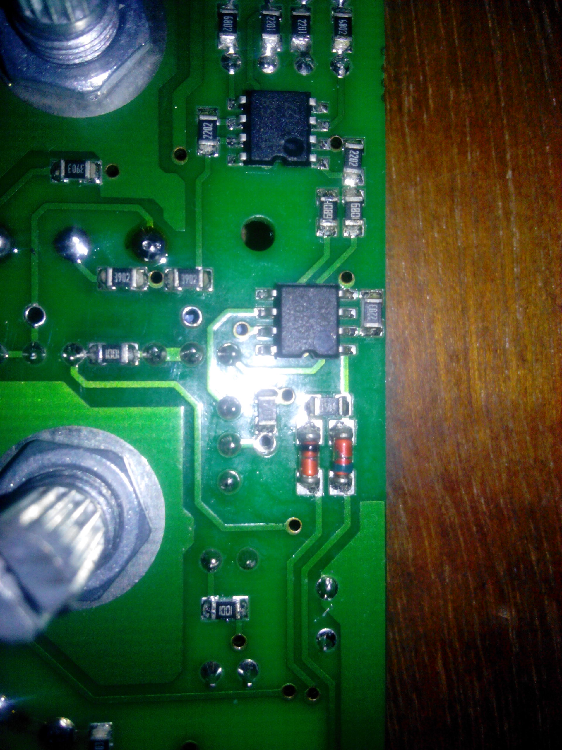

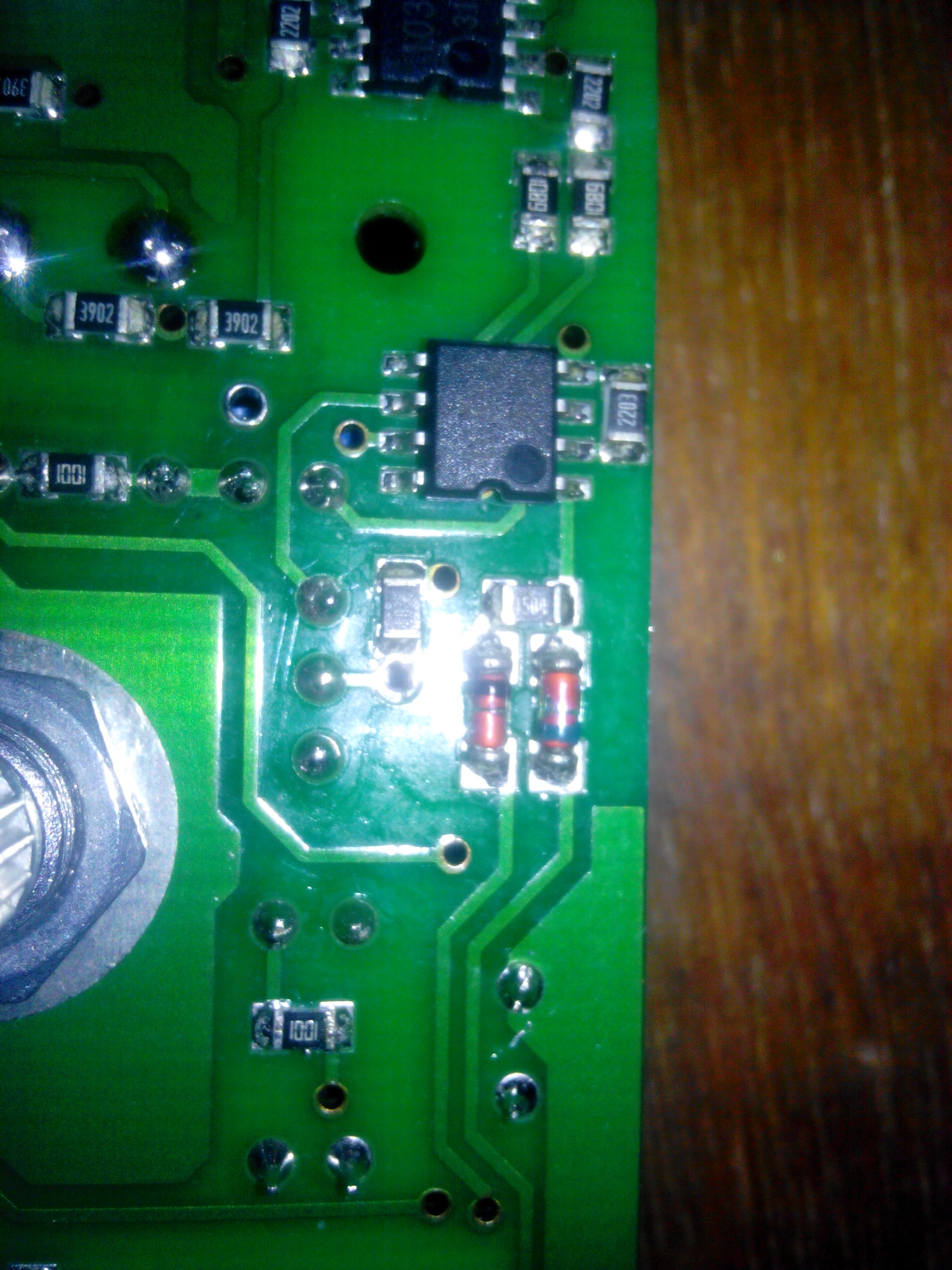

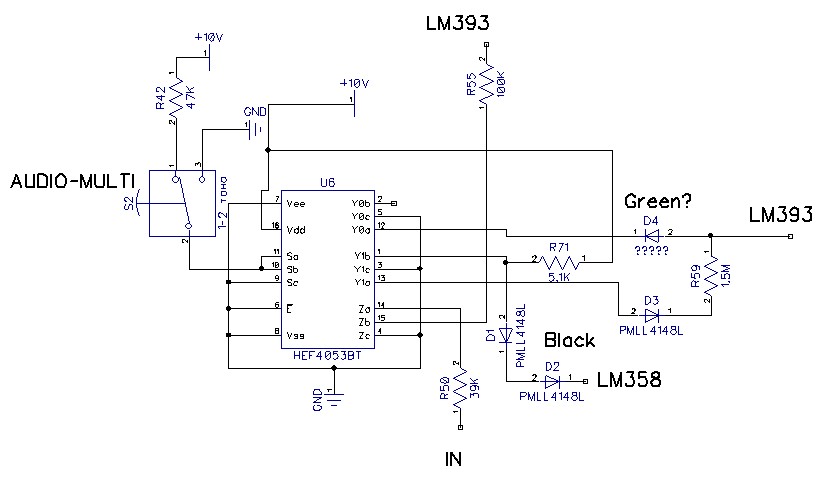

    Please tell me that the diodes in a gold mask, I see the green and black stripe?
    • #62
      Black stripe-1n4148
      Green stripe -Zener diode 2.7v

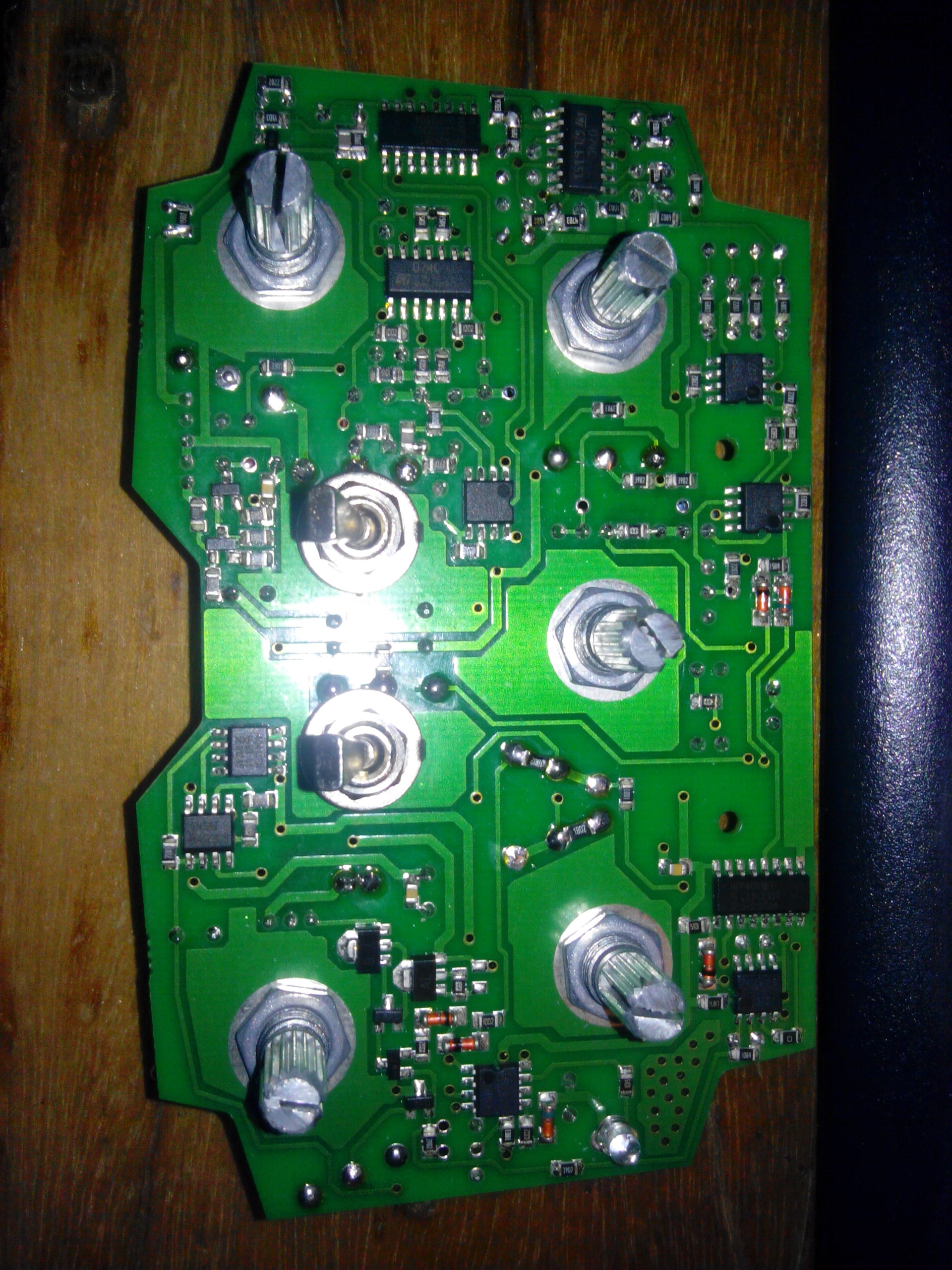

      Vlamvers can you make more pics on pcb board?
      • #63

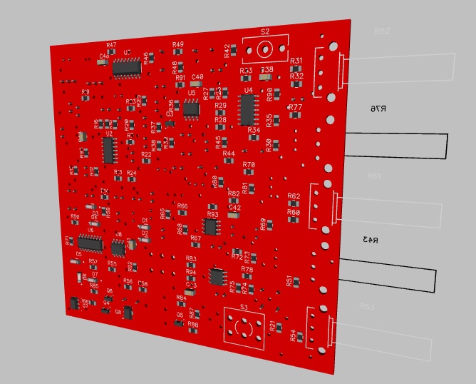

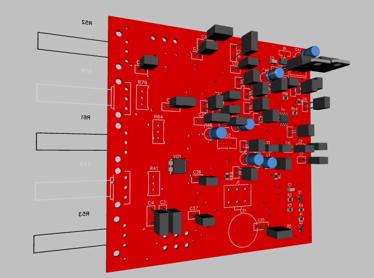

        I ended circuitry golden mask 4wd pro, all done in diptrace, now ordered the board in China, and gather to test the first 10 units. The size of the board until 10 * 10cm. All depends on the diodes, the original charge was not my why could not it be completely dismantled. Tried to put in place the green - 4148 and it worked, set - diodes with green ring BAV105, BB240 work.

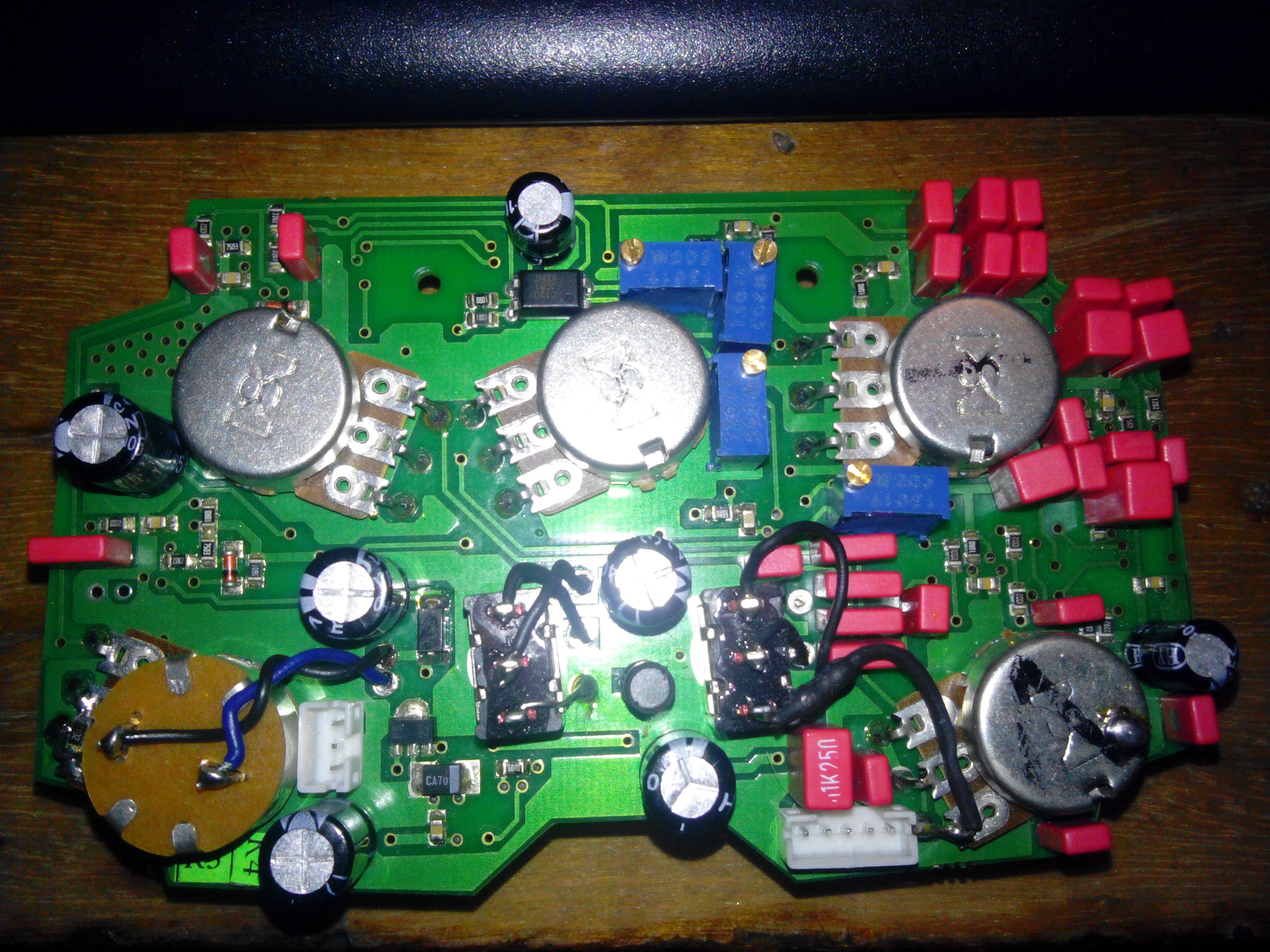

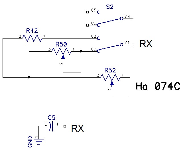

            This is somewhat schemes PX, Fixed ground balance, green diode.
            • #66
              This photo GM4Pro

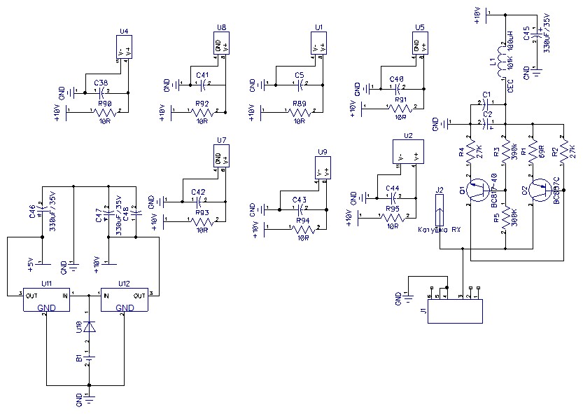

                  I will spread as a complete check.
                  Power module redesigned, different from the original. Collected at 7810 (10V) and 7805 (5V)
                  We have hard to find 2 chips used in GM, therefore replaced at affordable.

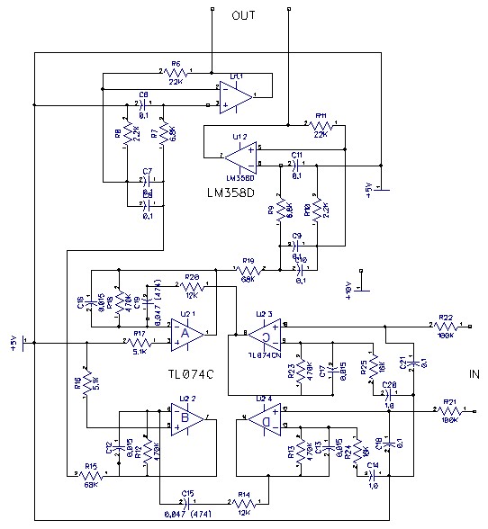

                  is a diagram of two amplifiers

                    This is my board
                    • #70
                      Thank you all, drew from the board and checked with a green ring on the zener diode is 3.5V. (scheme assembled: a resistor and zener diode, filed 10V output 3.5V)
                      In the mask 4pro - two zener diode is used: this first, second at 5.5V stands on the battery indicator.
