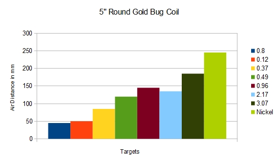

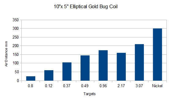

      If anyone is considering building the Lobo-Lite, then there is one thing that needs consideration. The sensitivity circuit needs a little work, I ran out of time and didn't fix it.
      As the circuit is above the maximum sensitivity is when the pot is at about 75%. It appears that full sensitivity swamps downstream circuits. The 2k2 before the sensitivity pot needs to be increased a bit more....how much? I'm not sure and don't have the time to check....I just make sure I don't turn my pot on more than three quarters.

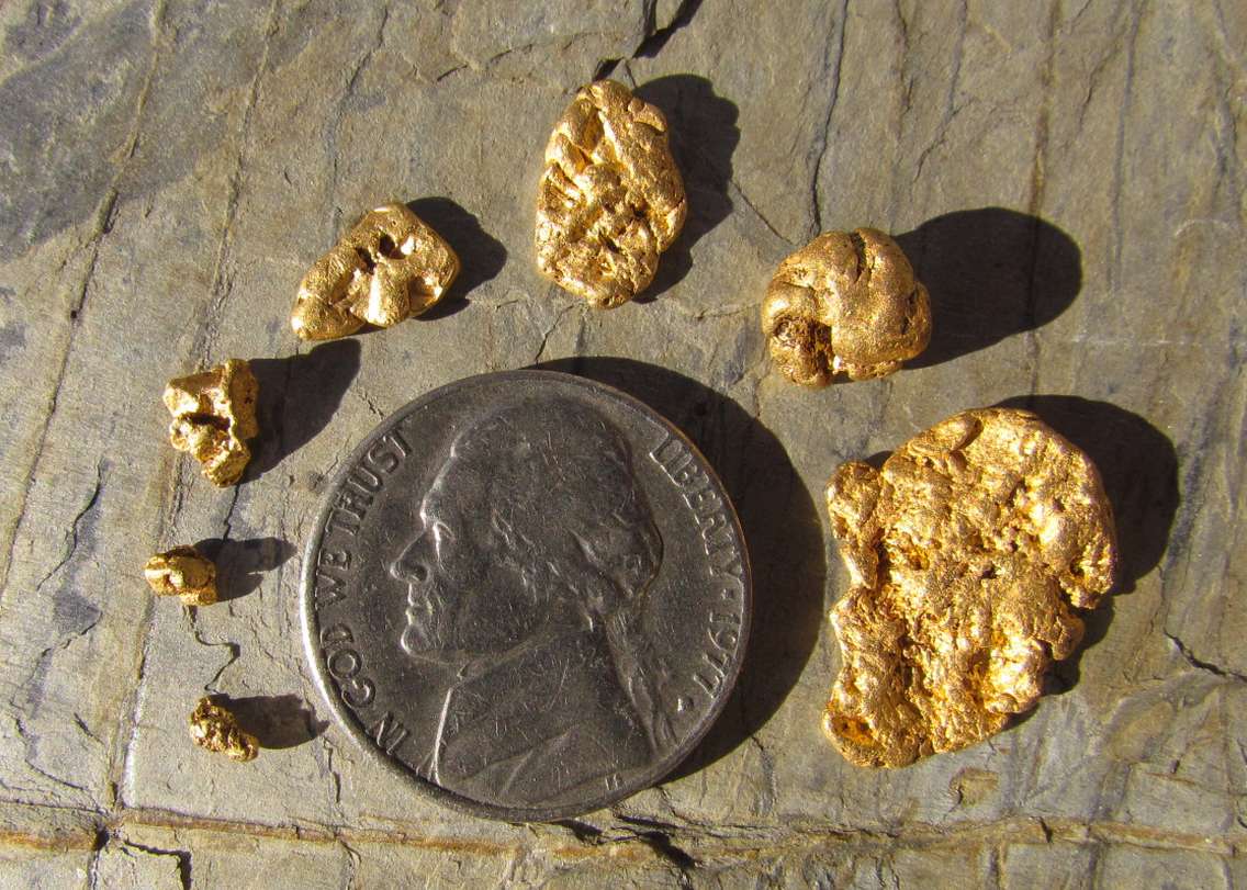

      Here are a few air tests, target weights in grams. The 5" round would probably get a 0.02 or 0.03 at a similar distance to the 0.08 crystalline piece, I didn't have anything smaller handy to test with. (Note also an obvious mistake (sorry) on the graphs the smallest one is 0.08 grams and not 0.
      This machine will see many if the flat nuggets on edge at very respectable distances too, much better than a PI, this is exactly what you want for a bedrock sniffer where many of the pieces will be sitting vertically in the cracks and crevices.

          You are correct it may not be as simple as changing values, but I added the 2k2 and it did help a little. What happens is that sensitivity increases as you turn the pot up, but once past the three quarter point sensitivity starts to drop off. It appears to be either loading the second input amp or upsetting the following integrator stage. I have moved on now, I am working on a couple of PIs one of Bugwhisker's and Tinkerer's so if anyone wants to solve the issue that's fine. It also needs a compressor to limit large responses, and when you first turn it on you can't have the headphones on as the battery level indicator blasts your earwax onto your eardrums.
          This thread introduced the Tesoro Lobo a discriminating detector designed primarily for nugget hunting, I removed the disc, thereby making the Lobo-Lite as I needed a simple compact bedrock detector. I have been able to adjust the circuit to give maximum response without having to worry about phase relationships needed for disc, only ground balance was my concern. In fact disc is not needed if you are truly serious about nugget hunting, as many bits of ferrous junk in bedrock cracks are accompanied by nuggets and fines. Near surface junk can alert you to a hard to see crevice that has undetectable gold buried deep down beneath the junk.
          With the TX set for about 18 Volt peak to peak the frequency is around 21kHz, this is a bit too high for a coin shooter, notice it only gets the nickel at 12 inches with the elliptical coil. Admittedly this is equivalent to a 7 inch round and not that bad, but the TGSL project on this forum will get a nickel at 14 inches with a home made coil, one of the reasons being its lower operating frequency.
