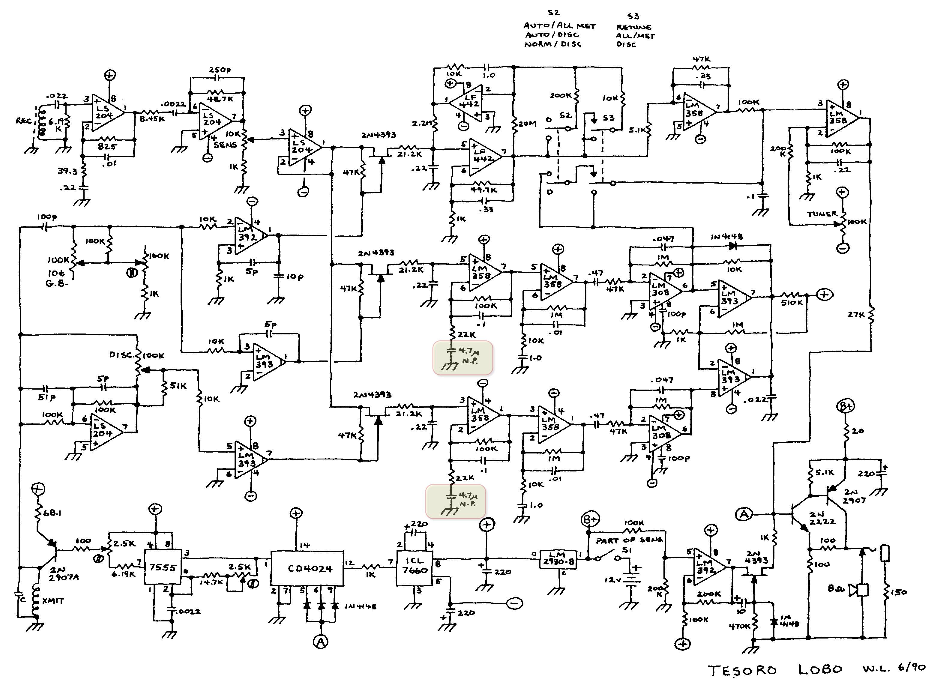

    Please take a look on this schematic

      Boy I must be goophy! I sure cant find them.

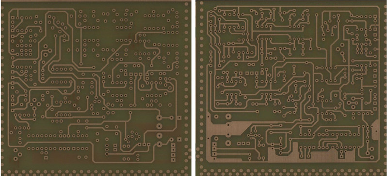

            Hello all
            The first step in the achievement in double-sided PCB.
            • #66
              hello legaucho
              clean work looks good
              could you deliver two boards to germany
              i have not a good hand for making double sided pcb
              regards bernd
              • #67
                Hello bernd
                I don't make myself , I use the services of PCB-TOOL.com. Link in german https://www.pcb-pool.com/ppde/index.html
                Best regards

                      Hello Everyone . I downloaded the Lobo rar-zip package of 19 megabytes from Fr. link and everything looks great . Only two word-pad document folders did not open , maybe outdated.
                      I am just wondering the Original Lobo which was manufactured as a single sided pcb board , why the pcb lay-out was changed ?
                      The Lobo was originally engineered as a single sided . Signal problems may occur ?

                              • #75
                                Hello Eugene
                                The Lobo with a single sided PCB is a modified versus ( in relation with yopur comment ).
                                Why the double side: I did it to simplify wiring, I gathered the various connections on both sides of the card and also there is less bridges in the middle of the circuit.
                                But if you want to make a single side PCB use this one.
