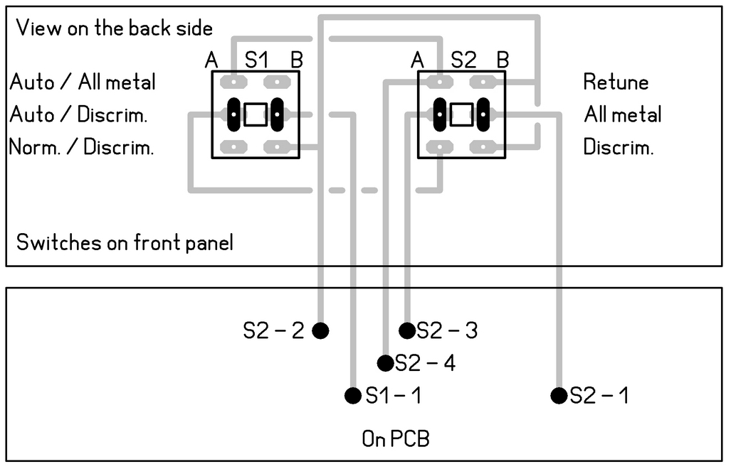

    Hello all,
    please find below the switch connections.

        Hello Legaucho and Everyone .
        The last Lobo sprint file you posted is the best one I have seen so far . But, between pin2 of U13 and S2-1 is an unmarked component ? Also the two 4.7 uf capacitors are they electrolytic or bipolar now ? I need to check the schematic if they are needed for dc filters or ac signals.
        HH......................Eugene
        • #49
          Hey Eugene
          Concerning your observation, the component between between pin2 of U13 and S2-1 is 1K resistor, the condensator are bi-polar and values are 4,7 uF.
          • #50
            A 4.7 uf tantalum 35 volt cap will be perfect if you can find them . All I can find is smt .
            HH...................Eugene

              Hey Eugene and the other
              Please find the attached file about the last layout. No modifications but arrangement.

                Hello all,
                My answer was too quick and I made an error, resistance between pin 2 of U13 and S2-1 had a value of 10K.
                My wiring was good, but not my implementation, then I put the modified file. Sorry again
