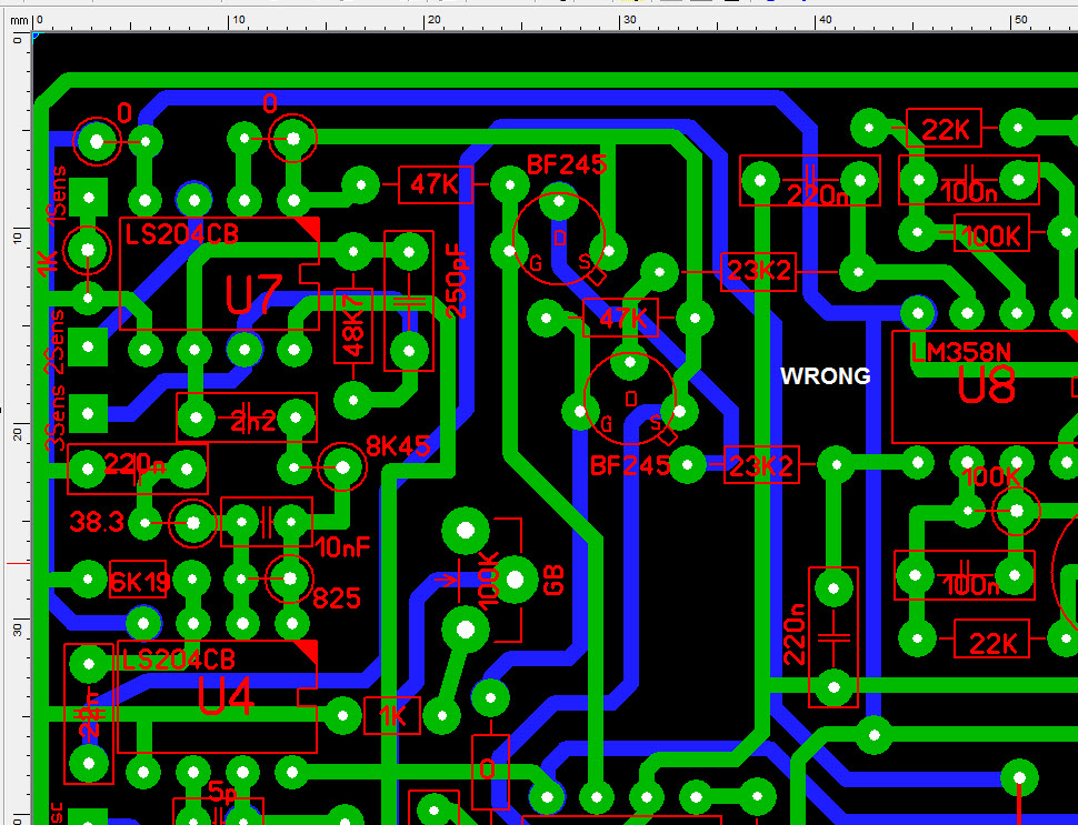

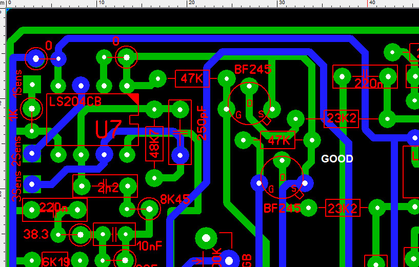

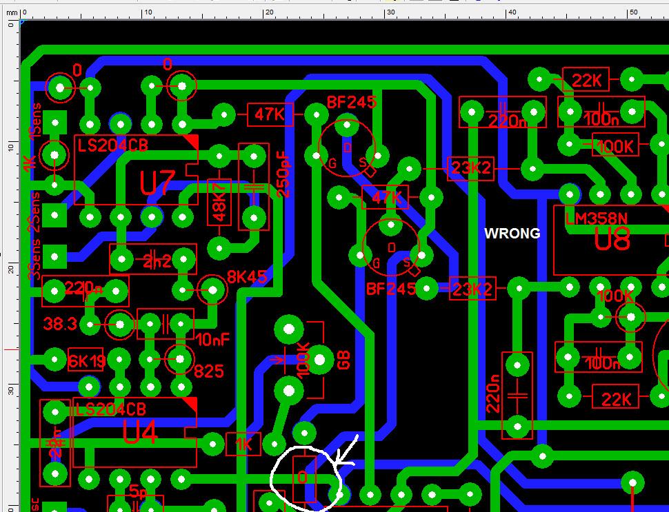

        Hey bernd,
        I find a little mistake this morning, and I have by the same opportunity the answer to my problem.
        See my two attached pictures

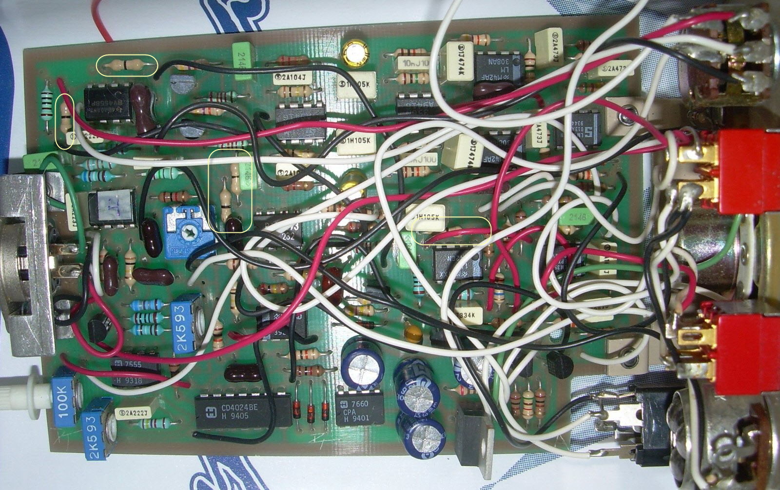

          Hello Legaucho . The pcb looks good to me , I was just wondering about the zero resistor ?
          It seems this Lobo is starting to become a very popular project , especially on Russian forums too . After the tiny bugs are worked out , it will be a great machine !!
          Regards..........Eugene
            Hello Eugene
            In the original Lobo PCB there are several Resistor with 0 Ohms using like bridge.
            Best regards
              I see that now , I wonder why Tesoro did that ? A fuse to burn ?

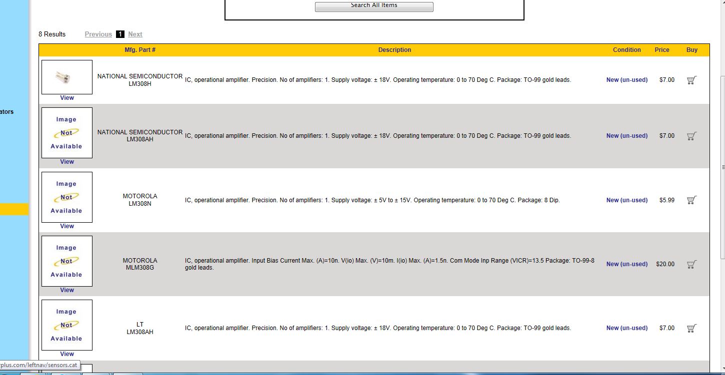

              I am finally ordering all the parts next week . Everything is easy to get except Lm308 is obsolete now.

                Using zero ohm resistors is just another way of making the topside connections on a single-sided PCB, rather than using wire links.
                  That's bad news.
                  Alltronics has the LM308H for $2.95 and the metal can is supposed to be the best, quietest.
                  You can purchase on LM308N on ebay for about $1 each, although those are from asian vendors and possibly counterfeit - but at that price maybe worth the risk.
                  If money is no object, Linear Technology makes the LT1008. Buy direct for ~$4 (+shipping) or purchase from Digikey for $5.50 (+shipping).
                    In doing some cross reference research the TL070 or [TL071 possible] but what was mentioned was the external capacitor needed on substitutions to correct a bad "Slew Rate" of these chips ? How about OP07 ?
                    Nte938 is $10.00 bucks .
                    This LM308 problem was already discussed here on this forum .
                    The BF245 is cheap replacement but no metal can like original 2n3493.
                    BR...........Eugene

                        Homefire . OP07 looks like maybe ?? A very Good price @ one buck each !!!
                        AD797 = NO !!!!
                        HH........E.

                            All Electronics has them!
                            They only want a Arm and four Toes for them. LOL
                            But then Mouser wants $10.00 for the NTE Version. http://www.mouser.com/ProductDetail/...zjLdtelA%3d%3d
                            • #44
                              LM308N $5.33 here: http://store.americanmicrosemiconduc...FSUbQgodcEAS2w

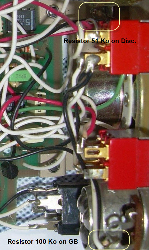

                                Hello all,
                                There are two externals resistors on front plate potentiometers.
