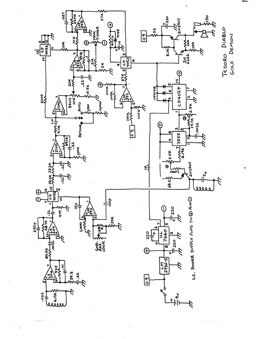

            Here is some more [Good] News . Just remembered something very important that will be a big help to me and maybe to some others here. You know Tesoro Diablo and Tesoro Diablo II ran at 20 Khz !!!!! They were the predecessor of the original Lobo . I see a lot of similarities between Lobo, Diablo and Diablo II
            The Eldorado has circuit similarities also , which runs @ exactly half the frequency of 10 khz . Here is one more schematic to study below :
            I think we finally have enough information to start our hobby project , for educational purposes only, "Of Course"
            Regards............Eugene
              Eugene thank you, it is indeed a possible way of work.
                This model (Tesoro Diablo) discrimination is present?
                  Hello Smity . NO
                  Diablo is an "All Metal Mode" [No-Discrimination] / Nugget Shooter-VLF 20 Khz .
                  Diablo II is a "All Metal Mode" [No-Discrimination] / Nugget Shoter-VLF 20 khz .
                  Diablo Umax is "All Metal Mode" [No-Discrimination] / Nugget Shooter-VLF @ 17.8 khz
                  HH..................Eugene
