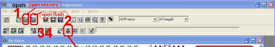

                    • hi Jap, How are you
                      please tell me how to program Atmega8 ( I use code or eeprom or the two ???? )
                      thanks
                      • Hi volcano
                        Thank you,to program Atmega8 see zip file.
                        best time
                        j.
                        • thank you Jap
                          But I can not open the two programs ( code and eeprom at one time )
                          • Hi volcanoClick image for larger version
Name:	read pony 1.jpg
                            best time
                            j.
                            • now I understand
                              thank you Jap
