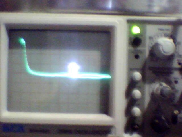

                  hello jap I have a question, so how we measure time changes DECOMPOSITION pin 24
                  • Hi g.s
                    -its (Weak signal)
                    best time
                    j.
                    • I had the Vali REVERSE r53 with r54 think now is better ,This must be the signal

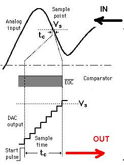

                      • HELLO JAP CAN YOU KNOW IF MY EXPLANATIONS HOW TO MEASURE TL062 D3Β 7 PIN Meaning HOW DOES THE MEASUREMENT The MICROCONTROLLERS. I know from having only moderate 0 THE 1 .
                        • Originally posted by g.s View Post
                          Hi g.s
                          This part has pin 24 of the most important parties because the way is converted reference Alanloj to Digital signal can be seen on the screen as they are comparable and 23 and this party is obtained on the separation of mineralsClick image for larger version
                          -Pin 24 is Way is converted signal(Weak signal) anlog to Digital,
                          has an analog reference voltage,which the analog input is compared. The digital output word can be seen on LCD (S2).
                          -Pin 23 like 24 but (Strong signal).
                          I hope I explained.
                          best time
                          j.
