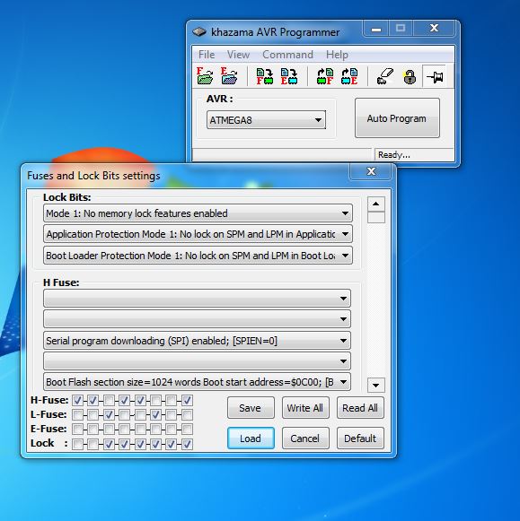

    I would like to know what the configuration in Khazama avr fuse and lock bits I have a picture but do not know if I can say this right settings for atmega8, of course I am referring to the PIM2.
    truth and schedule a atmega8 but I miss settings fuse and lock bits.
    I pieso that went wrong so I need settings.

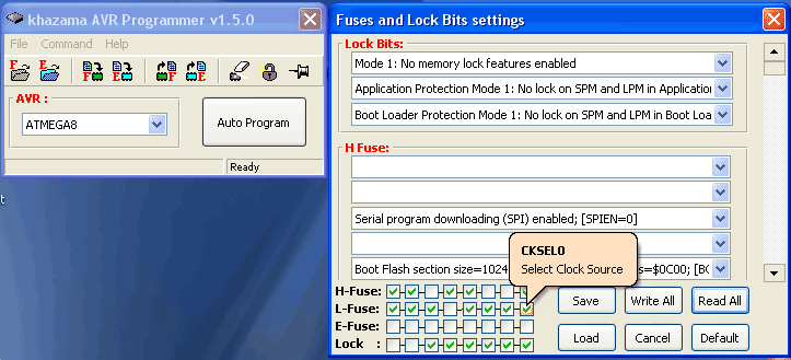

            • PIM2
              this is the right settings
              H-Fuse: D9 (HEX)
              L-Fuse: 24 (HEX)
              I attached a picture, sorry for my ignorance am new to this.
              clear is that the AVR Khazama ...

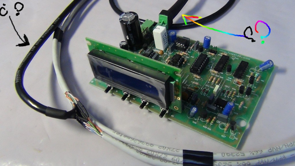

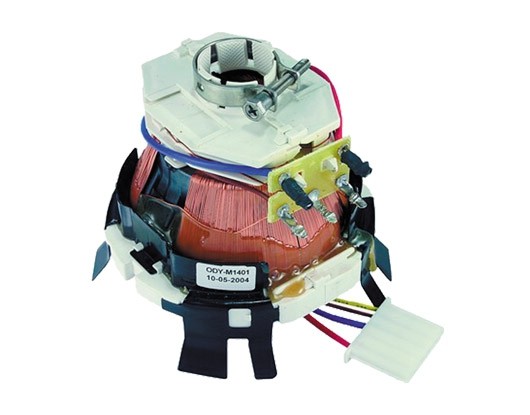

                        I would also like to know if I can help with something, what happens is that I have some long cable deflection yoke of TV and I wonder if this can be used ..
                        I'll upload a picture ...
                        Coil nothing that value shall take ohms, 2-3 ohms that is true?Click image for larger version
                        another question that cable is suitable for the connection of the coil to the detector and few meters.
                        • trouble with "re-claimed" enamelled wire is that sometimes its covered with
                          varnish to hold it in place,
                          such as the tv x-y windings,
                          some transformers etc etc.
                          when it's peeled of it can take off some of the original coating of enamel coating
                          resulting in a bare conductive patch.
                          when re-used if 2 patches touch you have a short,
                          could be one turn shorted,
                          could be many,
                          then you have problems.
                          I have found even new copper enamelled wire needs to be treated
                          carefully.
                          bending the finished coil to many times can break the insulation and cause
                          a short making the new coil scrap.
                          superglue on windings I have found makes the problem even worse.
                          use new wire when possible.
                          if making a pi coil then insulated wire possibly best bet anyways.

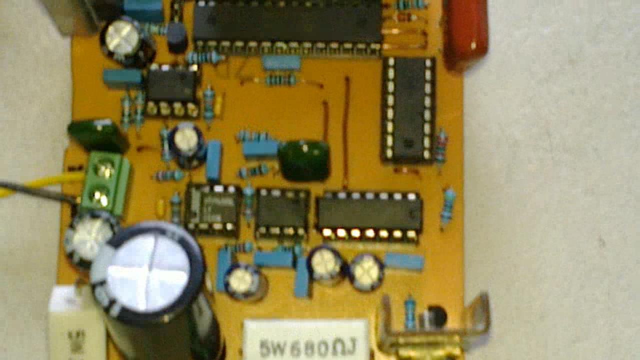

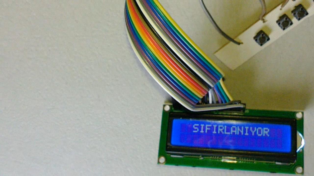

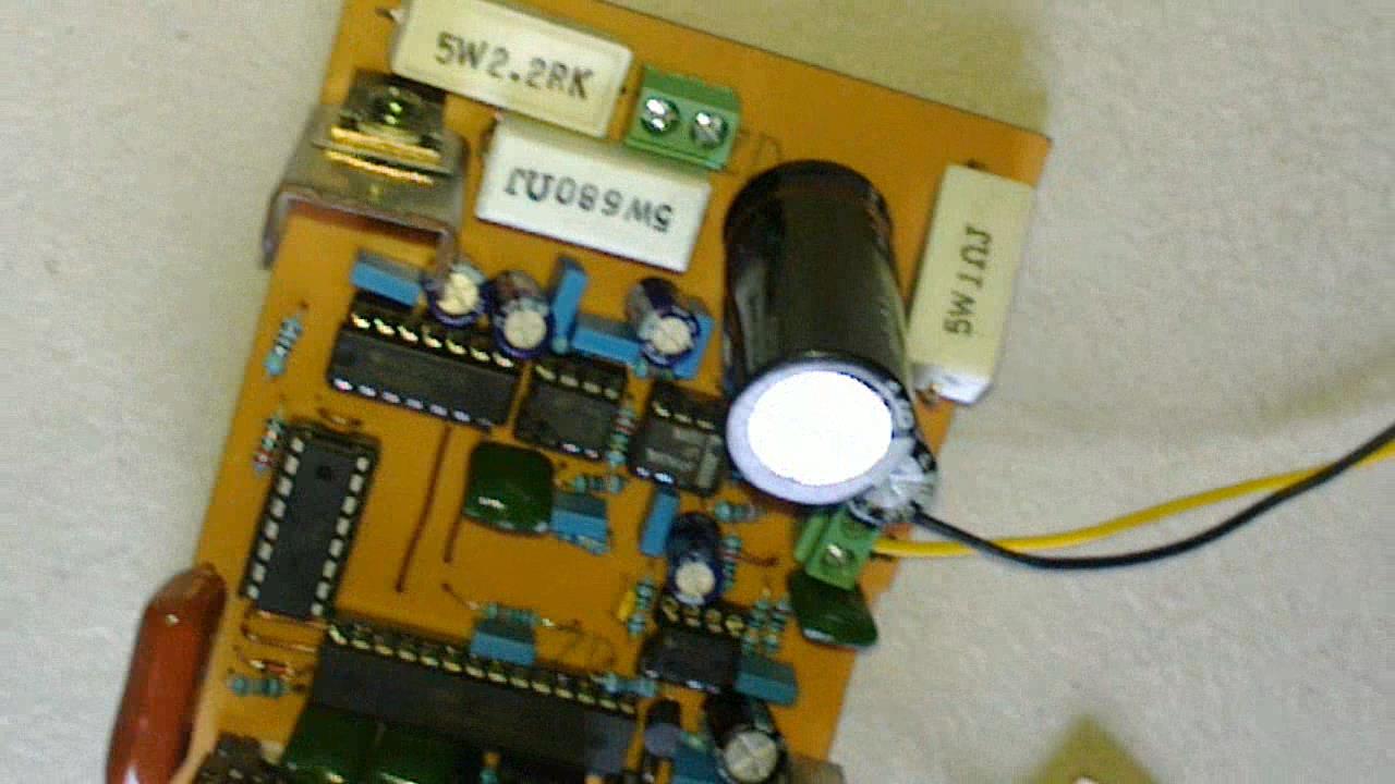

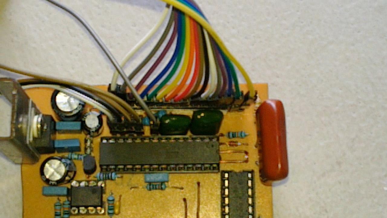

                          • hello I have a question them and made the Pim-2 version of M-ust-FA with full hex modified ..
                            the question is this, is that when turned on but the sound is heard after starting the sound is almost disappears almost nil ...
                            and shutter sound is heard very slow and neither do the tone to change.
                            but the metal screen is displayed.
                            will be a problem to use the full hex ..
                            tomorrow I'll upload a video.
                            • hello sabios
                              good to hear that you make further progress on pim2 mustafa
                              a have to mount some parts on my pcb than i am ready too
                              hope we can solve this problem
                              would you please upload one or two picture from your setup?
                              best regards good luck
