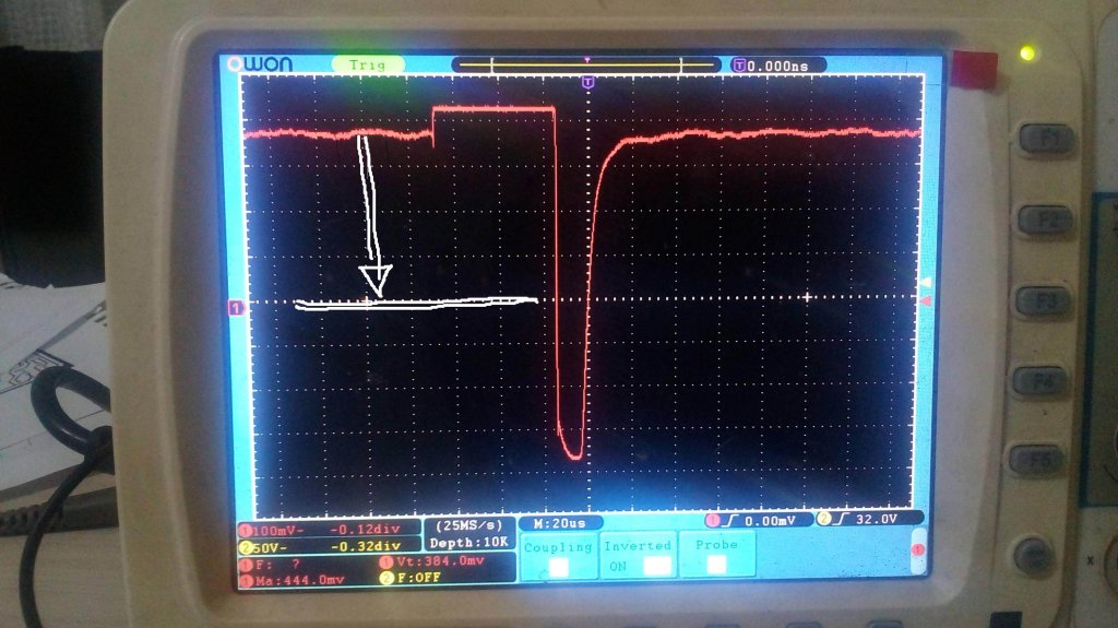

  • The delay pots dont changes anything on this curve...
    I have check two pots and changed 4093 and +5v -5v supply everything normal.
    What can cause delay not working??
    • There is no Delay looking at the first Op Amp. You need to move on to the next.
      • thanks for answer but also delay pots doesnt change voltage of pin8 of 4093 ?
        i check second op-amp output and no signal only 3v arround dc voltage i saw and no curve.
        • Is there any voltage on pin 8? Maybe the pot is shorted.
          • Yes there is 4.7volt at pin 8

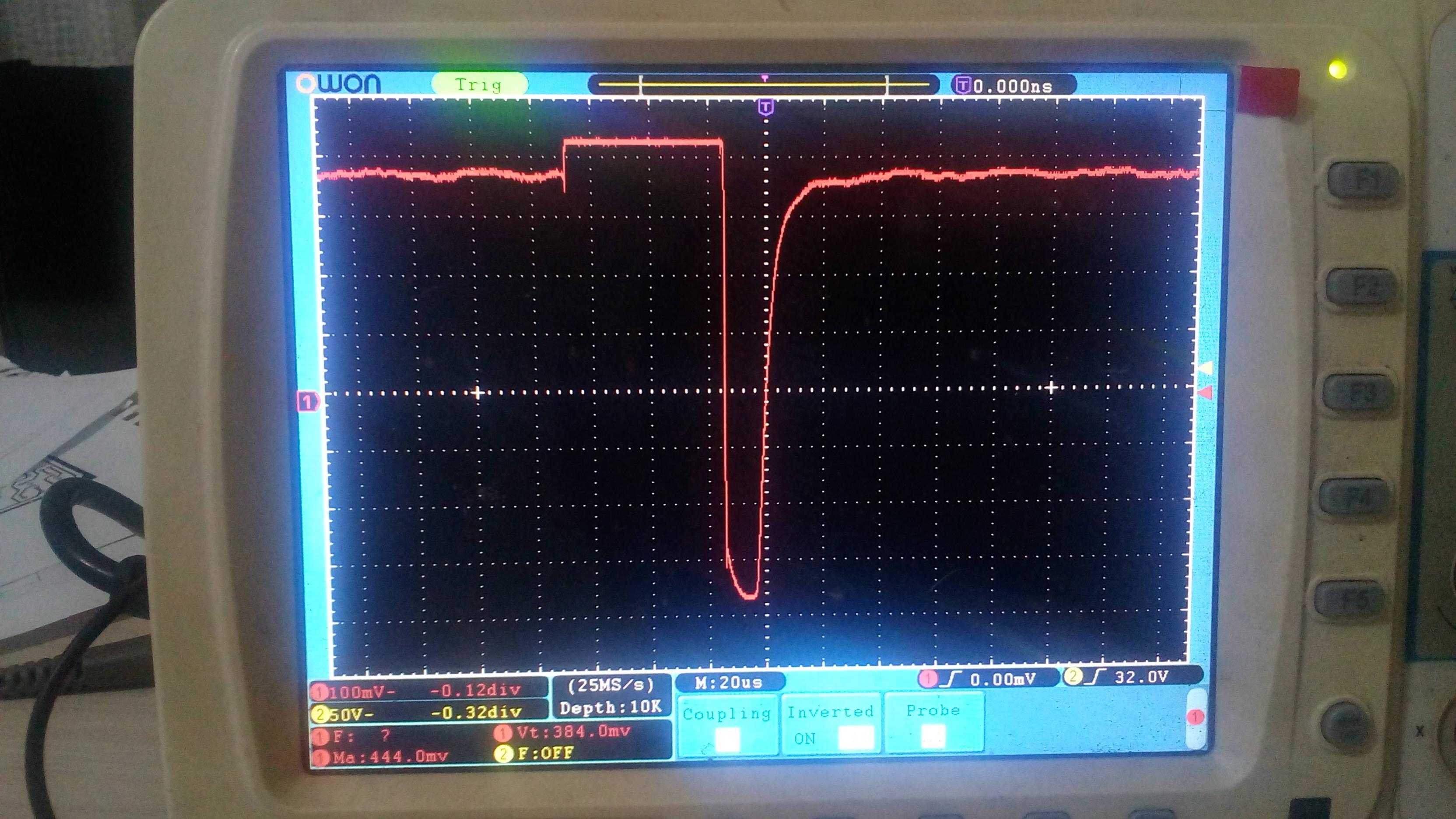

            And my first opamp curve here
            I worked this circuit well half day but little later not worked

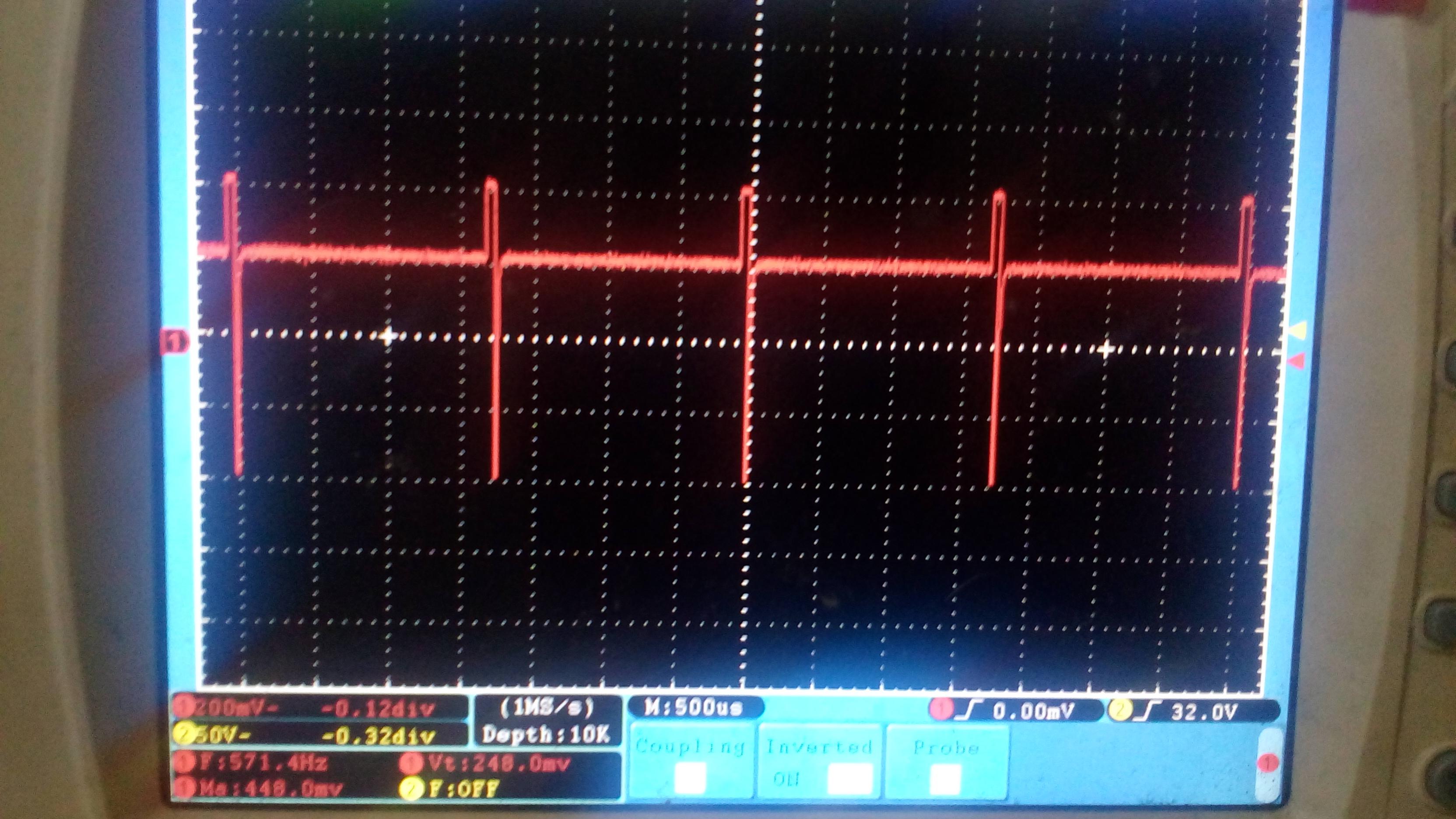

            • it gives great response to 40x20x20mm neodyum magnet to 30cm clear sound but all metals moneys no answer and as u see in picture upper works on 571 Hz

                The Curve is ok, but trimm the offset (P1) to set this "line" down to zero volt
                Use the second channel of your scope too, first channel to output of first op-amp (pin 6 ne5534)
                second channel to pin 3 of U4 , if the time between the 2 points is changing , at trimming the delay pot , then its ok.
                Please upload it again here.
