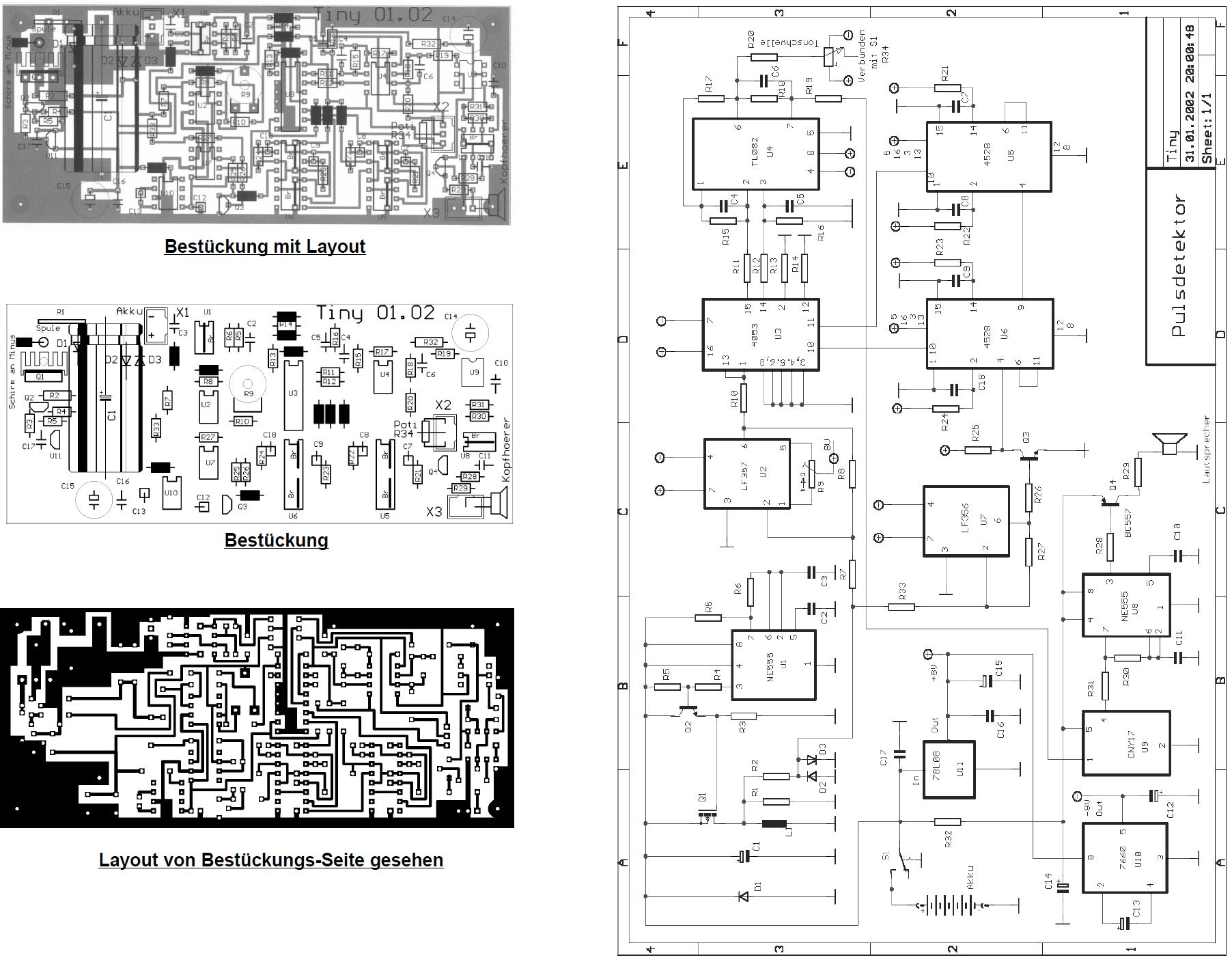

    i need help to redesign a pi detector layout.
    is the german "tiny" from www.pulsdetektor.de
    the design is from 2002 but is still a good beginner detector with a lot
    of modifacation option.
    im not 100 percent sure and able to do redesign.

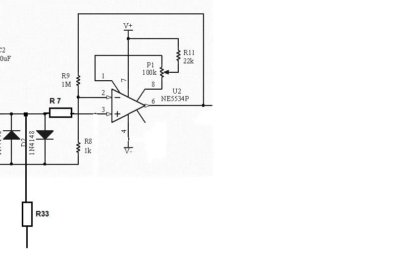

    but what i want is change Q1 MTP2P50E (PMos/500V) as replacemant
    the layout should take a irf9640 plus two biderectional supressor diodes
    another change could be to change U2 LF357 to another one, lf357 is out
    of production and hard to get or very expensive.
    i would be nice if someone could do a new layout
    with new Q1 plus diodes
    changing u2 is a task for later is hard to find a substitute.
    regards bernd

    Пробвай IRF740
      Originally posted by zomby View Post
      Пробвай IRF740
      did you mean i should use irf740 instead of mtp without any other changes?
      looks good low on resistance so more power for coil - but no other protection needed?
      should add one bidirectional Suppressor Diode (1.5KE400CA) parallel to coil
      greetings bernd

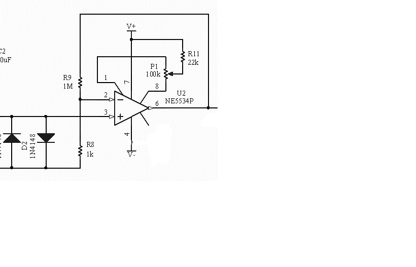

        LF357 смени със NE5534
          Така е добре
            thanks zomby

                          hello
                          question was for possible redesign
                          so that i could it made more modern
                          coil in video is a monoloop
                          has enough sens for small objects and for my task
                          but you are right there is also a dual field planar shaped coil for this unit
                          shown and also a dual field with a outer ring and and inner star with three spikes
                          so you get fields with higher and fields with lower em concentration
                          the tiny which is shown has only a little part of all possible mods
                          the pots are
                          volume/tune with on/off switch
                          fine threshold with with multiturn pot
                          pot for variable coil damping
                          other can be sampling delay and pulswidth
                          in this case some resistor are replaced by pots
                          for using a supressor diode parallel to coil i dont need to redesign right?
                          just to solder one between coil connector inside housing would be best solution?
                          (when using a irf... for q1)
                          regards bernd
