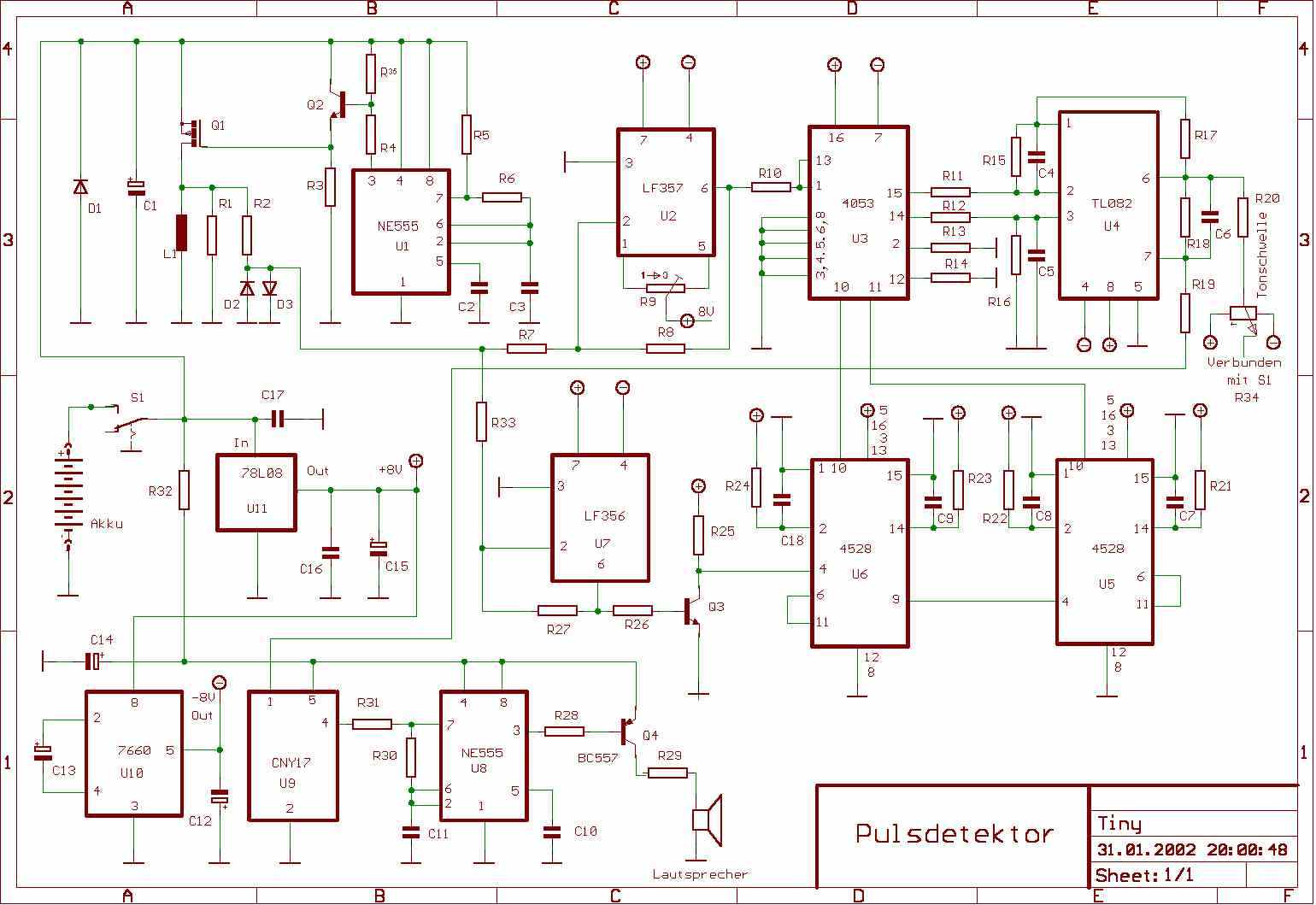

      hello all
      i need help to redesign a pi detector layout.
      is the german "tiny" from www.pulsdetektor.de
      the design is from 2002 but is still a good beginner detector with a lot
      of modifacation option.
      im not 100 percent sure and able to do redesign.
      but what i want is change Q1 MTP2P50E (PMos/500V) as replacemant
      the layout should take a irf9640 plus two biderectional supressor diodes
      another change could be to change U2 LF357 to another one, lf357 is out
      of production and hard to get or very expensive.
      i would be nice if someone could do a new layout
      with new Q1 plus diodes
      changing u2 is a task for later is hard to find a substitute.
      regards bernd
      [ATTACH]18484[/ATTACH]
      I built this small detector some time ago, it works quite well. Don't try to find MTP (too high Rds) use IRF9640 instead, no suppressors needed. Also change-adjust R1 dumping resistor value, this one on schematic is way too high for any coil. Especially critical in this detector, because timing is synchronized whit RX signal (U7), any ringing will mess up detector operation completely. If you have problems whit audio, just replace CNY17 whit another one from different manufacturer(too high mfg. tolerances). This detector is nonmotion mode, so you can expect significant warm-up drift and threshold will change during operation, (temperature, battery voltage etc), good idea is to use 10turn helipot for threshold (R34). Quality parts are mandatory, metal film R, film caps etc. Otherwise not bad at all. Original PCB is nightmare, more jumpers than parts, i built mine on prototyping board. Try to find LF357, 2x356 will work too (356 is as fast as 5534, if you not use some very fast coi will be OK). Also, just to mention, stunt whit 4053 (U3) and grounding integrator stage between pulses (R13/14) is completely unnecessary.

          Tiny
          R3 is 10k or 1k????
          thanks.
            Originally posted by bion View Post
            R3 is 10k or 1k????
            thanks.
            look in the partlist i think there is a error at r23 (missing 2)
            so r23 10k and r3 1K
            and r5 at q2 is not r5 it is r35 r5 is besides r6
            some hints for those who dont speak german
              Tiny
              ok ,now what is "SPULE " in R1.???
                spule is coil in german.

                      i almost finish built Tiny MD ,now for the first start what should i do?
                      regards BION.
                        hello
                        connect coil and battery and switch on
                        turn the potentiometers so that you get a klicking sound
                        when you find that point then make fine adjust for example 1Hz click or so
                        the detectorneed some minutes to get the right working temperature
                        but check the components while testing so that they do not overheat
                        (maybe you damping resistor is not the best or coil has not the right resistance etc.)
                          hello again bion
                          if you have trouble at first start please check q2 there are different type of it
                          maybe you have another type as shown on component overlay
                          it is better to look on shematic
                          i think you will do all right
