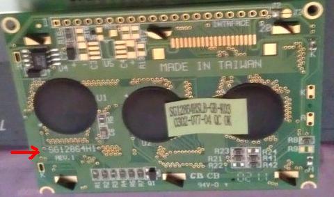

              Originally posted by volcano View Post
              Hi Jap
              Please I want to know
              what picture I follow it ?
              I inform you that I have this screen ( SG12864HSLB-GB-K03 )
              Hi volcano
              SG12864HSLB-GB-K03 = SG12864H =winstar wg12864b in numbering & function.
              use R37= 2.2K,R40=6.8K .
              best time
              j.

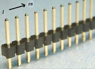

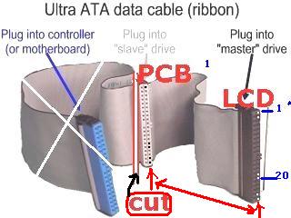

                  • thank you Mr Jap
                    But I do not know the connection of wg12864b
                    please show me a picture
                    thanks
                      thank you Mr Jap
                      thanks
                      Hi volcano
                      the connection U NEED.
                      -USE Pin-Header in pcb,LCD
                      best time
                      j.

                              • Hi volcano
                                -You can use Pin-Header-angle Connector 1--20 directly above the pcb to LCD.
                                best time
                                j.
