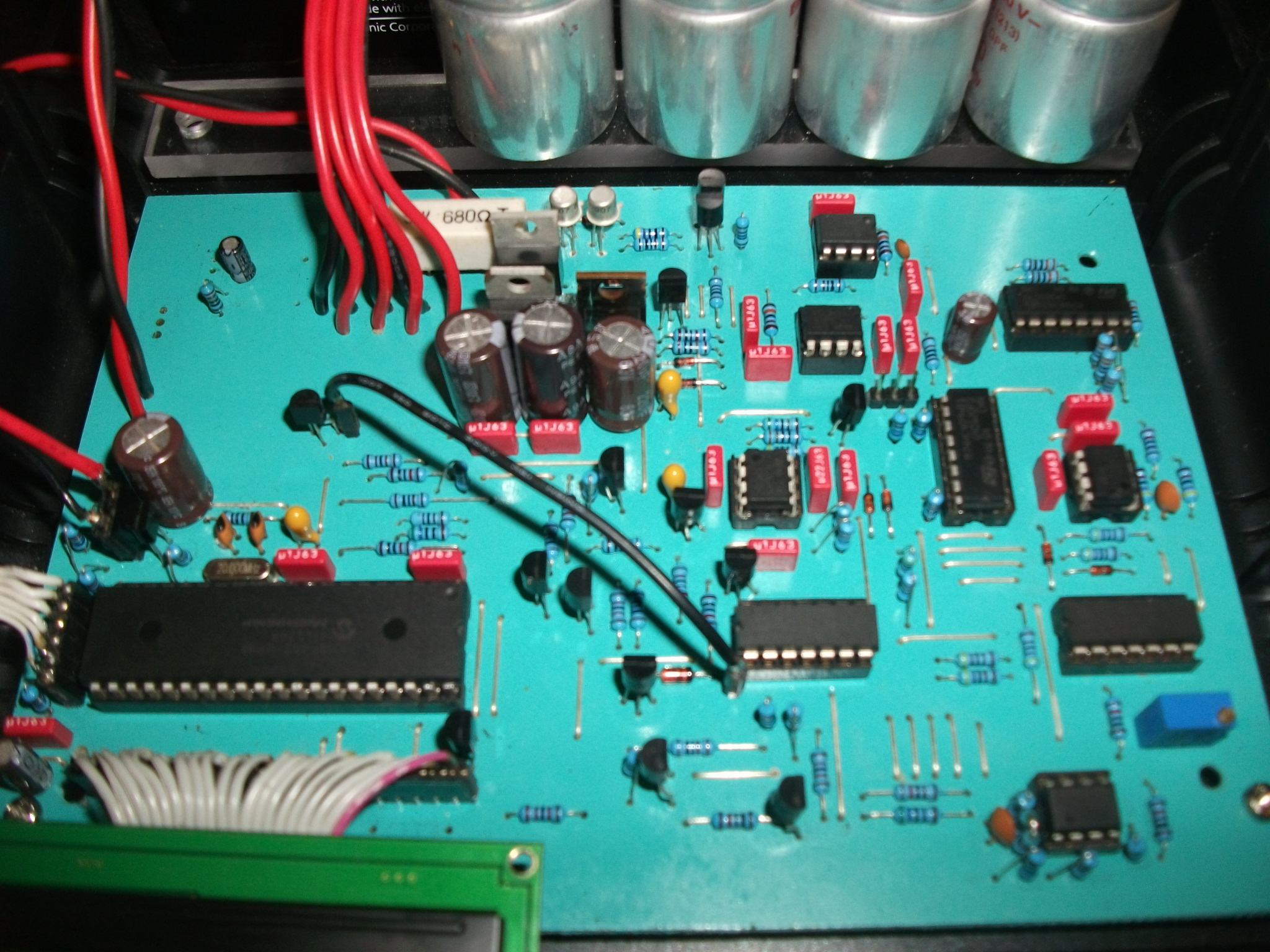

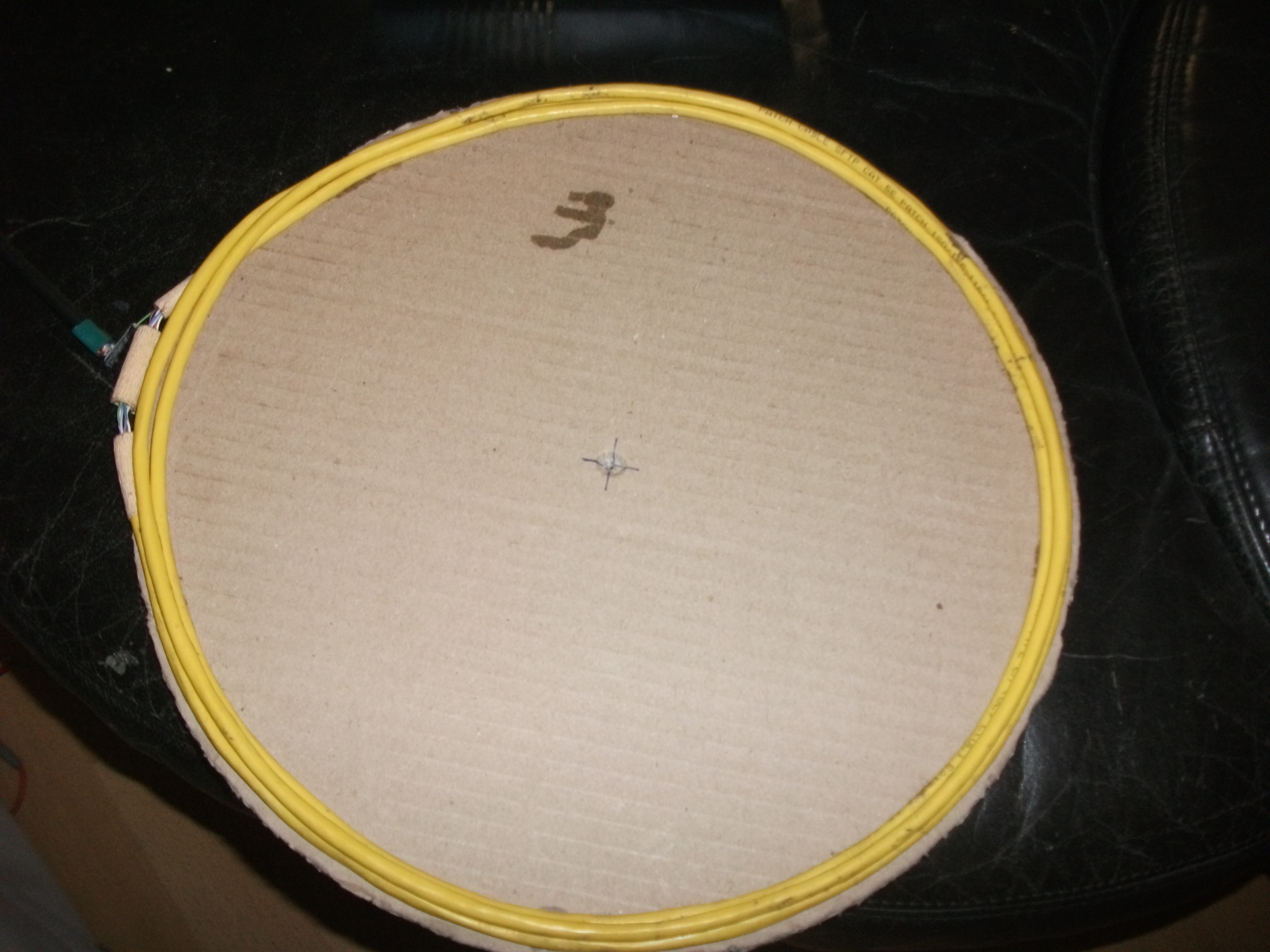

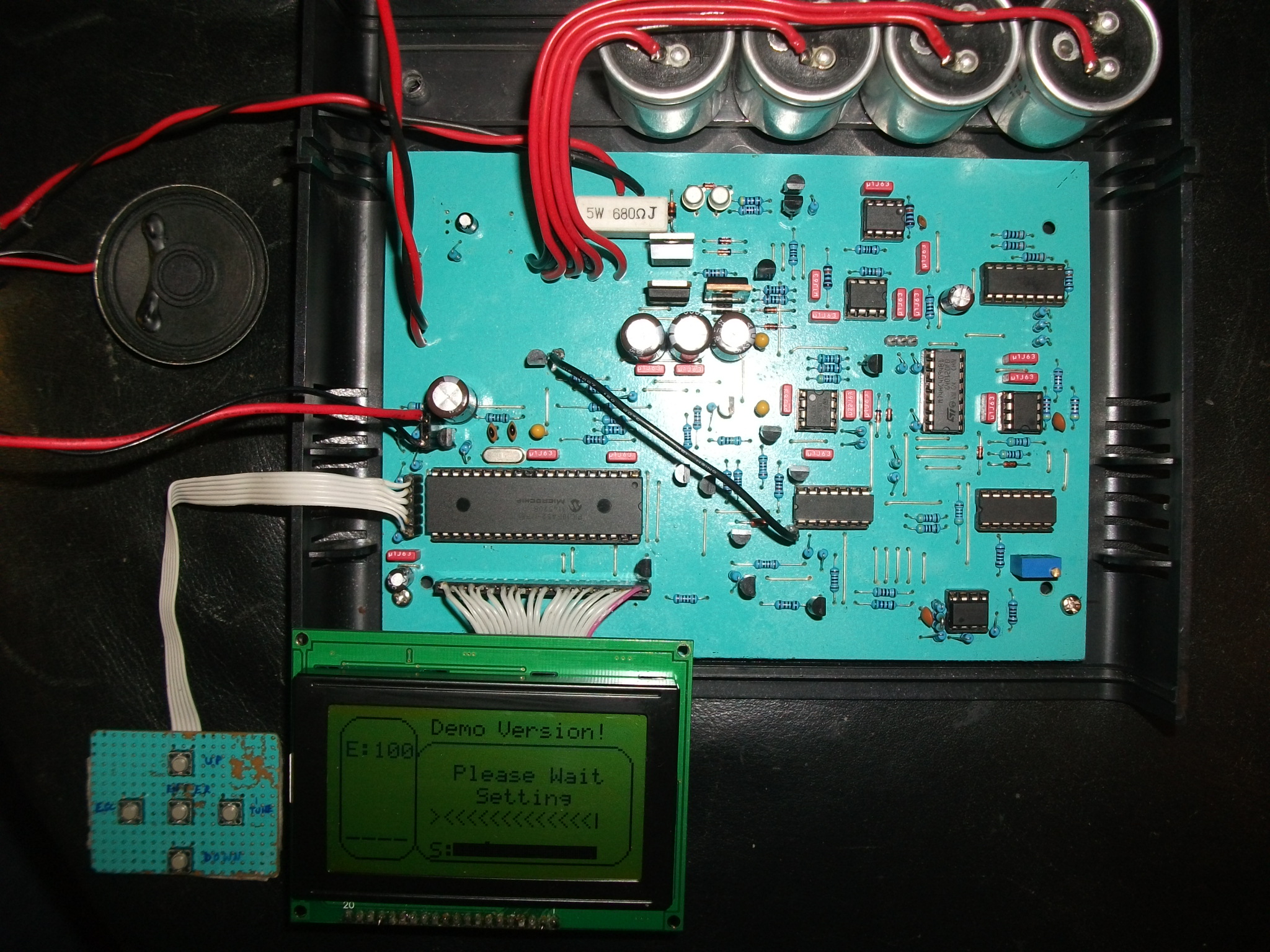

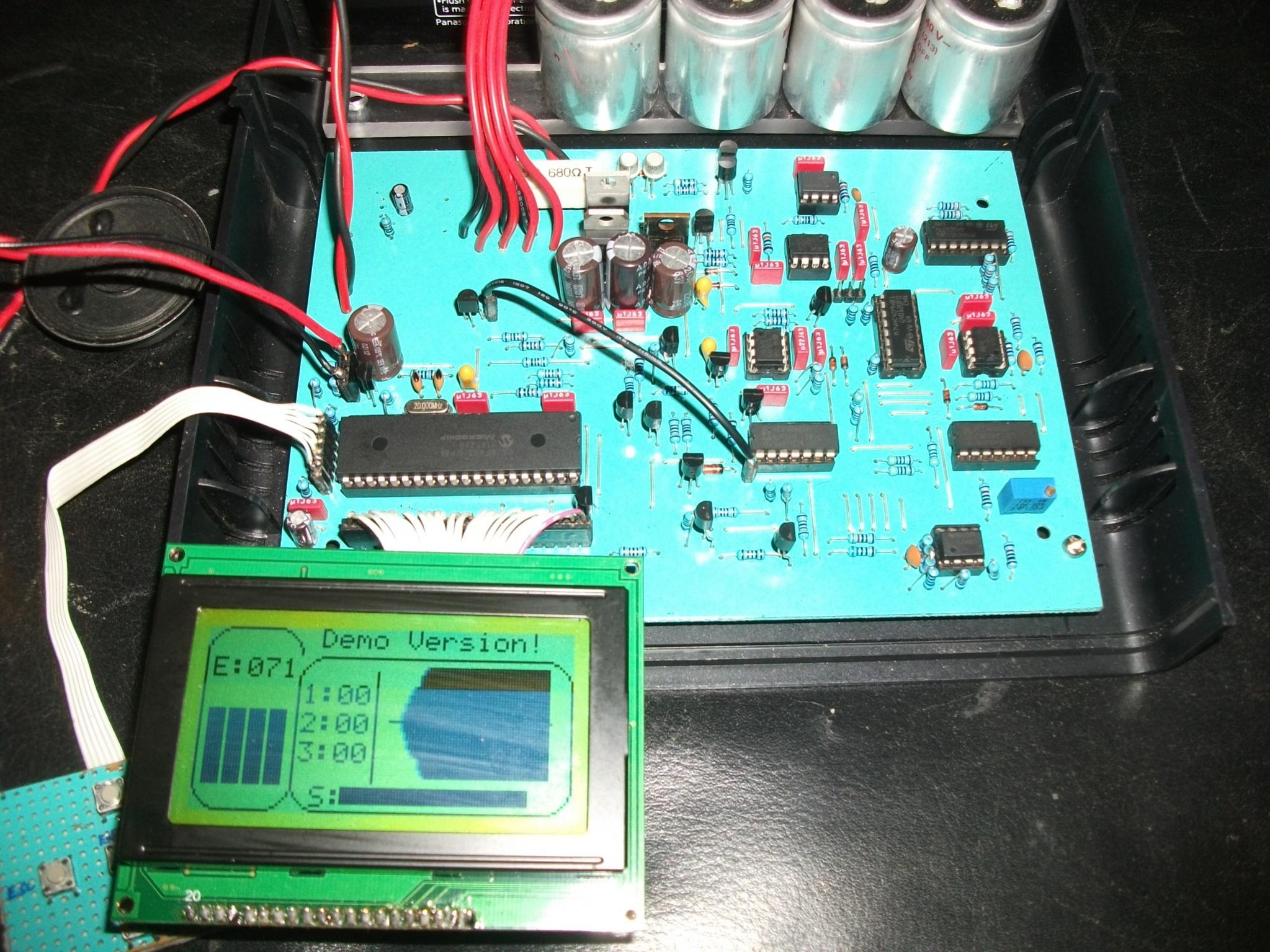

                          • @Biogas,
                            i made pics of my DP3 and hope that some of your questions will be answered this way.
                            The mini LCD form ebay hasn´t arrived yet, so i took another K0108 GLCD.
                            The coil has 460uH and 3.6 Ohm.

                              • Hi turboaleks
                                -Nice PCB work.
                                --Do you PCB works(Detection + mode Scope) ?
                                best time
