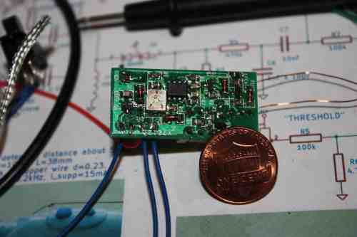

    Petrucho kindly sent me the artwork for his new pinpointer, the minimax-pp II a couple of weeks ago, the boards arrived just before the long easter weekend, so one evening I got to work, I think I need reading glasses soon , those smd components are so small you dare not sneeze
    After finding one bad solder joint it fired into life and results are surprisingly good, I'll do a video soon of mine, you can see Petrucho's on youtube:

        I try to build, but not found this components:
        BAV99
        DMN2075U
        MMBT4401
        I can replace them with another type?

            These components are not that much unique and there surely are equivalents. I found that IRLML2502TRPBF replaces DMN2075U
            Same goes for other components - just find what footprint and type is a component and google does the rest.

                  BAV99 - Petrucho says can be replaced by 2 serial connected 1n4148
                  DMN2075U - I used 2N7000
                  MMBT4401 - bipolar NPN, BC817 ?
