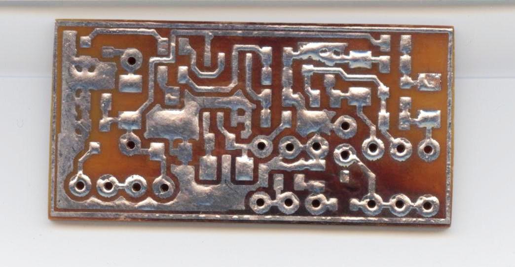

      BAV99 - Petrucho says can be replaced by 2 serial connected 1n4148
      DMN2075U - I used 2N7000
      MMBT4401 - bipolar NPN, BC817 ?
      Thanks silverdog,
      I found components on DigiKey , but shipping is expensive for small order
        pcb
        This is my PCB for minimax pinpointer.
        I'm missing some components to build it.
        Will try again!!
