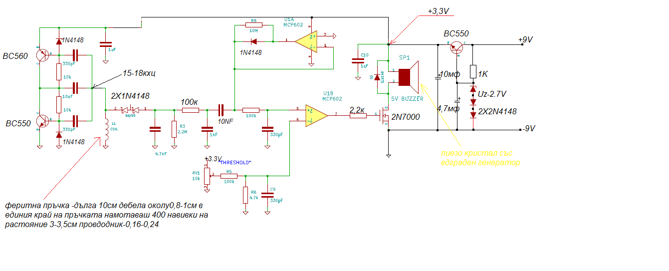

          If you are using a 9V battery, there is no need to put the stabilizer on 3.3V. Place the stabilizer on the 5V and will be more sensitive.
          The author used the scheme Petruchio Agricultural Labourers 3V and specifically made ​​to the scheme could work with two batteries of 1.5V.
          At 5V scheme works better. In this case, you can use IC LM062.

              Wire wound on a ferrite length of 10cm. The length of the winding 3-3.5cm
              400W , Wire 0.16-0.24.
              p.s. The Author recommended the use of circuit wire 0.3mm for better quality factor
                When you use a 5 volt stabilizer consumption rises tok.3 volts in less consumption and longer battery life

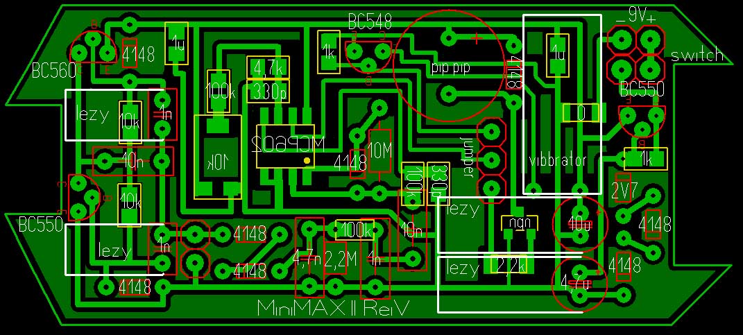

                      Hi to all!!
                      I have almost completed minimaxx smd, but I need mmbt4403 and 4401.
                      I am currently working on zombi version through hole.
                      I'll keep you informed
                      • #41

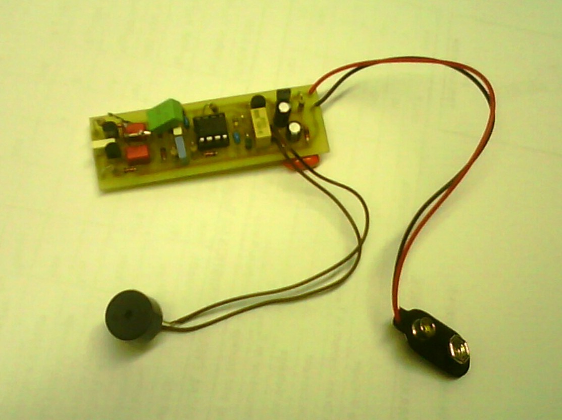

                        I finished the pinpointer zomby version, it works!
                        Also if the coil has not 400 turns (copper wire over to 330 turns) The sensing distance is very good, 5 cm above coin 10 euro cents
                        Tested on bench, now I have to find the box and try it in the ground.
                        Coil with 70 less turns may damage some components? I can leave coil under these conditions?
                        Thanks everyone for technical support!

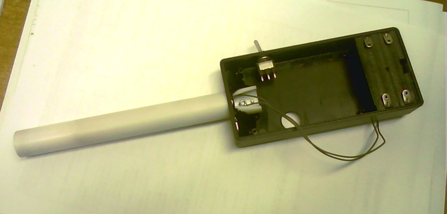

                          I finished box and tube coil for pinpointer zomby version, only a few welds, and it is ready for ground test!

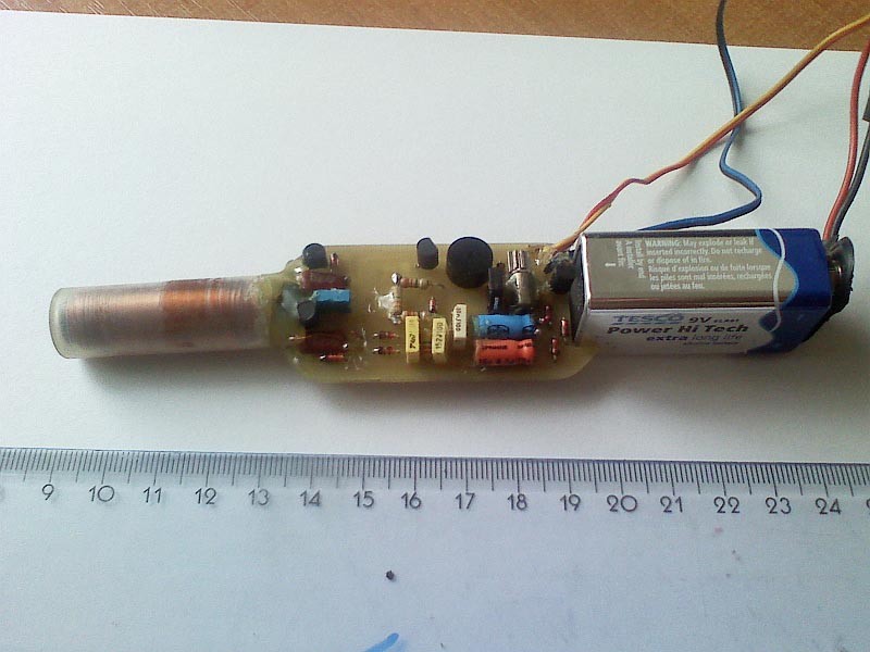

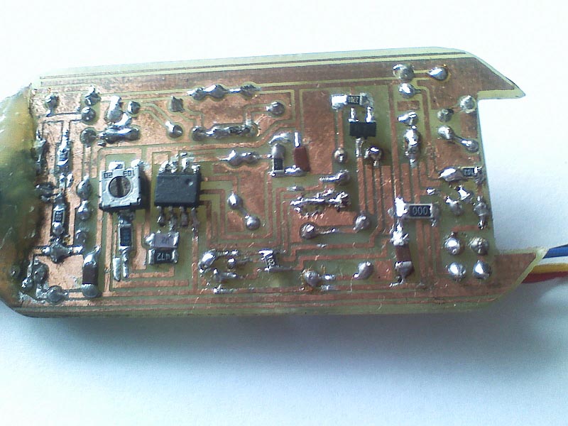

                            Hi this my variation of this PP, works very well
