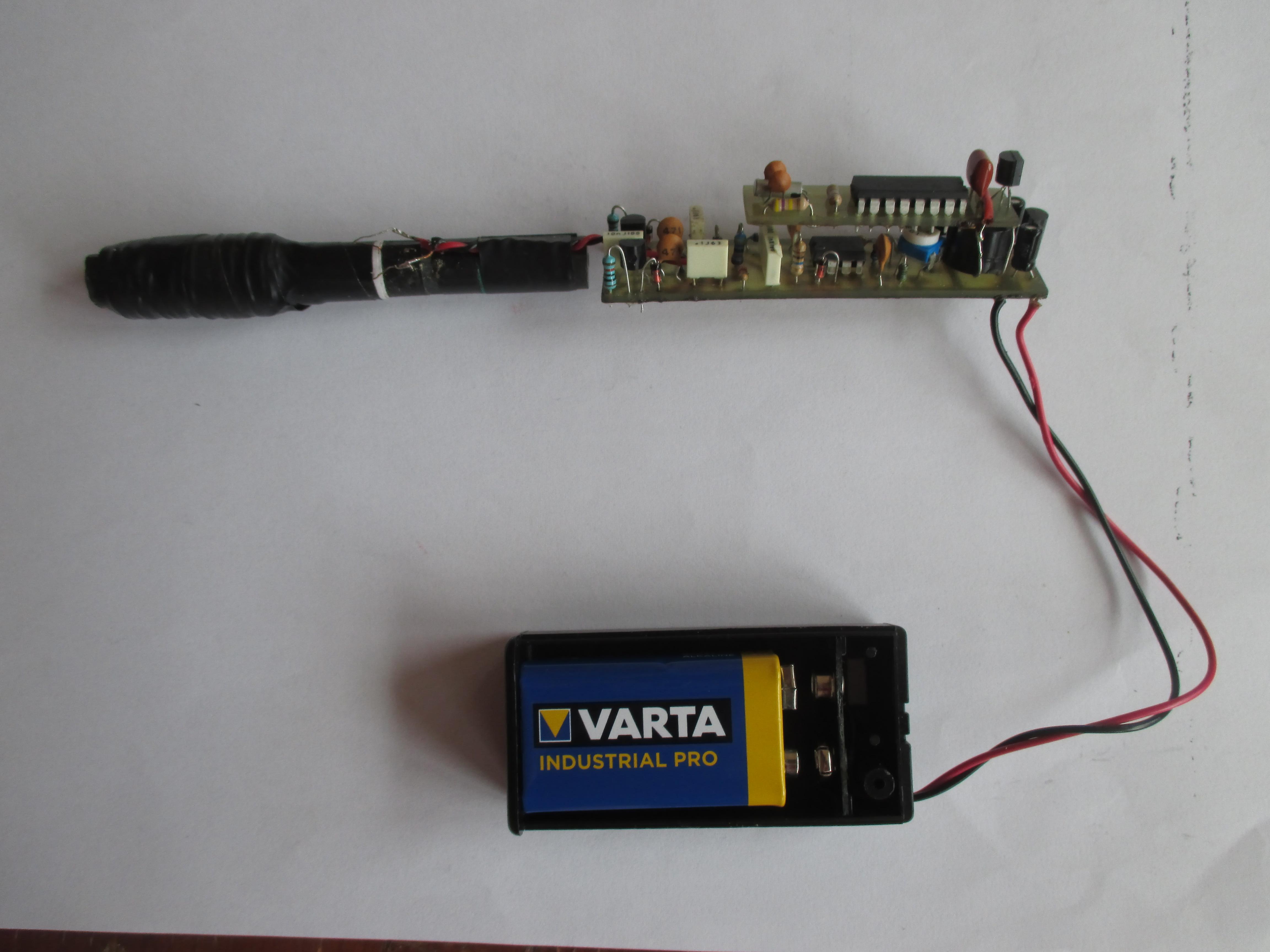

      Created my minimax, it works great except it gives false signals with moist soil and it was impossible to use in the field.
      Any idea to solve the false signals?

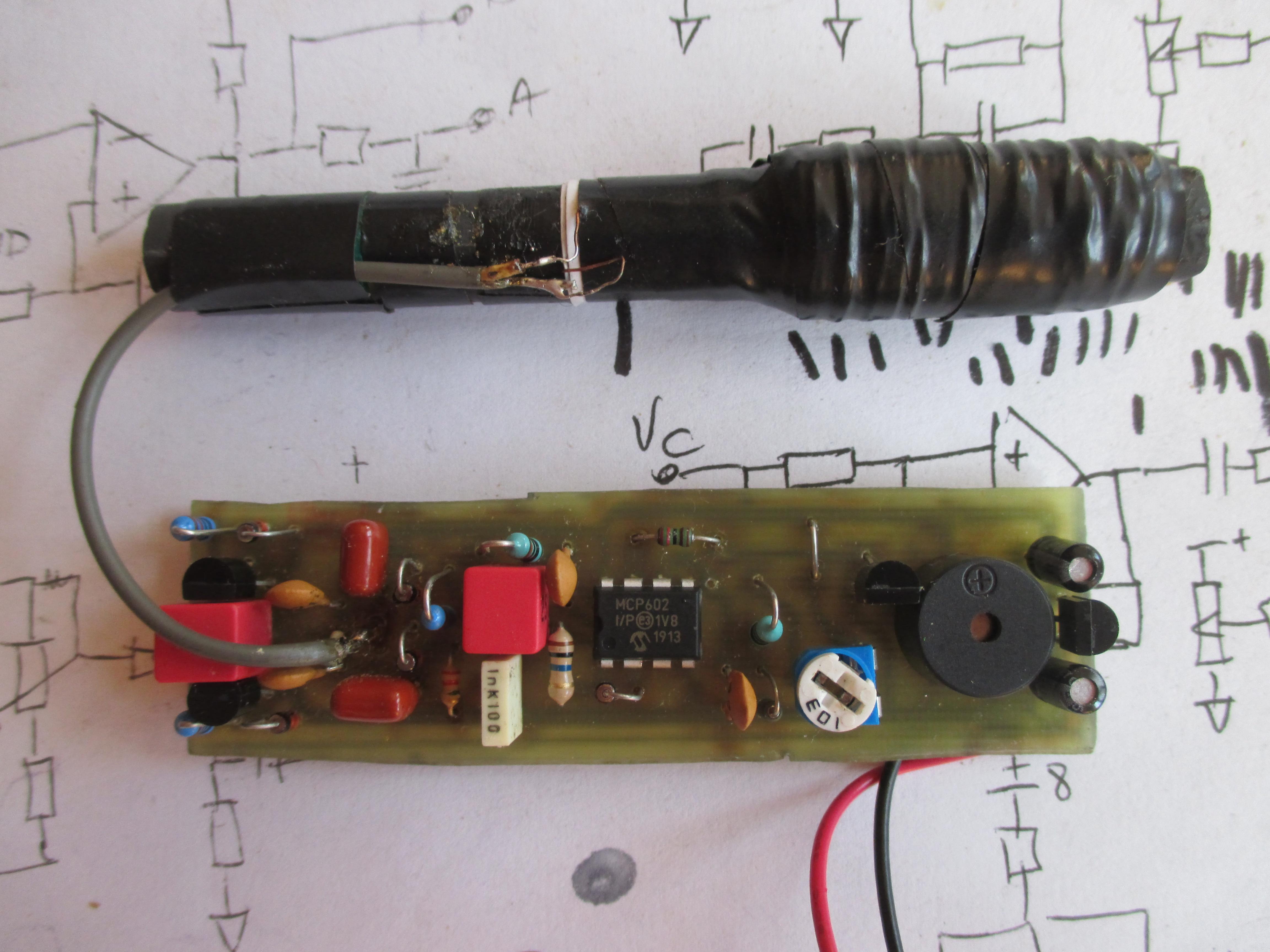

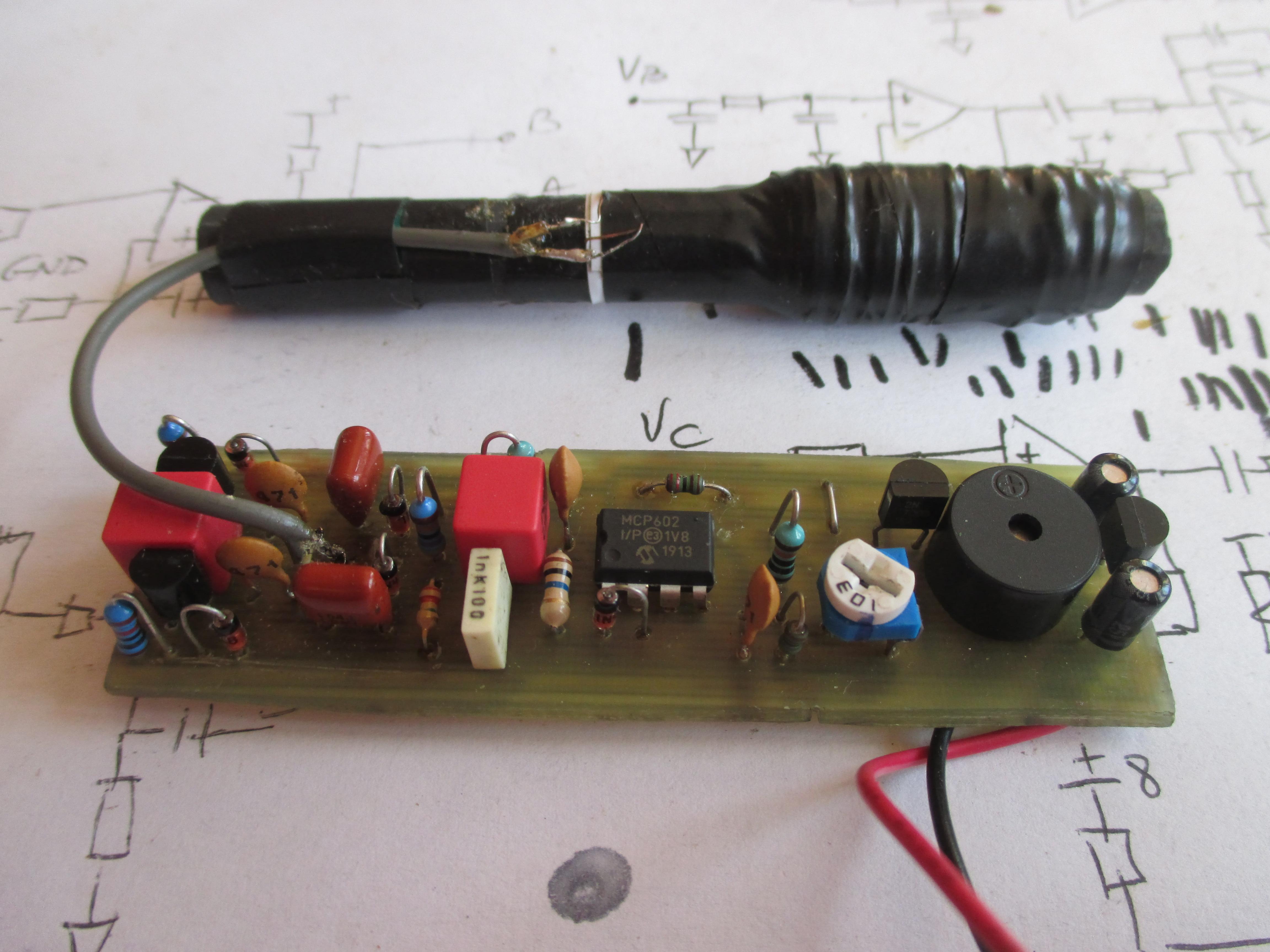

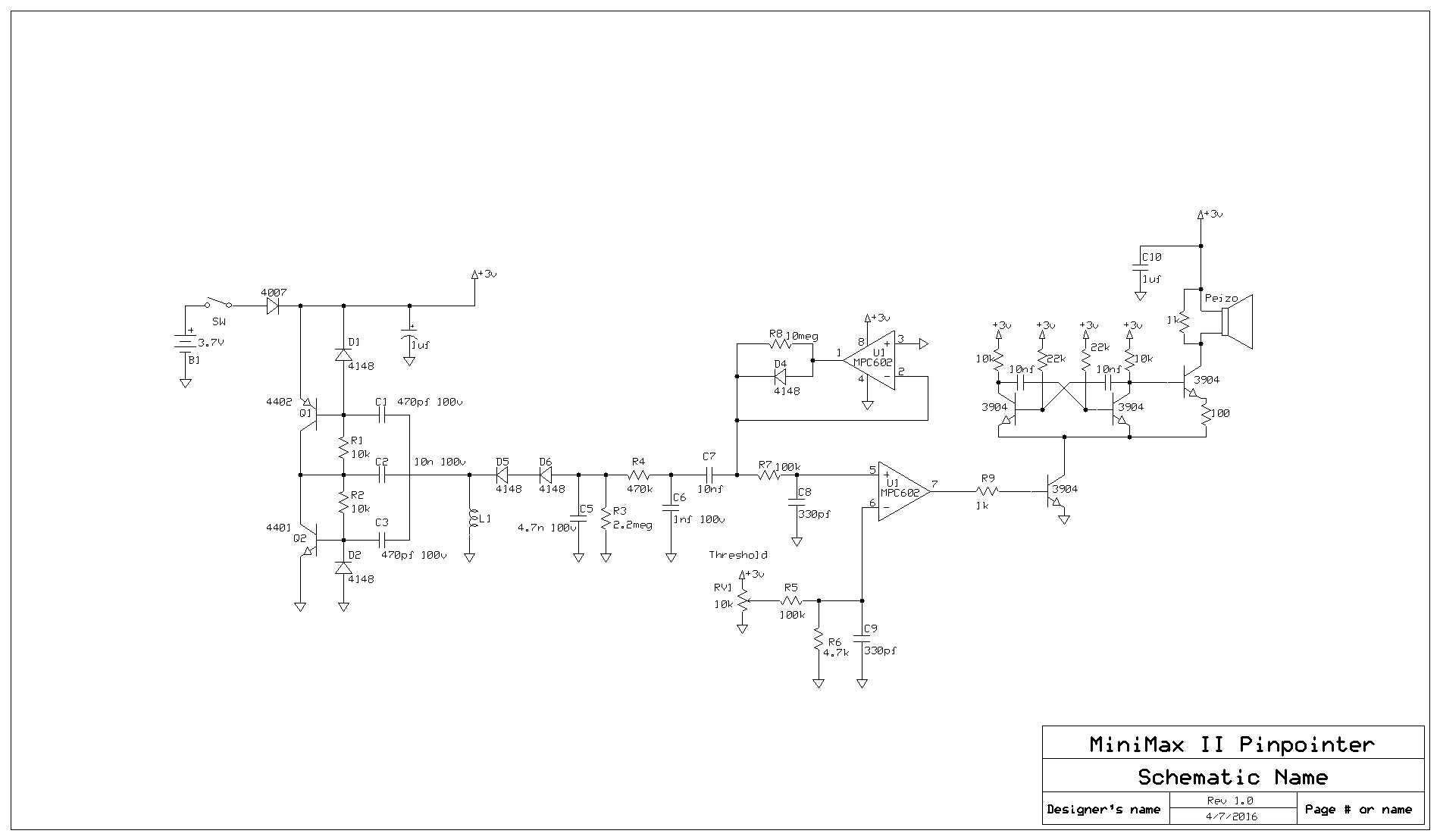

            I made this but didn't have a Peizo with oscillator inside so I modded the circuit a bit;
            My first coil using 31 AWG and around 500 turns made 120V P to P at 8.2 Khz. I unwound some
            wire and got 160V P to P at 9 Khz. So I rewound with 30 AWG. Now I get 15.5 Khz at 15.7 V.

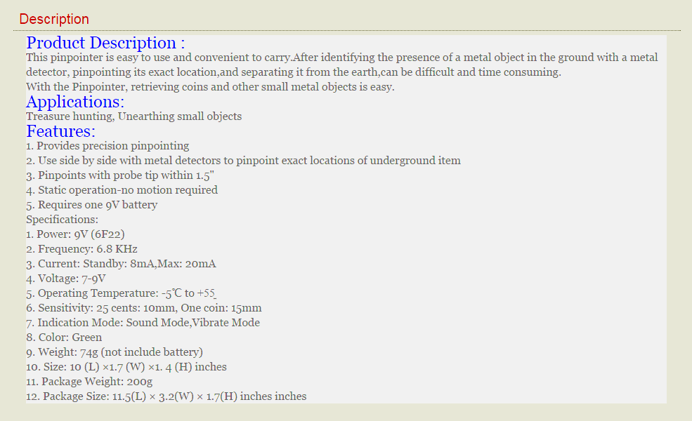

            The range is about 1". But I didn't realize it was a motion device.
            So I bought a Chinese designed one on Ebay for $25. Say's it's static mode but claims 1.5"
            range and then 10mm on Nickle and 25mm on quarter. Not sure if that's enough...

                    • #55

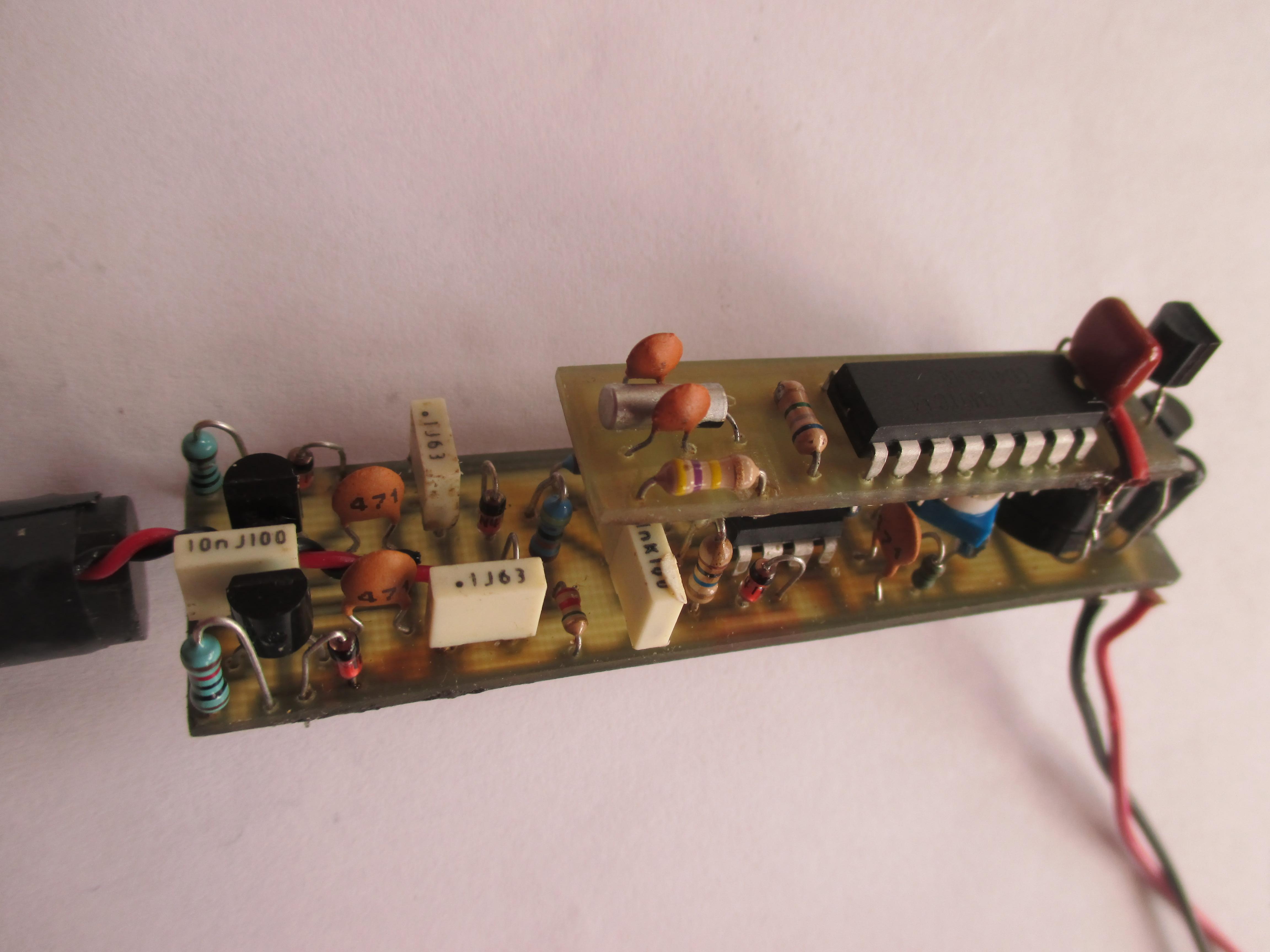

                      Really nice little project, works on first start.
                      I have made 2 versions, one with active piezo and another with a tone generator. The passive piezo is taken from my PC and it's driven with a CD4060+64kHz quartz oscillator generating 1kHz square wave for the BC547 transistor and that drives the piezo. The detection distance is about 4 centimeters for each circuit.
                      It is a very coil tolerant pinpointer, works with many ranges but with different sensibilities.
                      Here are my files and videos
                      https://youtu.be/wYtqIjXI6eI Original schematic.
                      https://youtu.be/OrosRtwkOho With the tone gerenator.
